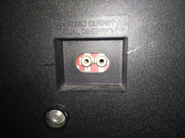

Hello,
I'm a bit of a novice when it comes to these old CRT's. Can someone explain to me what all these do exactly?
This one says " Audio Output Dual Dimension" I'd like to know if I can just connect standard RCA Audio Connectors to it or do I need a special connector?
This is the back panel of RCA FGR2020W / RCA Colortrak 2000
Can someone explain what all these do exactly? A/C Switch due? what adjusting the BIAS and Drive does? Service Switch does?
Thanks for any help.
Old 11-12-2022, 01:51 PM
The RCA jacks just plug into the AUX on a stereo. It probably had
fake stereo hence the name.
Cant quite read the others but at least 5 of them are related to setting the picture "gray scale" to get a good B&W pix.
You NEED a good B&W pix to get a good color pix !
If you can find a manual on line it will give the procedure.

The service switch collapse’s the vertical sweep. It is used to set up proper grey scale adjustments. Unless you have a manual and tv experience I would recommend leaving them alone. The audio out RCA are just standard RCA jacks. No special cable is needed.

AC stood for "automatic color". Sort of an auto tint and color intensity mode. I always left them turned off.
