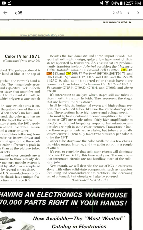

Posts: 787
The only reference to that model number I found was in a Feb 1971 Electronic World.
Pdf link
https://www.google.com/url?sa=t&sour...ciH1opfZsAUmzR
WAL at the end likely means walnut finish so I left it out and found that result.
