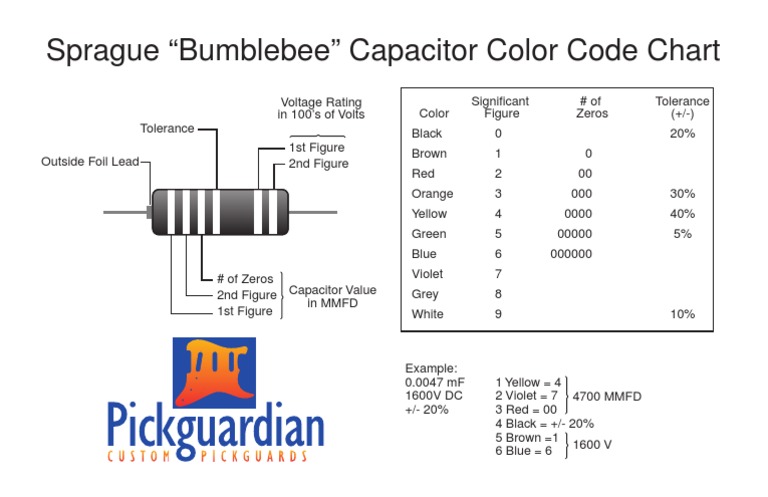

Alright I'll see what I can do. it doesn't help matters that some of the capacitors on the PC Board are of the "Bumblebee" Variety which means I'm gonna have to figure out what the stripe patterns mean on each of the capacitors. The rest of the capacitors have the value written on the case so I'll have no problems there.
Old 03-09-2016, 03:34 PM
Posts: 15,491
Ever see a modern replacement cap with a 3 digit value referenced to pF? For instance a 332k cap is 3300pF=.0033uF or a 104k cap is .1uF=10,000pF. Bumblebees use that same modern notation only the numbers are encoded in resistor color code (there are also usually extra bands for tolerance and voltage)....IMHO if you are using modern caps with that notation and know color code, bees are easier to change than other styles since you can read the number off the color code and then grab that number out of the replacement parts bin.

This might help:
https://imgv2-2-f.scribdassets.com/i...471/1455831005

Thanks for the link, that was very helpful.
