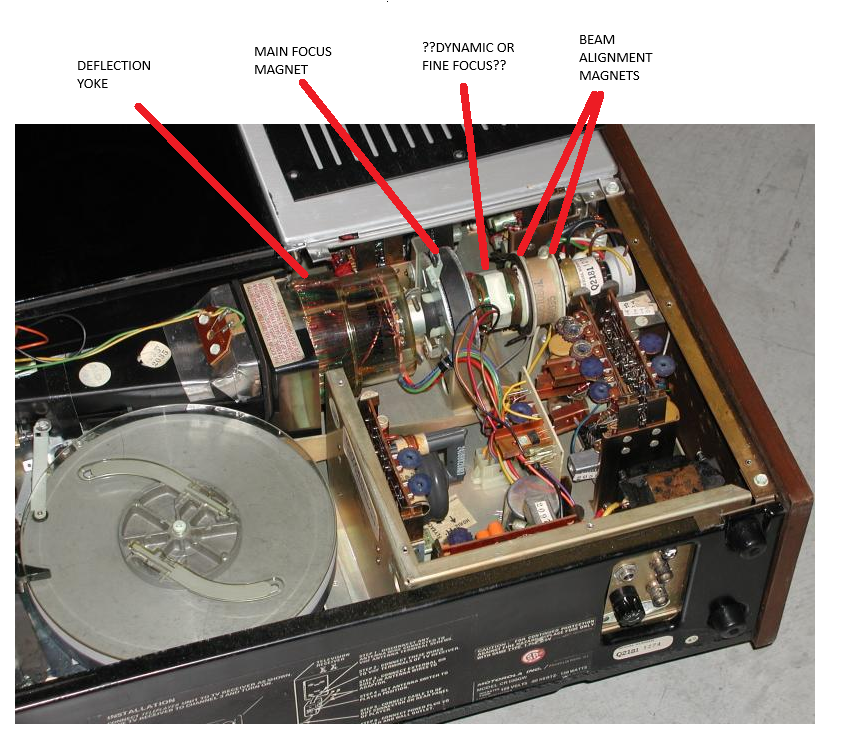

It is likely a flying spot tube from the ill-fated EVR Player. Motorola developed a fine-grain phosphor for it ca. 1970-1972.
It amazes me that any still exist.
http://www.bretl.com/EVRdocuments.htm

I just remembered - the EVR tube was magnetically focused, and also used beam alignment magnets. This was done to get an extremely fine, but still bright, spot.
So if this is an EVR tube, I'm afraid it won't work without those parts/circuits.
