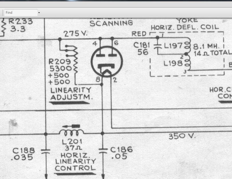

6300 ohm resistor
Anyone have a 630ts, or clone of, parts chassis? I need the large 4", 6300 ohm
resistor found in the HV cage.
PM me.
thanks

Unless someone has one used to offer, the part is pretty much unobtainium.
You may try to make one via 3 power resistors 50w 5.3k +500 + 500, but the 5.3k in large sizes seem to be hard to find, closest I have found so far, is 5.6k, this may be close enough in this case.
HSA505K6J
THS50500RJ

Better yet use an adjustable one like this: https://www.mouser.com/ProductDetail...x9RYYOLg%3D%3D

https://www.elliottelectronicsupply....-rw35v632.html
Old 05-10-2023, 10:59 PM
Posts: 8,829
Nice find. The original does have a couple taps though. I believe for adjusting width or linearity.
Old 05-10-2023, 11:00 PM
Posts: 3,246
Originally Posted by mrjukebox160 View Post
this one is incorrect
because it needs to have taps at 5.3k &500 &500 but the over all resistance is 6300.
http://suzaku.live-evil.org/lin-adj.jpg

Thanks to MRjukebox160.
Perfect replacement as I need the full 6300..............
Mallory #RW35v632
Old 05-11-2023, 07:51 AM
Posts: 3,246
IMHO, it would be unwise to use a fixed value for that resistor, as you would lose the ability to adjust horizontal linearity, for example, my FADA 895 has it tied to one of the center taps.
