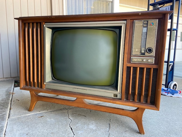

A Zenith color decided to follow me home, hoping to avoid being upcycled. It's a remote model with power tuning. I managed to massage the set into fairly decent working order, temporarily, with the exception of the tuner motor which had a broken gear, and lack of fine tuning, which for some reason won't engage. (Will need to pull the tuner to try to address this)
Sam's
https://drive.google.com/file/d/1Bpq...ew?usp=sharing

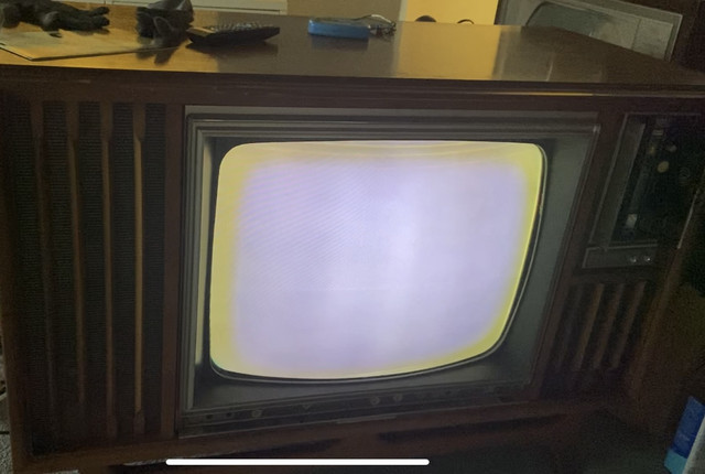

The color was always slow to come on, and after a couple days of running, I noticed the color not able anymore to achieve sync. I decided to try to finesse the chroma bandpass (A24), and while doing so, the pic started to drop out and I was left with very dark patchy video. Retrace lines were also visible.
I tested all of the video, agc/sync and tuner tubes. Tested the Chroma, R-Y and R-B tubes.All were ok. Video amp transistor tested fine.
Video detector and all other signal diodes tested fine. Source voltages and electrolytics test ok. Tested all resistors around all tubes concerned and all were within spec. Certainly no burnt or open resistors.
After turning the set off and on, all that we have now is a blank raster. RF, IF and composite video does not get through. I've been banging my head trying to find the cause of this weird condition. I haven't dealt with a more complicated problem and I'm hoping a veteran can help point out something obvious I may have missed.

Start with the blank white screen. Most likely IF problem. Now we
use the built in signal ( noise) injector........
Turn channels. If you see & hear crashes of the tuner switches its the tuner.
If you dont then its IF problem.
You can do the same with the IF. While running take out then put the
IF tubes back in. Watch for crashes as above. 1 IF, 2 IF, 3 IF its a chain.
The pix with retrace has color info but not video. Trace the video amps & out.

The 3rd picture from the top shows the set having lost the luma (video) signal, with the chroma signal still present. The two most frequent causes are:
1. Dirty service switch. Try working the service switch and giving it a shot of Deoxit or similar.
2. Heater-cathode short in the CRT. Try rapping on the neck (not too hard) while watching the screen with a mirror.

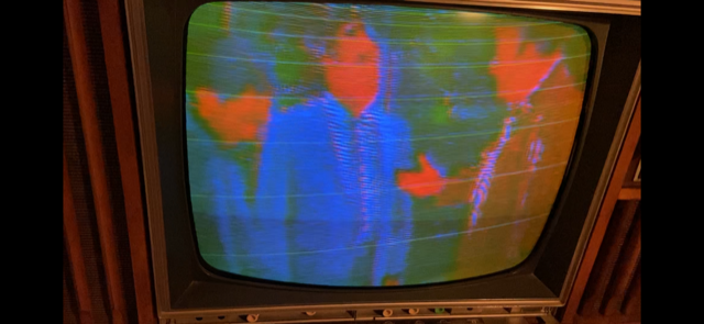

OK, update. Discovered that 2 of my IF tubes 1, 2 were oriented wrong. This is easy to do when there are no keys in the socket. Voltages on all IFs are reasonably acceptable now. Voltages on the Video out seem ok. Whether I put RF on the antenna terminals or inject an IF or composite signal, I get the same result; sound, plus a very faint image and moving horizontal lines corresponding to video information.
Video output tube, V5 tests normal on 2 testers.
Checking CRT pin voltages, these appear to be normal and within a reasonable range.
Here's what we are currently looking like:
https://www.youtube.com/watch?v=MXUI...l=Silvertone58

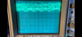

Composite waveform into V5, pin 2
Composite waveform out of V5, pin 7
We can see hardly any signal is leaving the tube, even though there's around 310v on that pin.

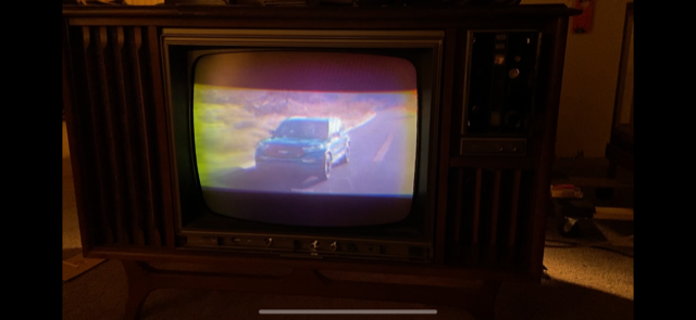

Another update, and I believe I've solved the mystery. My hunch was correct about V4A, the cathode follower. Waveforms confirmed that that tube section was not conducting sufficiently. Swapping it with V10, appears to have resolved the trouble. This tube tested ok on 2 testers, by the way!
In position at V10, the same problem tube isn't problematic here, apparently because of how it functions differently with the color killer.
Replacing the stock Vid Amp transistor, Q1 with a modern 2N222 and and vid detector with a fresh 1N60 also livened things up a bit.
This is the first set that I've operated on that has a cathode follower. My understanding is that this section provides impedance matching for the delay line (?)
The only truly defective part was the broken degauss thermistor, which I replaced with a NOS one.
