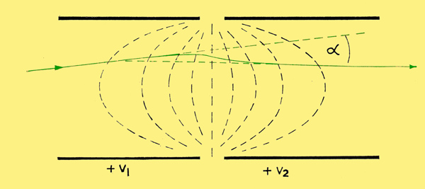

I spent a few hours reading research papers, articles, and patents on electrostatic lensing and especially on Einzel lenses (commonly referred to as low voltage focus) and bi-potential lenses (commonly referred to as high voltage focus).
First, the National Valve museum has scanned a great series of articles from 1950s thru 1960s that explain the basic nature of electrostatic lensing. The physical phenomenon is explained in this figure which shows the cross section of two conductors shaped as hollow cylinders with a vacuum gap between the two cylinders:
Whenever two cylinders are arranged in this manner and the difference in voltage between the two is non-zero, an electrostatic field is created as depicted by the equipotential lines. The lens is formed in the gap between the two cylinders, and its effect on the path of a cathode ray (green line) is analogous to the effect that a glass lens has on the path of a ray of light. The power of the lens corresponds to the magnitude of the difference in the voltage of the two adjacent cylinders.
This patent from Intel has a great one page introduction on different CRT focusing designs. It also describes how to use the G1 anode as an iris:
The biasing grid effectively forms an iris, which the beam passes through. This iris can be opened or closed by varying the voltage on the biasing grid.
If the biasing Voltage is brought closer to the cathode Voltage then the cathode's active emitting surface becomes larger in diameter. This active area serves as the object in the total optical System. While this voltage change allows more current to escape from the cathode it increases the object size for the optical System.
The patent goes on to describe a standard low voltage Einzel lens using the following diagram. Cylinder 20 in the figure is what televisions connect to the "focus" voltage. Cylinders 16 and 22 are connected via jumper 24 so they both have the same voltage, and they are then connected to the ultor anode using snubber springs 30. The gap between cylinder 16 and 20 forms a lens, and the gap between cylinder 20 and 22 also forms an identical power and shaped lens.
This brings me back to the goal of maximizing the sharpness of the GE Portacolor. According to Einzel lens theory, the following DC bias settings will create the smallest iris opening and maximize the power of each electrostatic lens:

I applied the previously mentioned steps, which are based on the theory of using G1 minus cathode voltage as an iris, by maxing cathode DC bias, and minimizing G1 DC bias. Focus voltage is zero, and G2 DC bias is maxed out. I had to slightly increase the DC bias of G1 to get black levels calibrated and to keep the moire effect from being overly noticeable.
With a low voltage focus CRT, the lower the focus anode voltage, the more the cathode ray is squeezed into a thinner beam of electrons, as the negatively charged anode repels the negatively charged electrons. A high voltage focus CRT is a bit different in that it accelarates the electrons towards the center of the beam and forward towards the phosphor screen.
As you can see in the first picture, which is a test pattern of 240 alternating white and black horizontal lines. Before the tuning, the adjacent horizontal lines blurred together, making it impossible to distinguish between alternating lines. Now there is enough separation to be able to distinguish every line. The white lines are still too thick compared to the black lines, but if the cathode ray is made thinner, the moire effect becomes terrible.
This color bars pattern shows a subtle moire effect caused by the cathode ray’s spot size becoming too small relative to the phosphor mask dot pitch. If you zoom in to the horizontal white and black lines test pattern above, the white lines are one line of video, so the vertical thickness of the white line is the cathode ray spot size’s diameter. You can see that the spot size is just about 1.5x the dot pitch. This is why moire effect is becoming noticeable.
