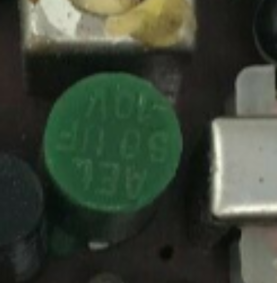

Those ones in the late 60's early 70's Sanyo portables are horrible. I think the were Elna brand (Grey heat shrink label and look like electrolytics). Whatever they are they are all as leaky as wax paper from the 50's.
I was given a bunch of Pyramids with a yellow rubber cover on them and out of 50 or so I've tested they all checked out good.
Also to add to the list of lousy capacitors are these plastic cased electrolyitics.
