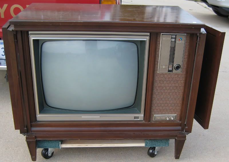

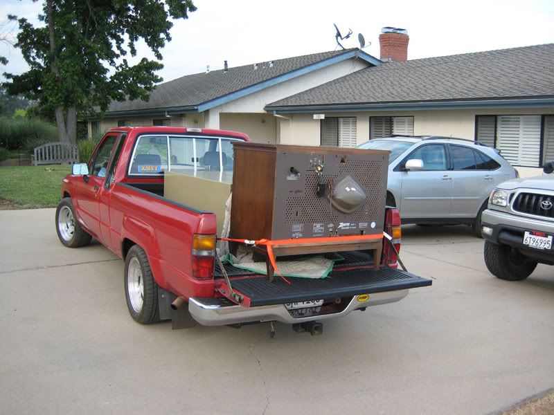

Today I got a call from another TV collector here in the LA area, who found this nice high-end Zenith at a garage sale in Encino, and also a Motorola 23" combo (in another thread)... He has no room for any more sets since he has about 400 (I won't say the name, but most locals know who I'm talking about ) So he offered the lead to me, and I happened to be in the Valley after a brunch that Kay and I went to. So I made a deal with Kay: She gets to go shopping at Old Navy, and I get to go to a garage sale to look at an old TV
I went and met the other collector at the sale, and I got the Zenith for $15. The remote is missing, but other than that, it's a very nice set! I have a spare Space Command 600 for it, so I'm in business. I haven't Variac'ed it up yet, but the seller said his Dad used it up til the 90s when they got a big screen. I believe it because it has some Phillips-ECG tubes in it. And the CRT was replaced in the 80s with a local rebuilt.
More details when I get a chance to check it out!

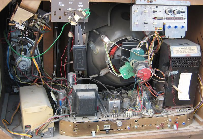

Charles, Great save looks like you need a convergence coil or two. I always liked changing the HOT in a dark room on those sets and my back remembers them too that's not a lite weight set. There were a lot of them in Orange County in the late 70's

It does have at least one unwound coil. I hope I can carefully rewind it, as I've sometimes been able to do before. I used to have boxes and boxes of Zenith coils, but they all had to go on eBay for lack of space.

Nice truck!! Is that Zenith a '67 with the 20X1C38 chassis or thereabouts? If so, that thing will outlast all of us! Nice save!!

Nice save! Yours must be a '67 with what appears to be a 23XC36 or 38 chassis? I have this same exact set but with the 25MC46 chassis which has the huge post deflection purity magnets. What model number is this one? Didnt know they made this model with a different chassis.

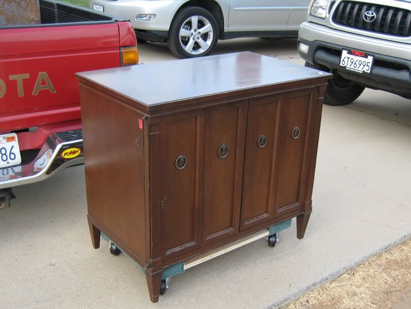

That is a very nice set. The Itallian Provincial style cabinet looks in good cosmetic condition.

I Variac'ed the Zenith (it's a 23XC36 chassis), and it came to life! It has it's problems, but basically it seems totally repairable. CRT is strong with great gray scale, and I got a picture. No color, and a bad horizontal blanking problem. So I will have to do some recapping, then likely troubleshoot the color circuits. I remember seeing weird problems in these chasses with the 3.58 oscillator transformer. I'll get into it soon, and will post more.
