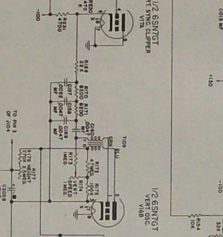

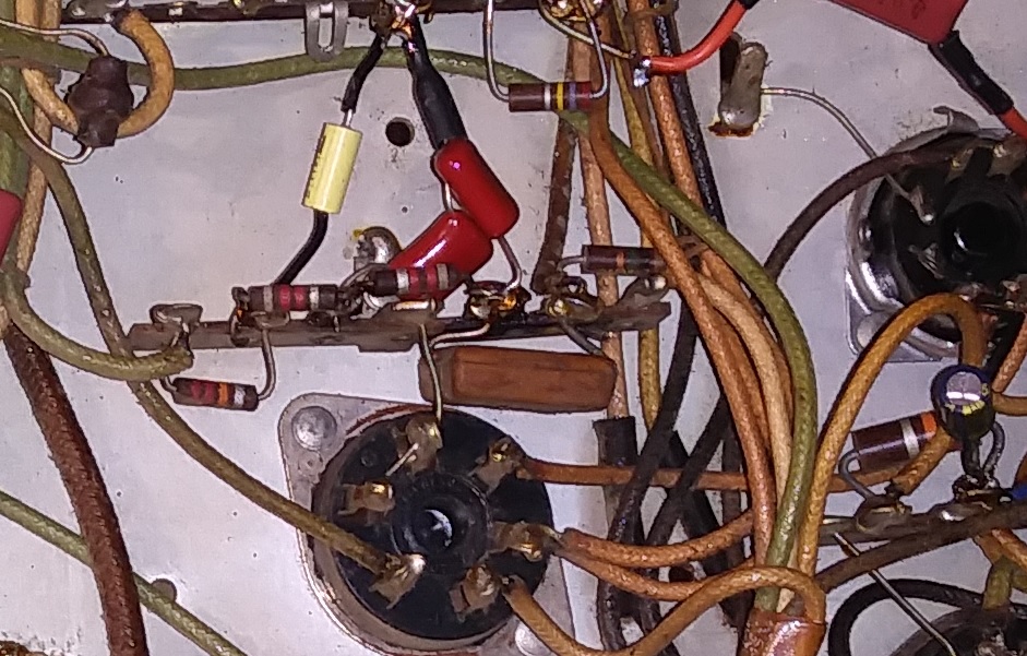

Old Yesterday, 08:25 PM
Posts: 3,237
The vertical bug on the set still is nagging me, it works, but not as well as it could. I guess I missed something.
Not sure it I got all the resistors or not.
I think I replaced these, or SOME of these.
http://suzaku.live-evil.org/vertical...or circuit.jpg
http://suzaku.live-evil.org/vertical...circuit-ss.jpg
That mica was replaced, with a film cap.
Next time I have the chassis out, I will make sure to replace ALL those resistors with new film types, and put in better caps NP0 types, and a Mica one where the .0047 was before, and perhaps I wont take 5-10 min before it's stable.
