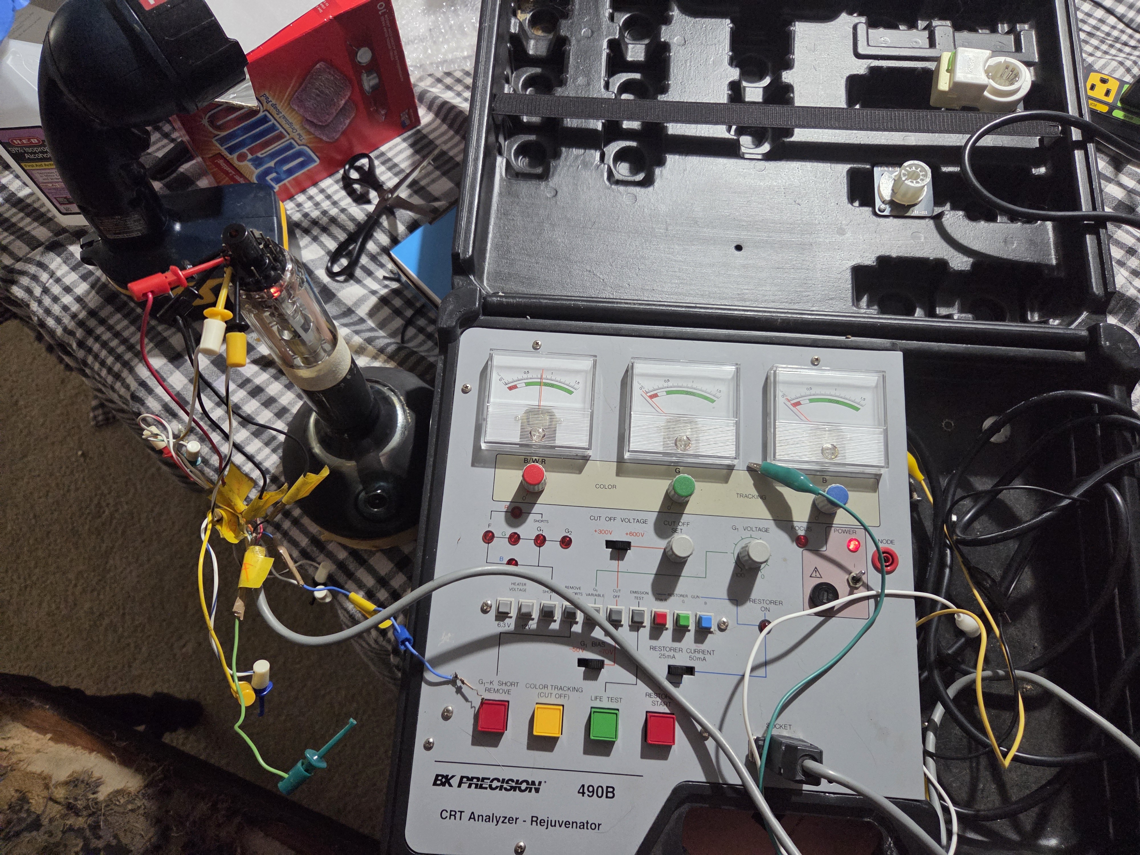

Well, the CRT from the unit with the damaged yoke IS good, or has good emissions.
http://suzaku.live-evil.org/20260924_184736.jpg
Took a bit to work out how to test it, as it has 14 pins, not 12, like shown in the docs.

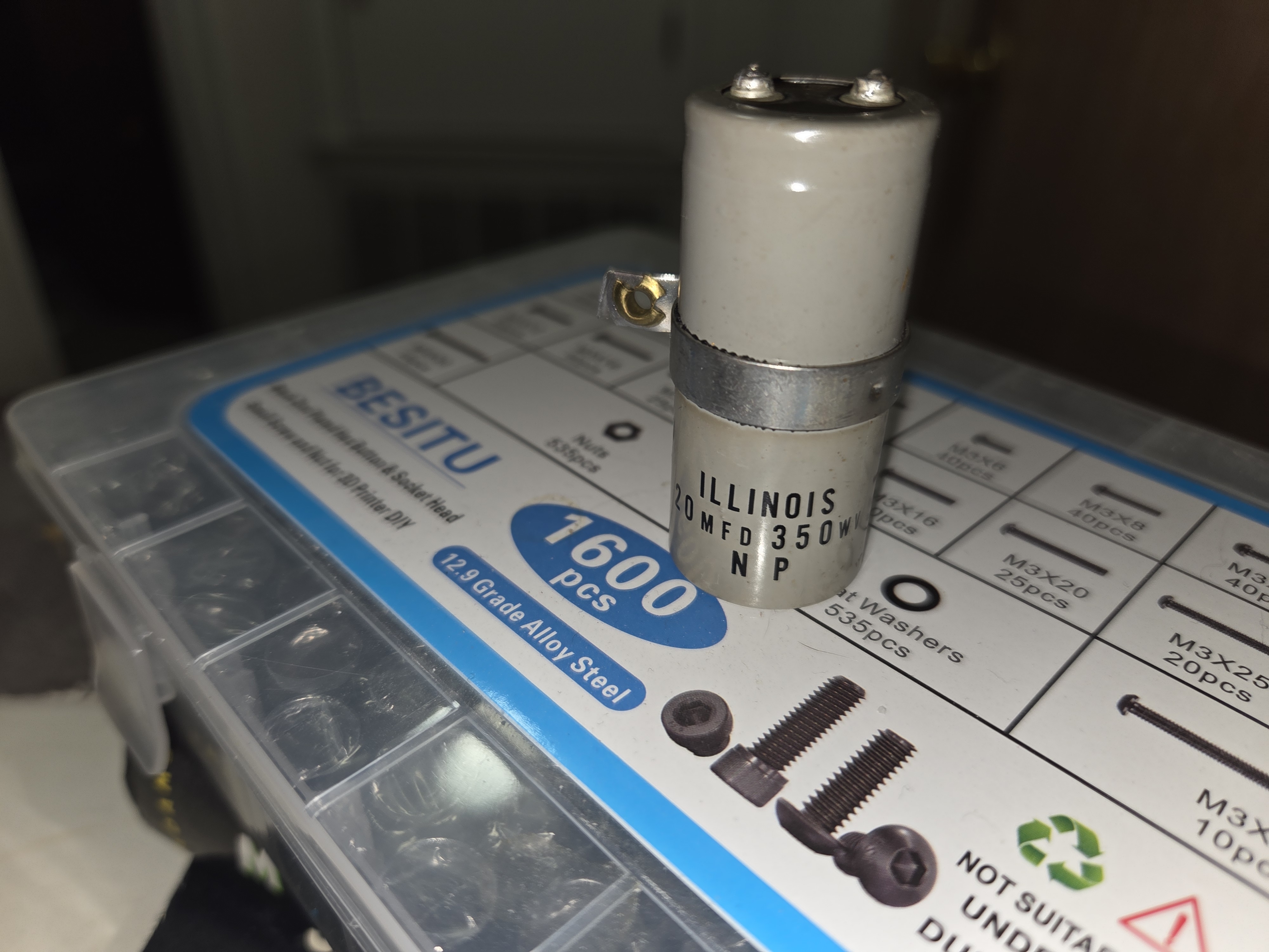

I did not order the NP 20 uf cap on the video output on the thing, and it's REALLY bad, leaky, put a temp smaller film cap in for testing.
http://suzaku.live-evil.org/20260929_205605.jpg
ordered a 22uf film cap 450v
Old 09-30-2026, 08:01 PM
Posts: 3,255
The bad, very leaky cap that cause there to be over 120V dc on the video output terminals of the unit.
http://suzaku.live-evil.org/20260930_195456.jpg
And the replacement that's on the way.
https://www.mouser.com/en/ProductDet...rrencyCode=USD
One Illinois-Capacitor out, and one in!

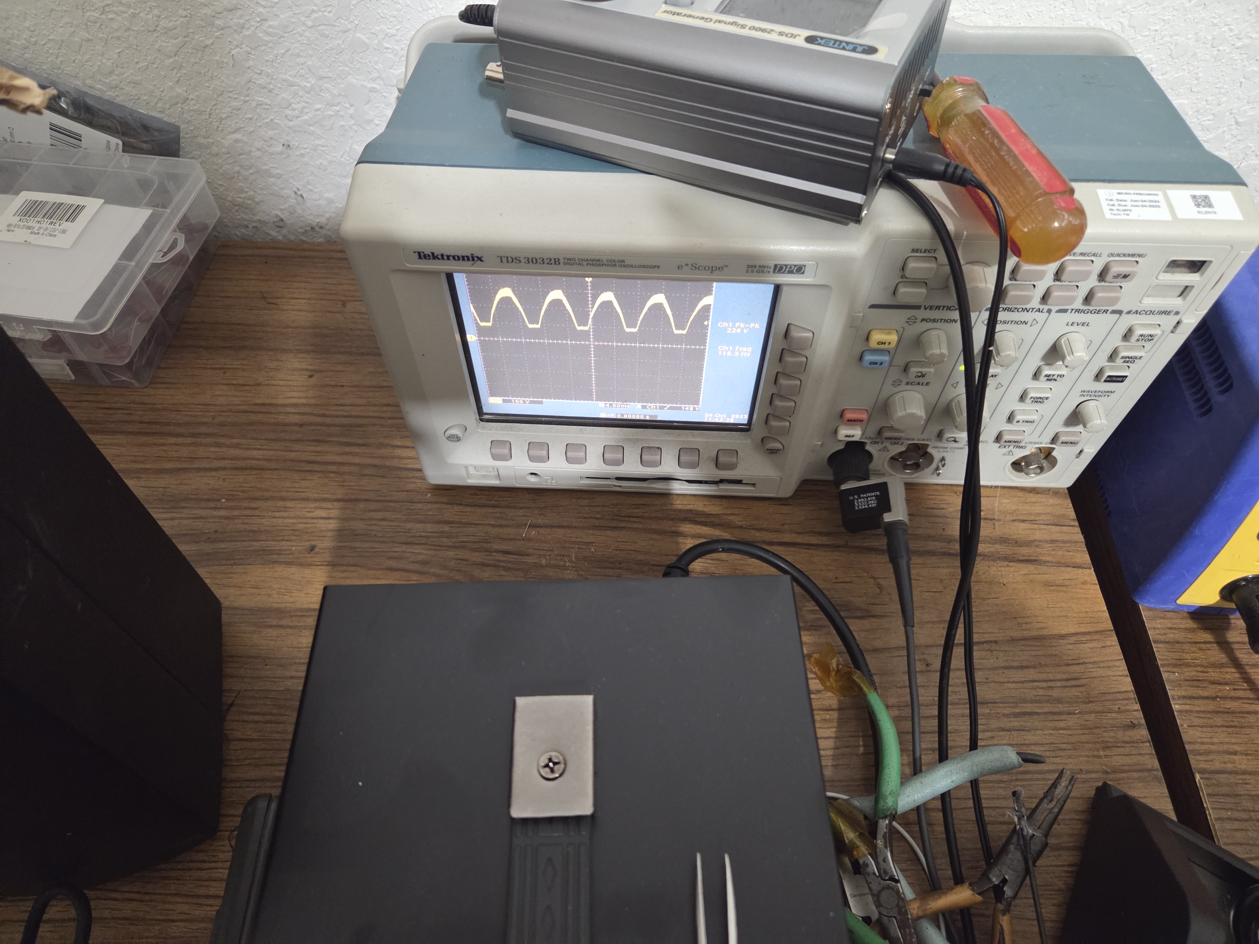

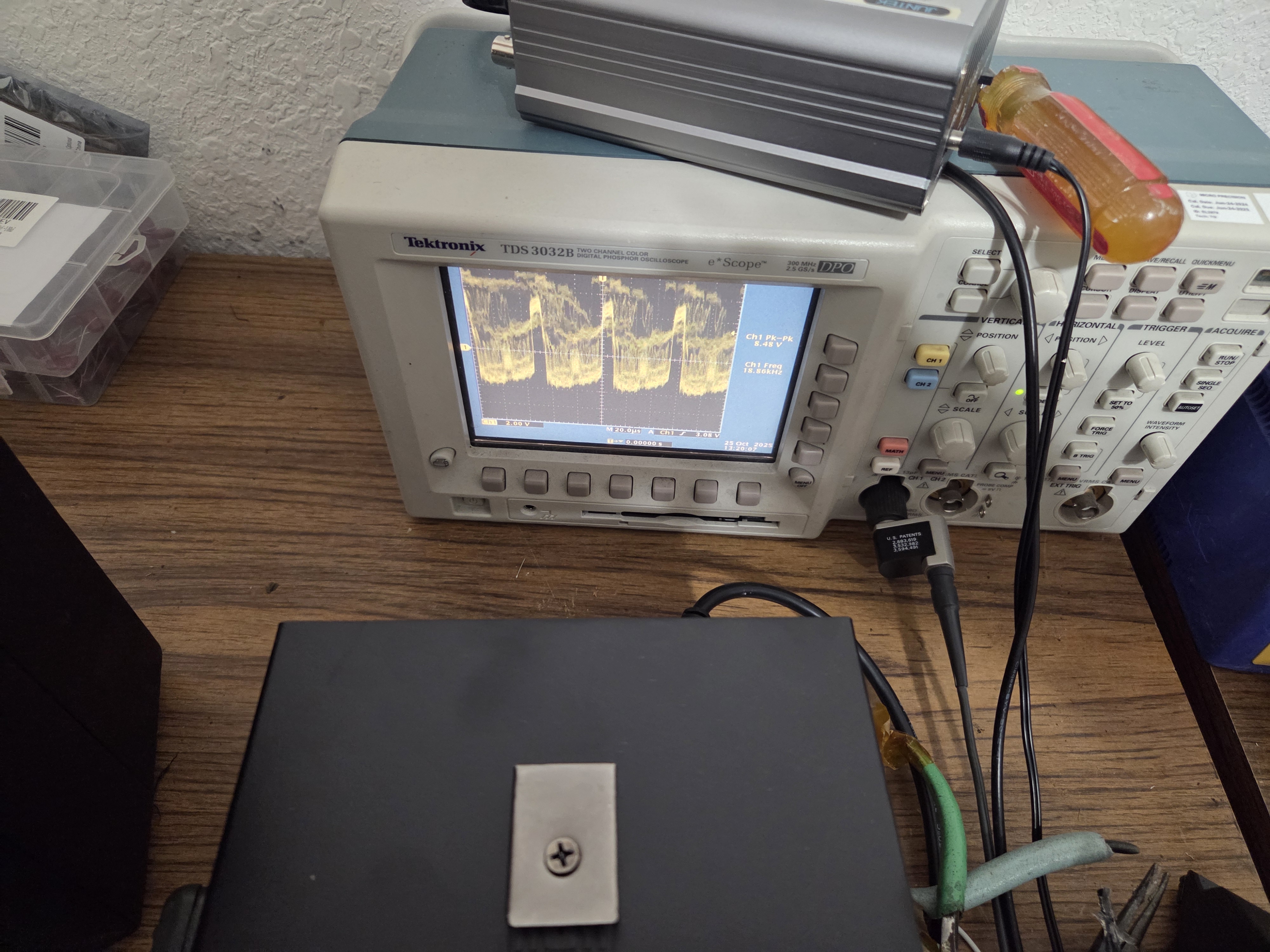

That 18.86 khz seems a tad bit high, but I'm not sure if the O-scope is reading it right yet, will see when the right output cap is in it, but there does seem to be a way to Adjust the freq.
Old 10-02-2026, 05:01 PM
Posts: 15,496
If you have a regular sinewave generator you could adjust it to repeat at the same rate as the horizontal does and measure the frequency of the sinewave.... Alternatively you could measure the number of scope grid divisions between sync pulses on a modern stable composite video source (like a DVD player) then adjust the B&K so it matcjes.

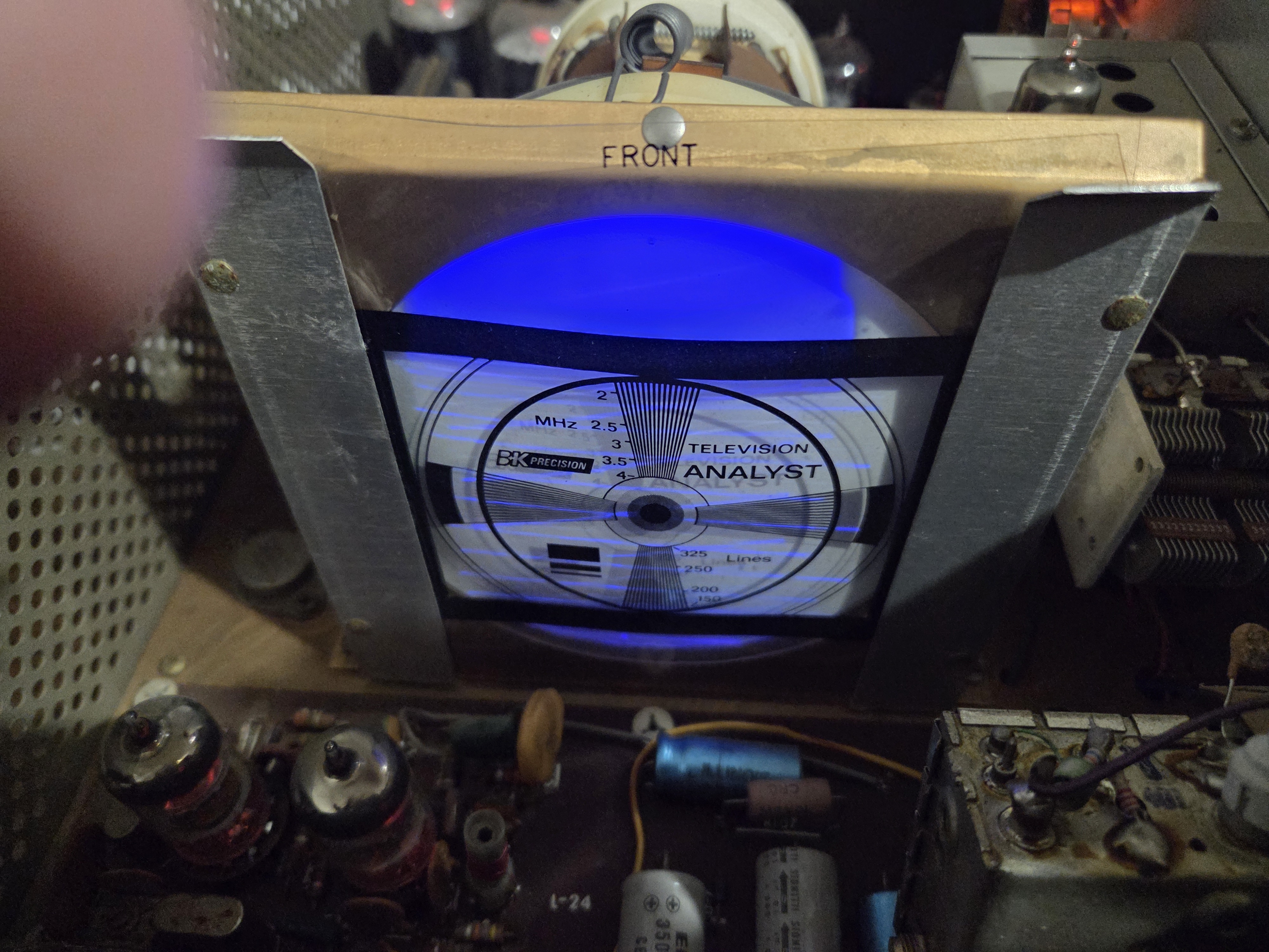

It's alive!
http://suzaku.live-evil.org/20261002_184808.jpg
Still needs some work, perhaps some new tubes. they are all old original.
but it works!

The yoke is crooked for some reason, and I still have to change the caps on the scanning PCB, but It's working, as I'm waiting for newer tubes.
the color bars don't always work for some reason.

I think there was supposed to be a transparency with black stripes for the spaces between the colors and gray stripes corresponding to the colors to give them a *little* luminance (not full white like the Indian head background).
Old 10-07-2026, 08:55 AM
Posts: 3,255
Nice!
Correct, but you have a better chance of finding grass growing on the Moon than any full set of inserts for the unit, unfortunately, they are always the first to be lost, I only have the one shown, and the dot pattern for static convergence.
