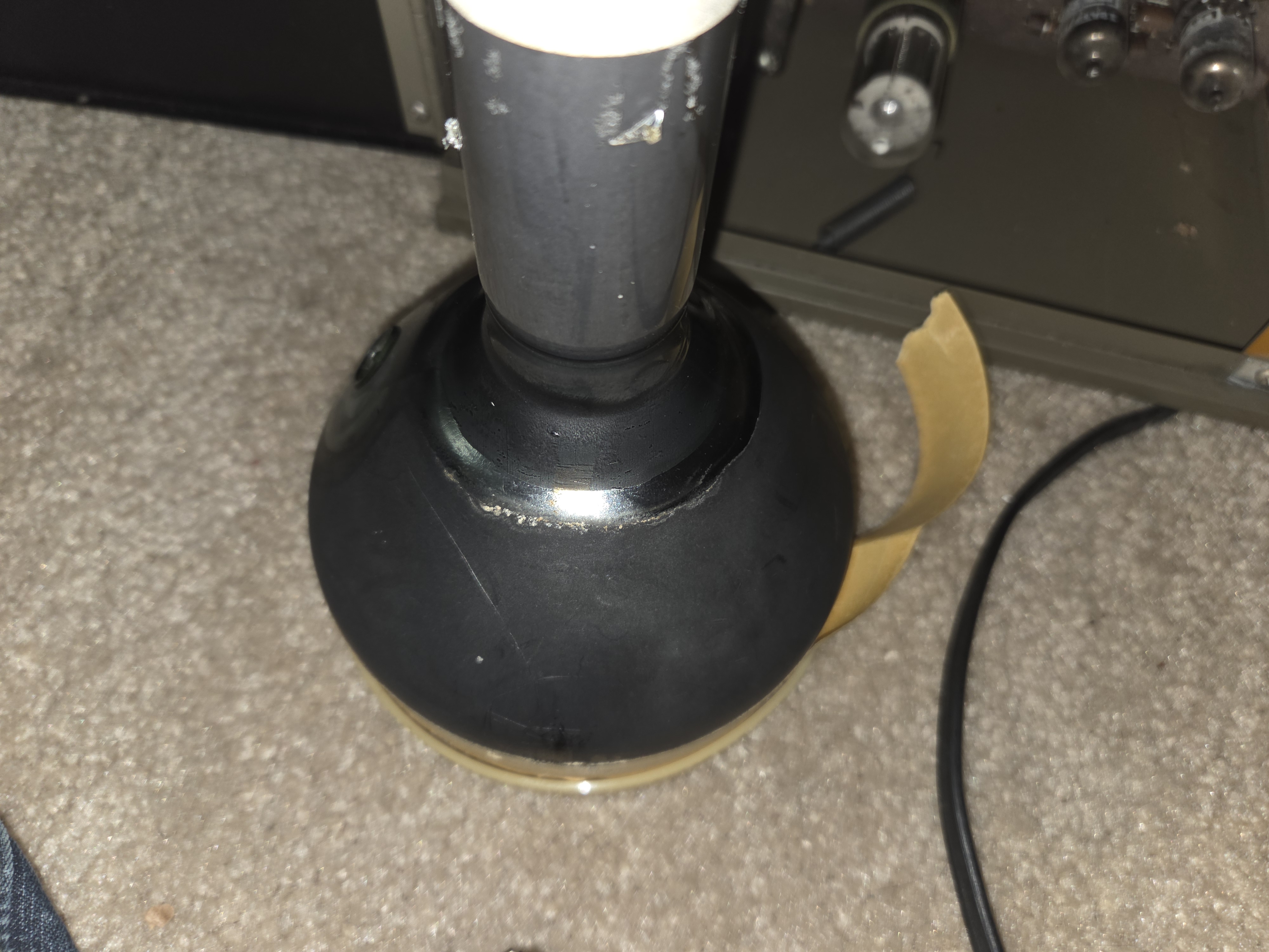

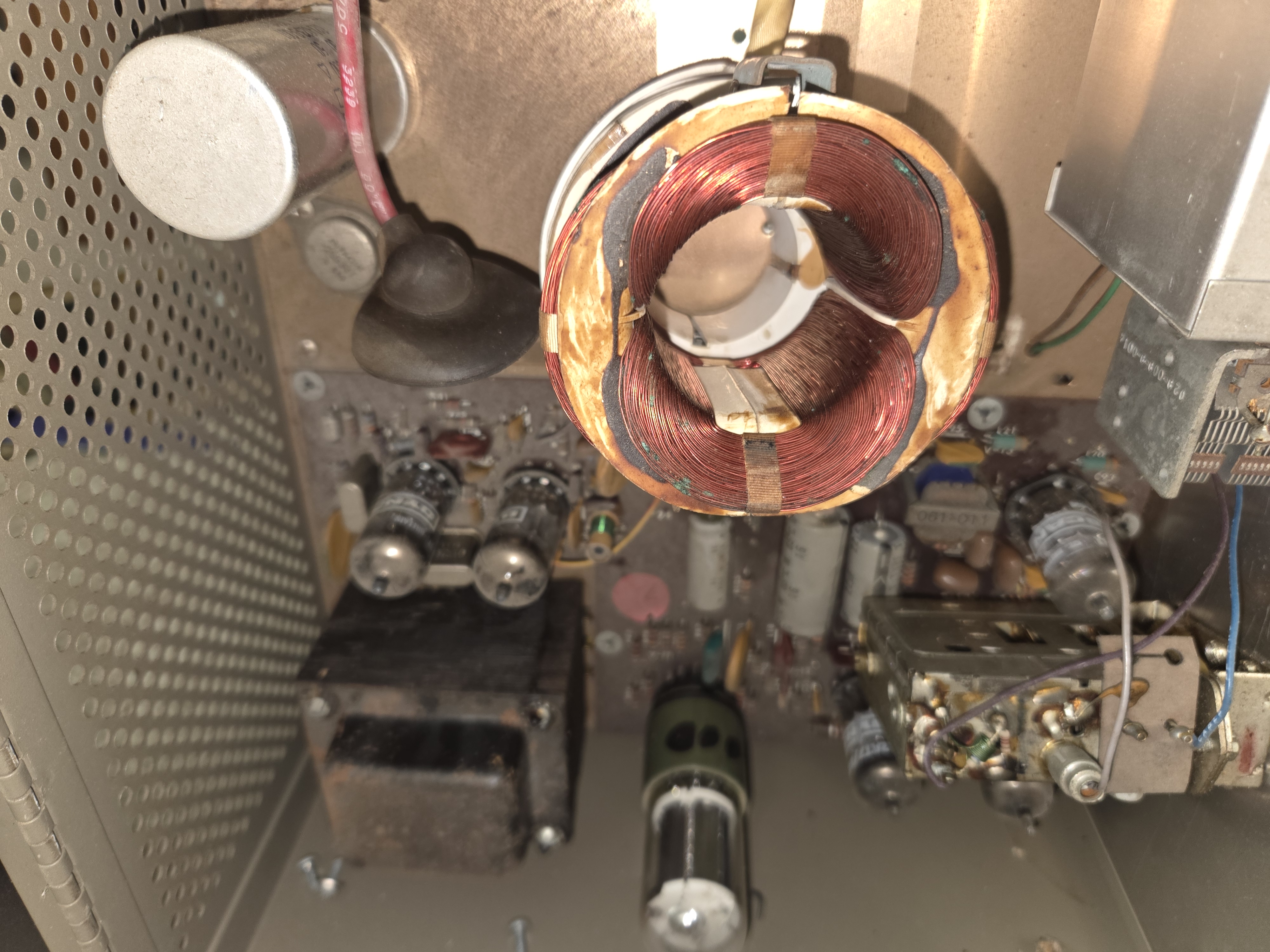

This one HAS the missing part, and 2 templates, but said was unsafe to use as it was "smoking",I spotted something odd in the picture.
It came today.
I was correct, I did spot something..
http://suzaku.live-evil.org/20260923_203627.jpg
SMOKE source.
did not even have to plug it in.
http://suzaku.live-evil.org/20260923_203644.jpg
Not even sure if this CRT is good or bad, It's an odd type, not sure how to test it, does not match the schematic.

Well, the CRT from the unit with the damaged yoke IS good, or has good emissions.
http://suzaku.live-evil.org/20260924_184736.jpg
Took a bit to work out how to test it, as it has 14 pins, not 12, like shown in the docs.

The yoke is crooked for some reason, and I still have to change the caps on the scanning PCB, but It's working, as I'm waiting for newer tubes.
the color bars don't always work for some reason.
