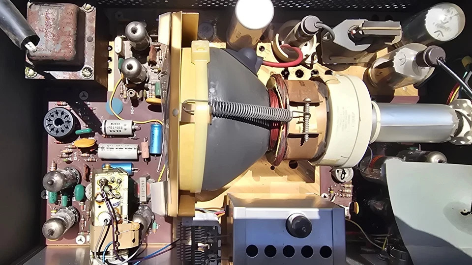

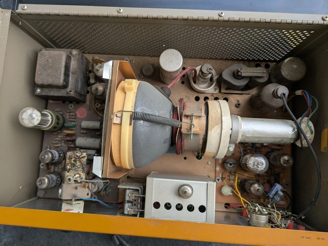

Old 09-21-2026, 07:42 PM
Posts: 3,255
Your mention of the B&k 1077 made me give in and go out and find one on evil bay!
I have always wanted one!
It was only $95, and very clean looking.
http://suzaku.live-evil.org/ezgif-61b06a3c43119908.jpg
but you may notice something missing.
Not to mention I did not see any templates.
So I got a 2nd one,
http://suzaku.live-evil.org/ezgif-604c1d51370434b0.jpg
$80.
Worse shape, had the critical part, and templates, sad it was "smoking" when turned on. looks like someone has been into it.
So between the 2, should get a good one!
