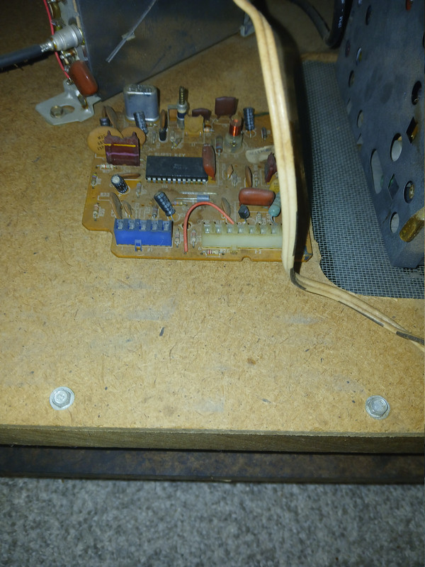

Looks like someone wrote on the back, CTC90D. Anyway, just got this from a guy that was a tv tech who had kept up maintenance for years. It doesn't have any color to it and it has a bit of convergence issue near top. Just looking where to begin. Want to use this set with matching vcr, ced unit and atari.

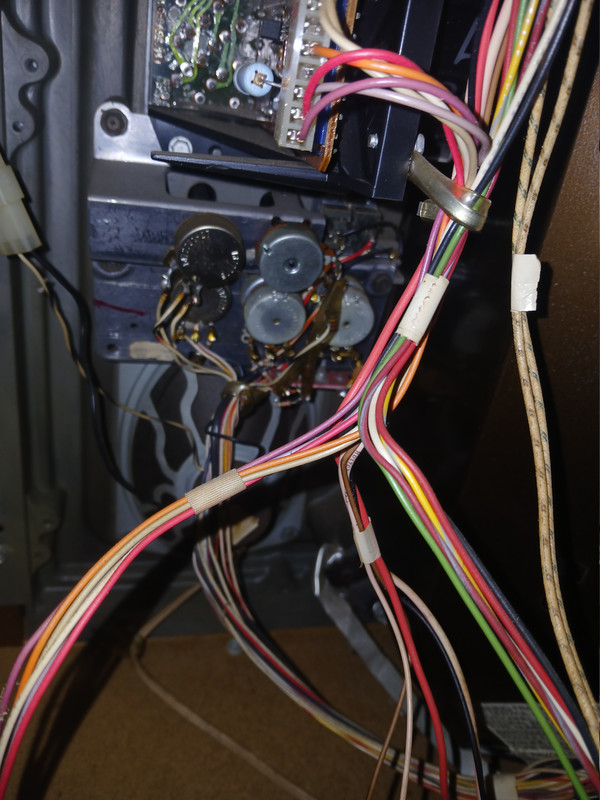

Open up the door at the bottom of that panel and take a picture of the color control. Make the picture larger. Your other pics are too small.

That's it. What happens to the image when you swing that color pot from end to end? Nothing at all?
The color pot is the one on the top right just to be clear.
Yeah no change at all.

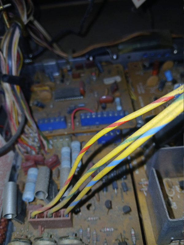

You mean that top left looking from the back? Also looks like its had a history with color problems. Some changed the board out and left the old one inside...
