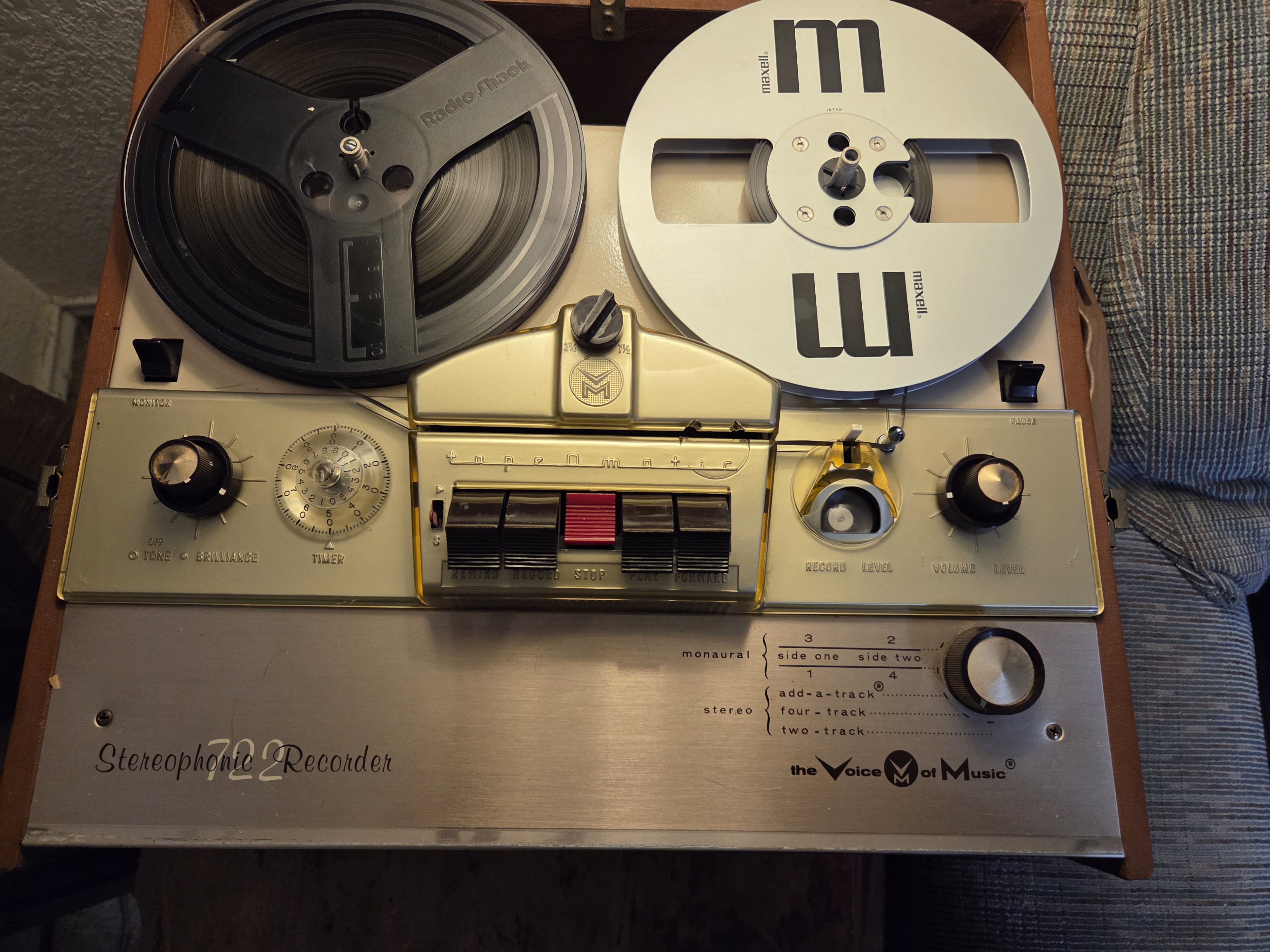

Old 08-06-2026, 05:06 PM
Posts: 3,244
My 722!
http://suzaku.live-evil.org/20260516_193127.jpg
