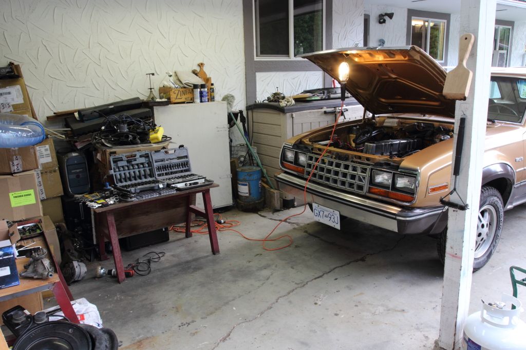

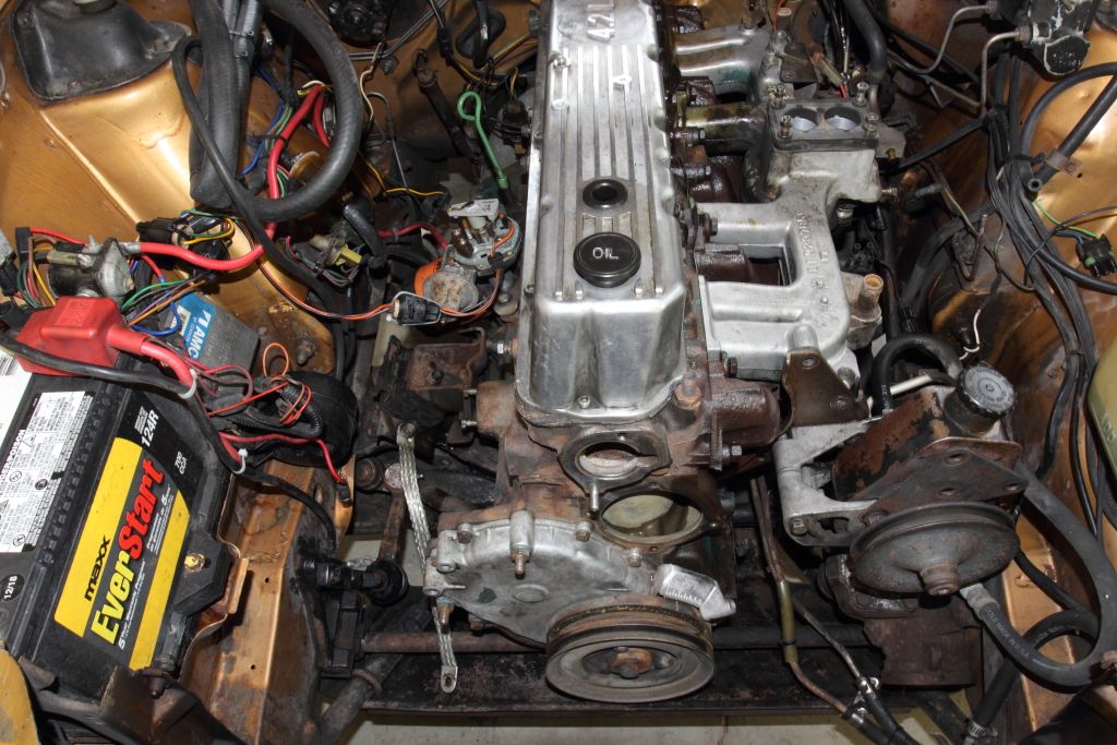

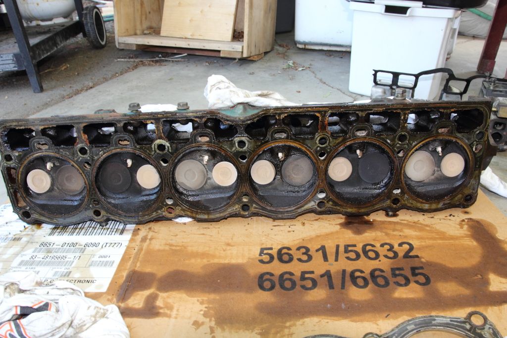

Guess what's happening this week????
I'm fed up with the lifter tap and my water pump decided to start warning me of impending failure so I gathered my parts together and going to town.
-Replace lifters
-Replace head with a rebuilt 4.2L
-Replace water pump
-Replace thermostat
-Replace timing chain and sprockets
-Clean up the manifolds
-Replace fuel pump
-Change the coolant
-Change the oil (because it's going to be dirty after this)

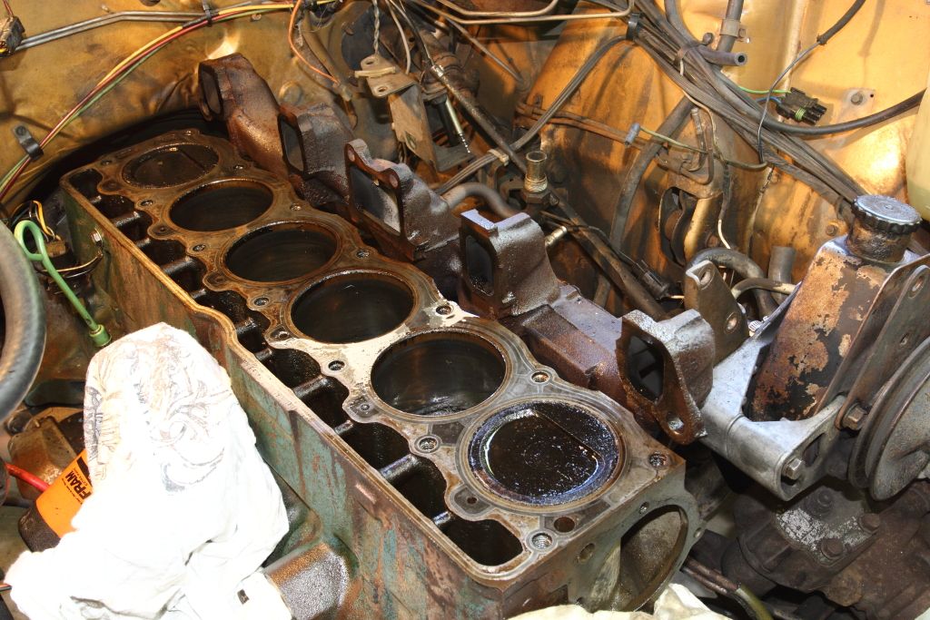

As it turned out I was not planning on a head replacement but got pushed into sending my spare to the shop last week to be rebuilt anyways. As the old head was unbolted it pried itself up which was a sure-sign the head's warped, so I'm happy that actually turned out okay.

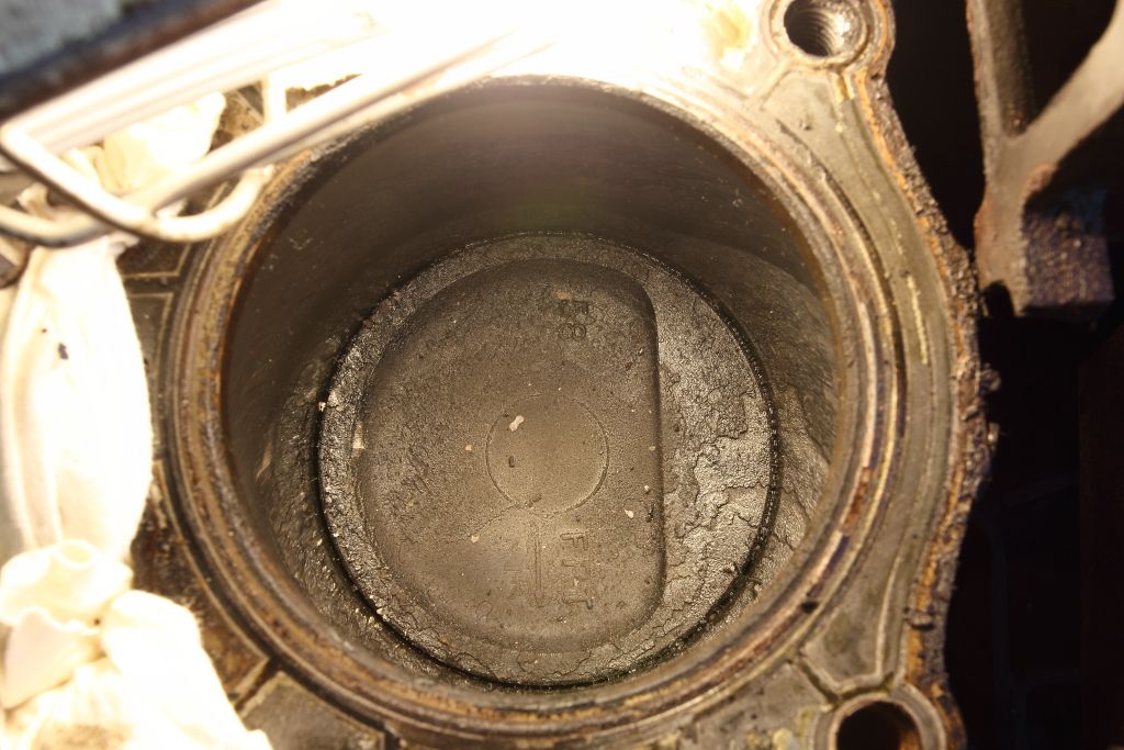

The cylinders have a lot of carbon buildup. I was able to get most of it off using WD-60 and a wire wheel at TDC but there's still some deposits I wasn't able to get off, so it will soak overnight.
The fuel pump was not palnned but when they start weeping form the vent it's only $15 for another one. The chain on the other hand was not planned. The recommendation was since I don't know when it was last done and pretty much everything is pulled out of the front of the car it's a REALLY good and convenient time to do so. That's another $50 in parts but DAMN that damper bolt is tight. With the head removed I can't use the rope trick to pop it off and an impact driver can't make the fit so yaay.

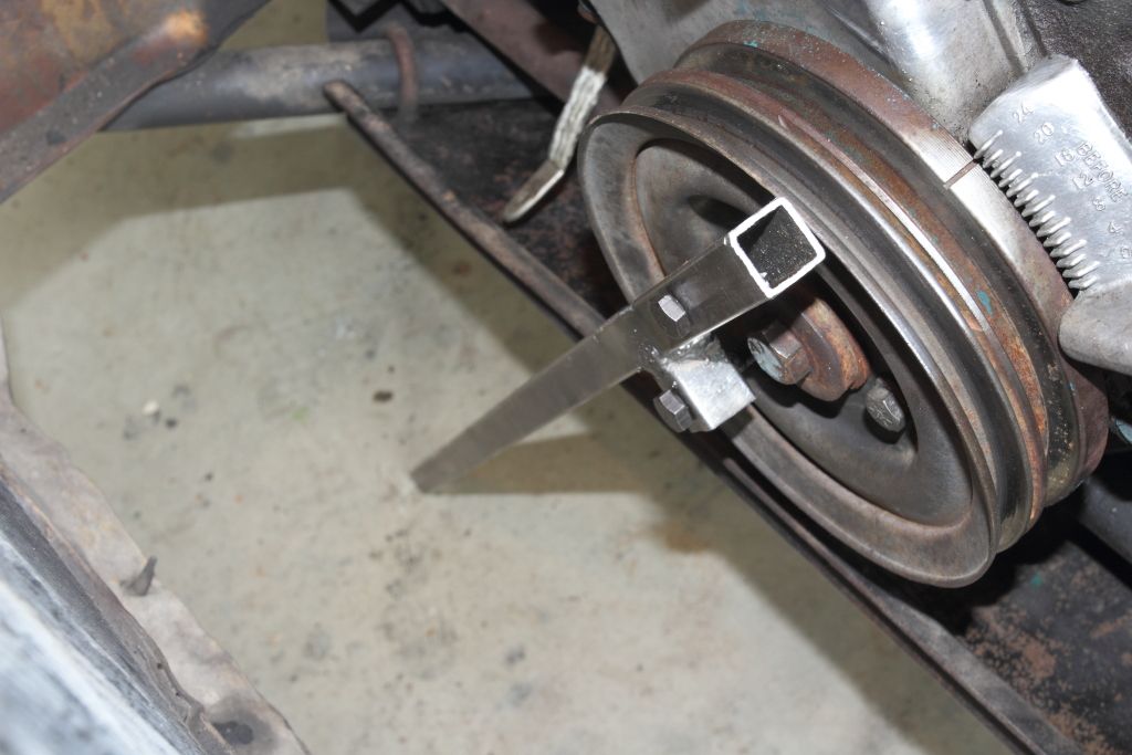

Block the flywheel by jamming a screwdriver into the gear teeth. Might need an assistant to do that while you put a big bar on the crankshaft pulley bolt. Alternatively, remove the radiator to fit an air gun in there. Can't tell if you have already. If I'm desperate, I'd use one of those chain wrench things. It'll chew up the pulley a bit, but with it out, you can file off the nicks.
Run the wire brush over the cylinder block deck to remove all that crud in prep for the new head gasket. Don't use anything else like surface blending discs (cookies).
Don't stress about the carbon on the top of the pistons. Not really a big deal. (Carbon in the rings is more concerning, but you're doing enough work right now lol)
How do the cylinder bores look?

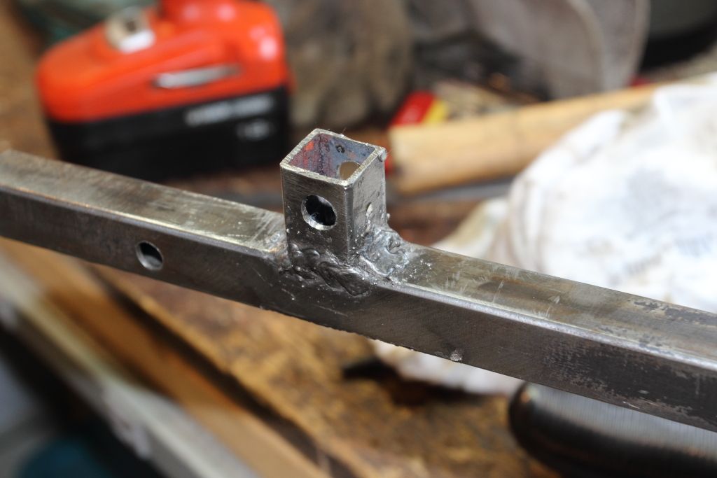

I went a bit further than that and because I have the TSM there's a note from AMC that if you can't torque the bolt without the crankshaft turning you can fabricate a tool that stops it from turning by holding it against the body/ground.
The spec is only 80 foot pounds, so nothing says that a modified tool can't be made that lets me do it both ways.
This is an approved method.
Because the water pump was coming out I pulled the radiator as well and had to clean it up a bit. As the bearing drifted there was a radial mark on the fins where the fan was juuust starting to clip it and I wanted to flush and repaint the damaged area. Likewise I'm already ahead of you with the wire brush but man I should of dressed the area more because WD-40 and a brush attachment paints everything with black gunk. I left the old lifters in for now so that any crud that falls into the galleries can be vacuumed out instead of making its way deeper into the block but carbon removal was also why I am in here because there was a LOT seen on the borescope. Cylinders otherwise look okay but I'm having a hard time seeing the crosshatch, though at this point if we have to go deeper, forget it I'll probably just get the whole block rebuilt.
