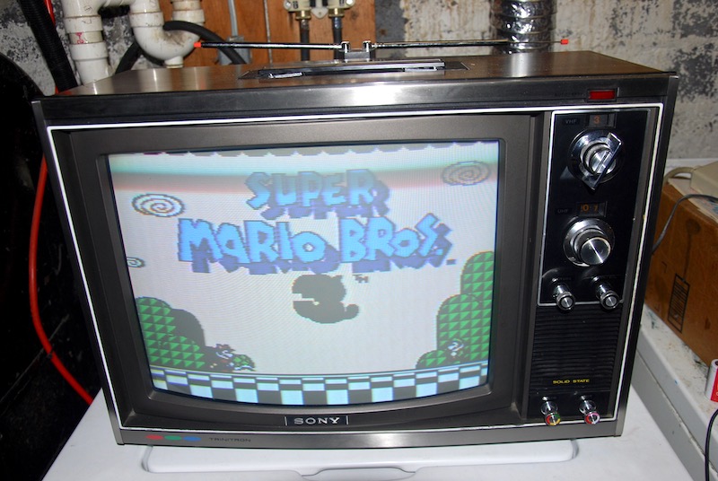

New-to-me Sony Trinitron KV-1710
Hello, everyone! I've generally shied away from TV collecting, but this showed up during a "ZoomFest" held in lieu of my antique radio club's usual spring swap meet, and I just couldn't help myself. It's a Sony KV-1710, circa 1972. Supposedly one of their last sets to use (mostly?) discrete transistors. The 17" Trinitron jug seems to give a good picture; the reds might be a bit weak as is typical, but the picture seems pretty well balanced from what I've seen with my NES 'toploader' game console connected to it as a makeshift source. Here are some photos of it, both off and being fed with the title screen of Super Mario Bros. 3:

Looks great!

Oo nice set! I like the early trinitrons. I haven't been able to find one like this yet though

Great find! This was Sony’s first venture into “large screen” sets with its 17inch diagonal measurement. The actual date of introduction was in Fall, 1970, not 1972. I know because I purchased a KV1720 with walnut cabinet about September, 1970. It replaced my RCA CTC-19 Bremanger.

I'm sure they're out there, though how many of them still have a decently strong picture tube is another question. I was lucky to buy mine from the original owner, who most recently had it set up near his treadmill.
I saw your page when looking for info, especially since I wasn't sure about the model number at first. I could see that the 1710 and 1720 looked similar, but wasn't entirely sure how they were related. As for the year, the seller told me that he bought it in 1972, and that's when the above-pictured Burdick's ad was from, so I went with that.

The earlier Sony CRT's seemed to stand up better. I seem to think that they were still made in Japan. The ones, made in California didn't last as long.
It sure is a nice example of a well-kept set. It was worth getting.

Upon closer look at the photos that cabinet is in really great shape as even the rabbit ears are all there with the orange tips and aren’t even bent.

Good to know, thanks! Hope that's true of this set; the sticker on the back of the cabinet says Made In Japan, though I haven't opened the set to look at the CRT itself. And yes, I do believe it was well worth the $25 I paid for it.

As I mentioned, I bought this set from the original owner, who took very good care of it. The 'rabbit ears' are the original Sony AN-14, and other than missing spade lugs on the end of its cable, it's in great shape. One odd thing about this set is that it uses binding posts for antenna connectors instead of the usual screw terminals. Not sure I've ever seen that on another older TV, and I've connected game consoles to many different two-dialers over the years...
