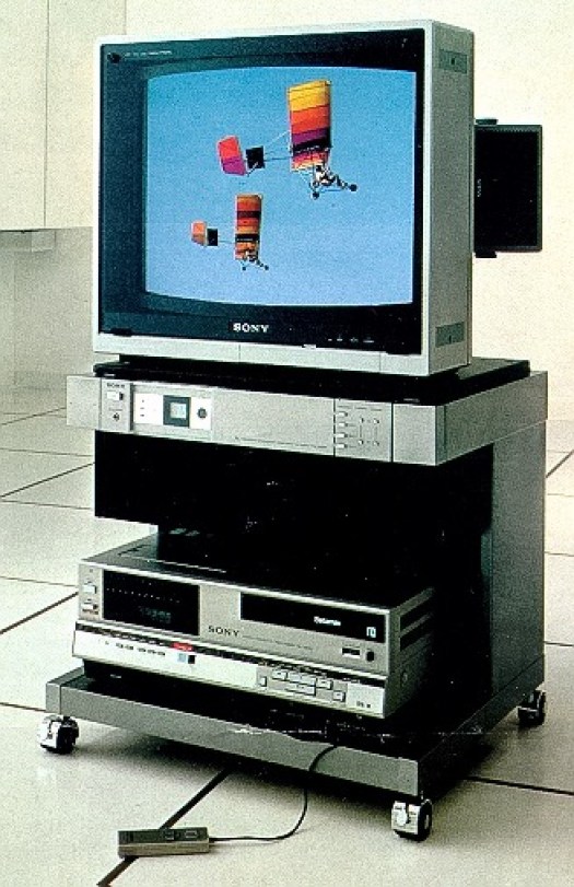

The Sony Profeel system circa 1980’s

That clunking SL-5000 Betamax came out in 1981.. Those have a handful of defected electrolytic caps on the servo board which cause unstable playback between the drum speed and tape speeds..

We had a profeel customer with a large monitor that we kept taking back to the shop for a shutting itself off symptom. I forget the size of the set but I want to say at least a 21 inch or larger. That was a heavy monitor. I think we had it back and forth between the owners home and the shop at least 3 times. Even put heavy blanket to try to get it to heat up. We finally did get it fixed. It was the HV shutdown circuitry that was detecting arcing in the HV block. A new HV block fixed it finally.
