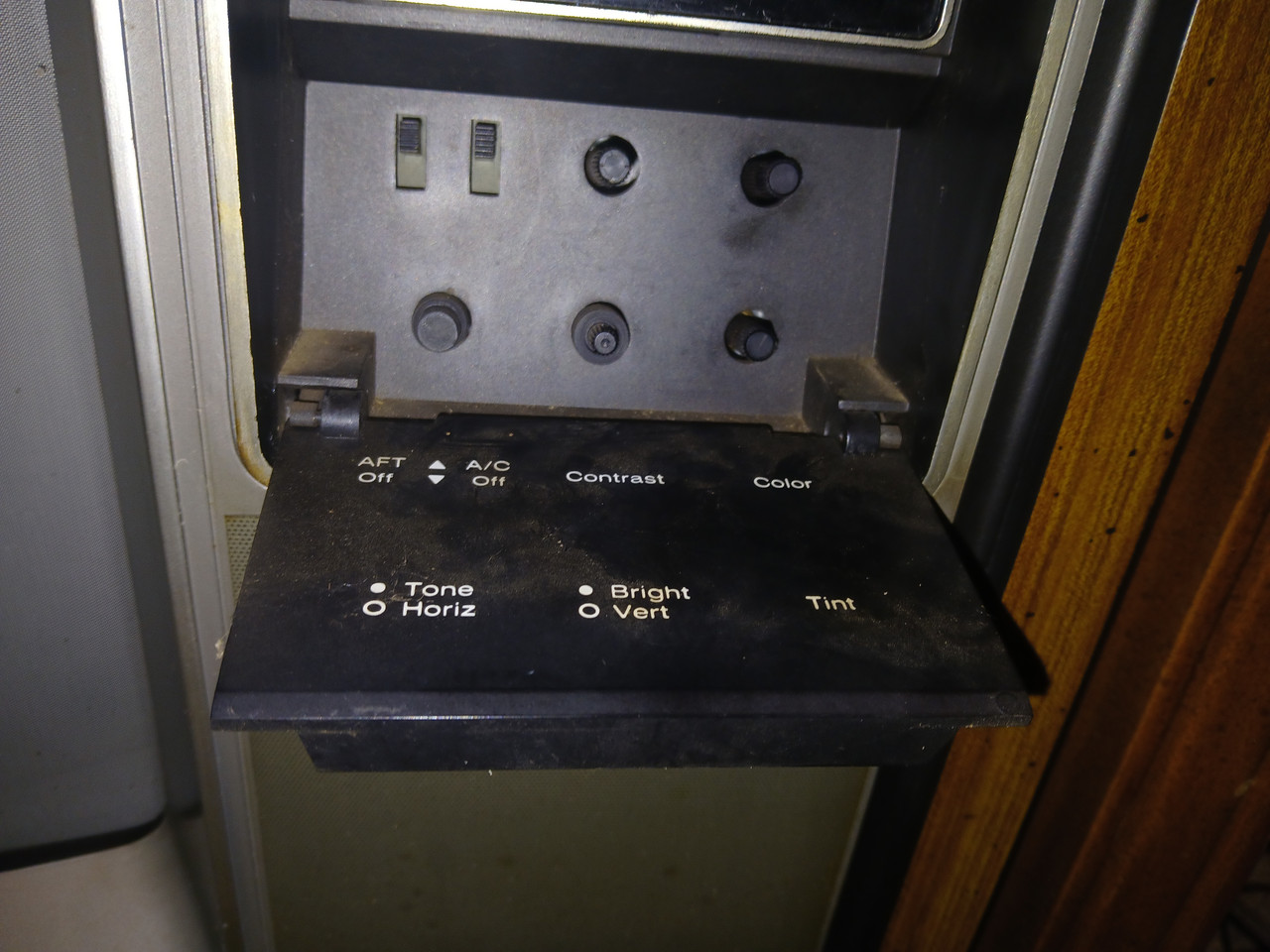

Open up the door at the bottom of that panel and take a picture of the color control. Make the picture larger. Your other pics are too small.

That's it. What happens to the image when you swing that color pot from end to end? Nothing at all?
The color pot is the one on the top right just to be clear.
Yeah no change at all.
