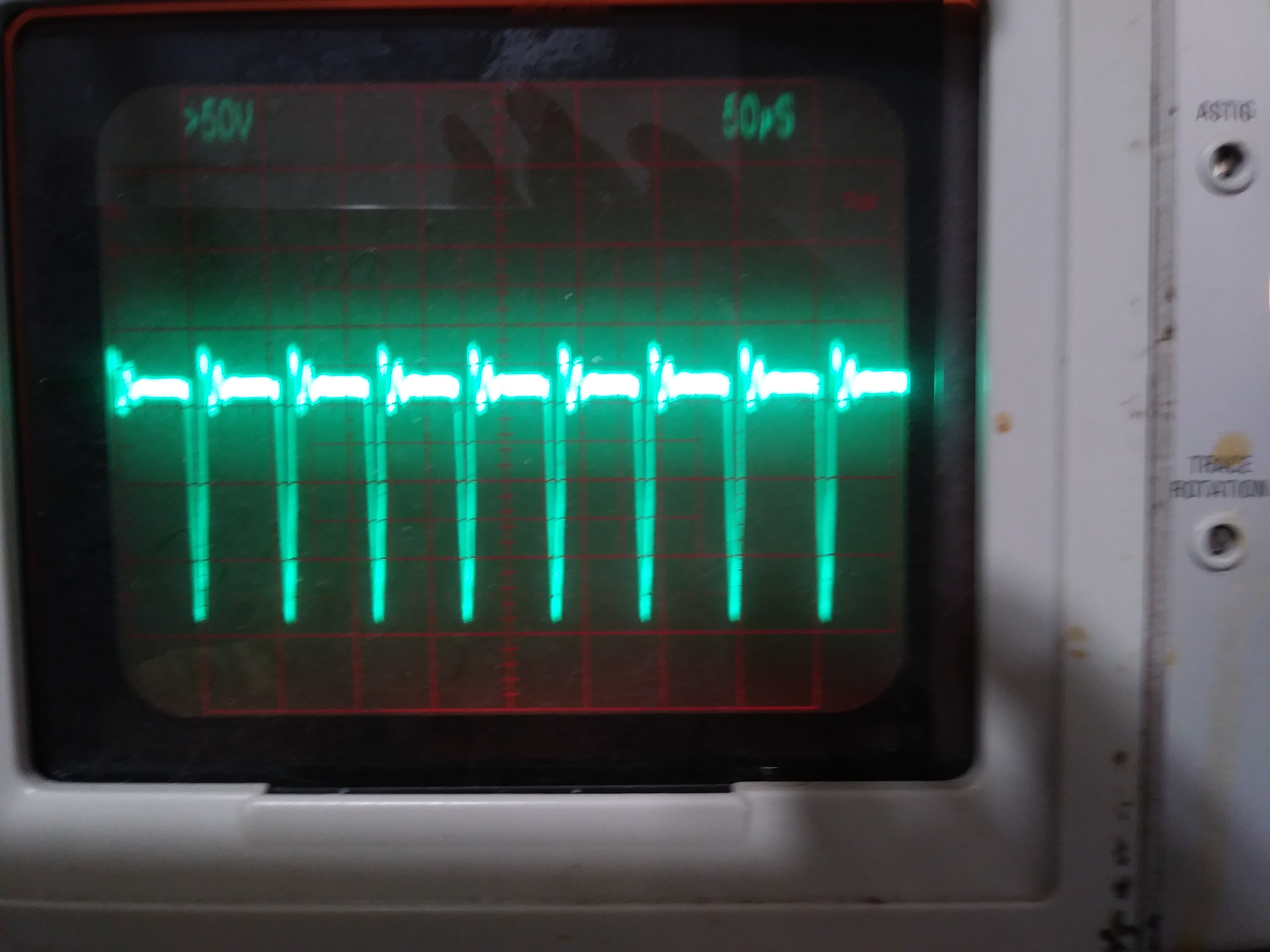

Brightness parts fixed, mew tubes in
Get a faint image on screen now, very faint, Det diode may be weak.
Cant get horz lock hod pot does little horz lock tune cap does not help.
suspect that it's off freq.
http://suzaku.live-evil.org/0413250136.jpg
I could never do the math for this to convert to HZ, but I think it's too high
like 17-18hz MORE bad resistors perhaps?
  #108
Old 04-13-2025, 10:13 AM
Posts: 8,827
Yes, looks like around 17kHz. It will be an LC tank circuit that sets the frequency. Could be a mica cap is off.

Checked the resistors on the osc coil they seemed OK did not check ALL others on the area.
There is no instructions on how to set this horizontal oscillator circuit, several paper caps have been replaced that were leaky so I suspect the circuit was adjusted to work with them as they went bad, and thus it is running too fast now.
There is a variable cap ( horizontal lock) on the grid of the horizontal AFC that seemed to do something but not enough, and a ferrite ( horizontal speed) on the back of the osc coil that I did not try to adjust yet, also an UN-named adjustment in front of the osc under the chassis.
It looks like its trying to lock, but the frequency is too far off
  #110

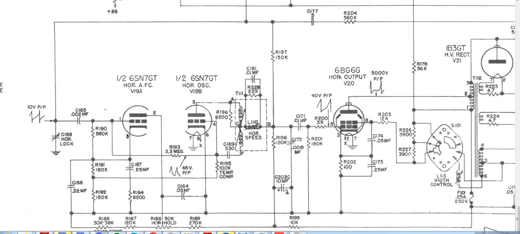

Adjust horizontal speed - that sets the frequency
  #112
Old 04-13-2025, 02:22 PM
Posts: 3,236
That's what I thought i might be, but was not sure, no idea why they picked Horizontal Speed over Horizontal freq, I guess that they decided that frequency was not vague enough, and decided to make it a bit more confusing!
http://suzaku.live-evil.org/maggie-horz.jpg
It looked like that adjustment was turned all the way, or almost, all the way out, have not tried turning it in yet.
Focus parts are ordered, as is 2 mica caps, 5pf and 330pf, may end up not needing them, if i can tune this in, but since I was spending the money for shipping, I got them anyway.
Still not sure about the old det diode, it SORT of tests like a diode with a digital meter, but the fancy all in one digital tester can't ID it as anything (cap/resistor/diode/transistor/ETC) checker. where it has no problem testing the new 1n60, so I suspect the old diode may be leaking/ breaking down.
  #113
Old 04-13-2025, 04:08 PM
Posts: 8,827
Good ahead and adjust it. You're not going to hurt anything. Looks like a class synchro-guide oscillator.
BTW don't mess with the 100K temp comp resistor if you don't need to. It is designed to change value with temperature to keep the oscillator from drifting.
yeah, I left it alone, it was easy to ID, it was that strange part stuck in there wrapped in 50+ year old shrink wrap tubing, there was a 3rd domino mica cap in there that I did not order, that was not shown on the schematic, hooked in direct parallel with the variable cap for horz lock, it's ALMOST, but not quite too discolored to read the value dots on it!
