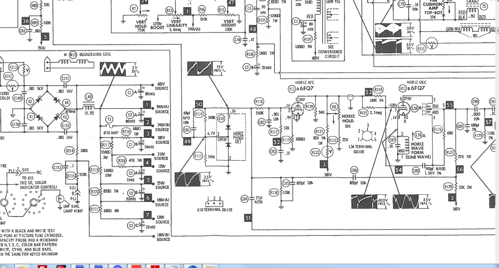

1 is good, 2 is a charm, 3 is nuts! :P
http://suzaku.live-evil.org/crazy-color.jpg
Seems that all 3 of these gimmick lights are burned out. :O
Bad design.
NPN switch from the 6.3 fil power through a 1/2 wave rect, lighting up 3 2 volt bulbs through a 6.8 ohm resistor, as long as ALL 3 lamps are OK, all is fine, but if one burns out, then they ALL go because the voltage spikes.
they sell them in packs of 10, not gonna do it, I can get ultra bright yellow LEDs that run at 2-3 volts in packs of 20 cheaper.

I really don't mind using LEDs at all, they are cheaper than bulbs, and outlast them.
On second thought, since the source is 6.3v, and the drop across the transistor is pretty much nothing, w/o any bulbs, the switched on output should be about 6-7v so by adding a dropping resistor to ground, like 6-7 ohms should get me the 3.1v needed to use the ultra bright white LEDs, like I used in the GE TV.
Will just have to play till I find the right resistor value.

Trying to picture this. Wouldn't a separate series resistor for each LED make more sense?
The current draw of the old lamps was 3x .06a (180 ma total)
the draw of the 3 LEDS is 60 ma 3x20 ma.
The entire circuit in question is mounted on terminal strips behind where the bulbs go in.
I'm pretty sure all I need to to is add a resistor to gnd at the far side of r160, to keep the voltage about 3-4 volts, the LEDS are pretty forgiving about what you give them, and even if I damage a few while working out the correct value, I have 100 of them to experiment with, and they are small enough to solder into the shells of the old bulbs after the glass has been removed.

What has me scratching my head is 2.5v on the collectors of the NPNs, the source is 6.3v via a 1a SI rectifier, same type used for the main bias, which has a forward voltage drop of .6v, so is it really down to 2.5v from 6.3v via half wave?
Perhaps that there is no filter on the cathode of X11 that it's just being very inefficient?
Will have to look more closely at this.

1) It looks like the power is supplied as half-wave rectified AC through X11, so the DC reading doesn't tell the whole story.
2) The schematic doesn't give two sets of voltages, one with color present and one for black and white. Since the waveforms show color, I'd presume these are the voltages for the lights being on, but again it's not clear if the emitter of Q2 has plain DC or pulsating DC. 2 V DC is not going to be enough for the LEDs.
3) LEDs, like all diodes, have a sharp turn on, so trying to match the voltage is not good practice. Instead, you should look at the difference between [EDIT] the emitter of Q2 [END EDIT] and the diode drop and install a current limiting resistor in series with each LED.
4) In this circuit you are served a curve ball if all the voltages are pulsing half-wave rectified. Checking with a scope would be a good idea.

5) what you are hoping to find is that the peak of the pulsed DC on the emitter of Q2 is more than what's needed to make the LEDs conduct.

It's just as I thought with this trio of lights behind the controls, w/o any bulbs, the voltage on the emitter was not @ 2v, but at 5.5 with no load. I even stuck in 1 6.3v lamp I had, and it lit that up to 1/2 brightness.
for the LEDs, i just have to find the right load balance to keep them happy.
