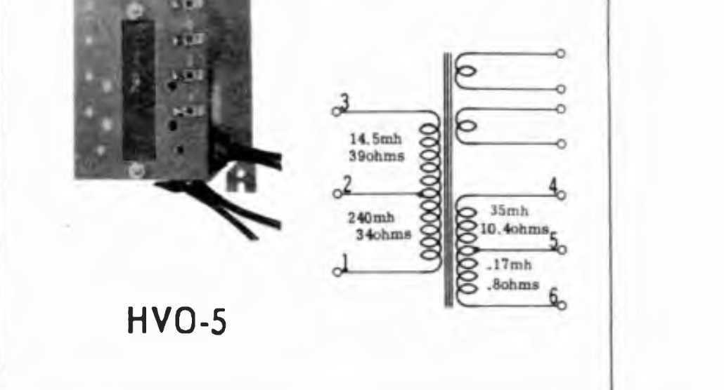

Posts: 3,244
more photos of the FBT area
http://suzaku.live-evil.org/0226251827a.jpg
http://suzaku.live-evil.org/0226251827.jpg
http://suzaku.live-evil.org/0226251827b.jpg
http://suzaku.live-evil.org/flyback.jpg
took some measurements, perhaps its good, but the resistors are bad!
R225 is not there at all!
I'm not sure what the FBT should test at, so I hope it's OK!
but the wires are no good. falling apart!
http://suzaku.live-evil.org/0226251831.jpg

  #39
Old 02-26-2025, 07:32 PM
Posts: 8,829
Is that 6.5 Megaohms? If so, that's bad. Should be around 200-300 ohms

i need a FBT then 320035-1
  #41
Old 02-26-2025, 09:06 PM
Posts: 3,244
Thordarson FLY4
  #42
Old 02-26-2025, 10:41 PM
Posts: 3,244
OK this is getting weirder
http://suzaku.live-evil.org/weird.jpg
I had a loose connection when I checked it
It tests at 24 ohms at 12uh. Good/ bad? not sure now
But HVO-5 is the right replacement
  #43
Old 02-27-2025, 11:55 AM
Posts: 3,244
So, at this point I'm not sure if the original FBT is good / bad yet, but it's definitely ugly! ( insert 60s movie musical cue here)
The only reference spec I could find was for the replacement merit hvo-5, which may or may not be like the original part, bit confusing.
The fuse for it was NOT blown, that is at least a good sign.
