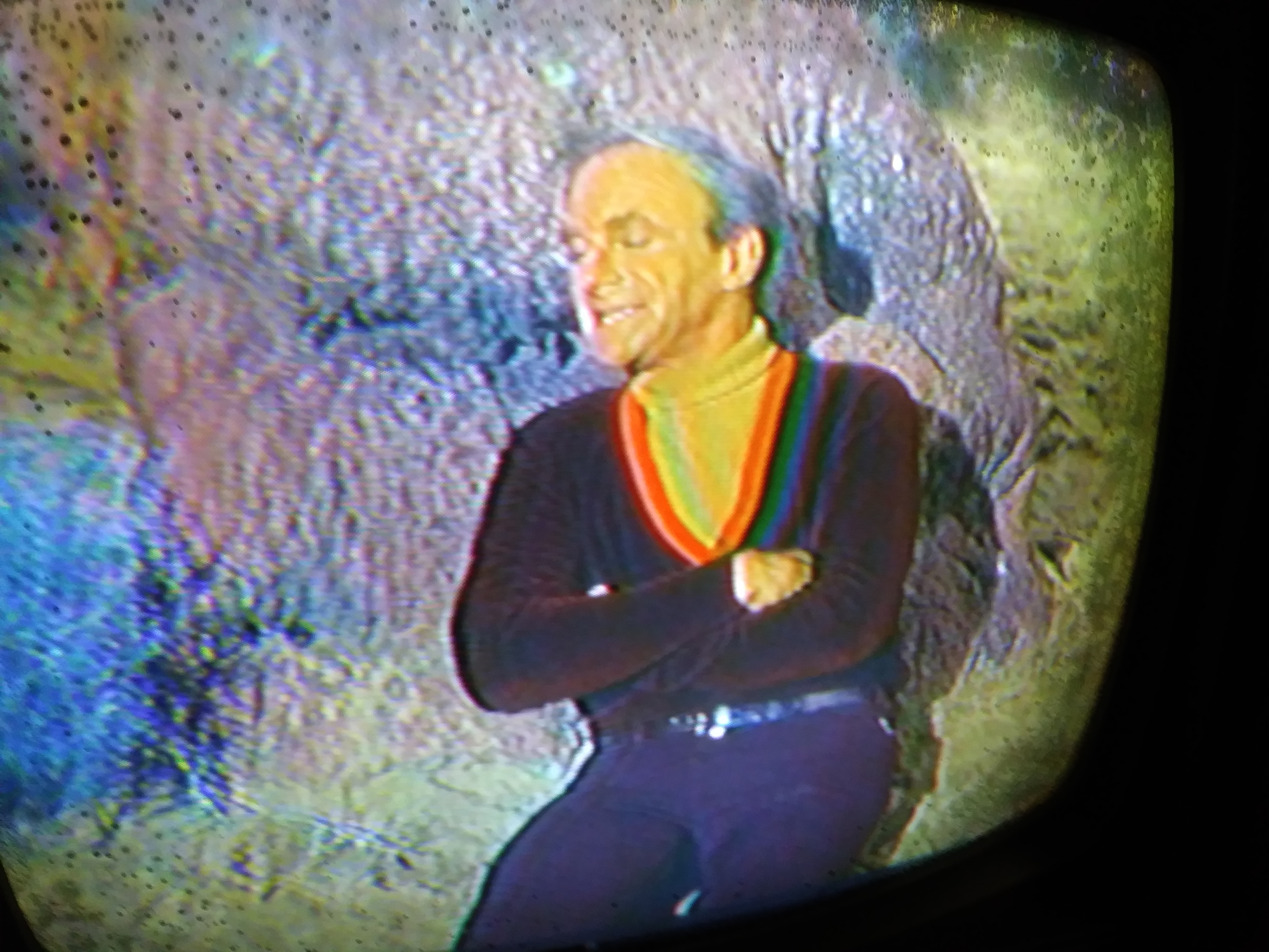

I GOT IT!!!
http://suzaku.live-evil.org/0521232104.jpg UGLY cataract.. RCA style!
http://suzaku.live-evil.org/0521231638a.jpg neat speakers!
http://suzaku.live-evil.org/0521231638b.jpg Houston we have a T933 chassis
http://suzaku.live-evil.org/0521232104a.jpg wired up for test, got no emissions at first, WAKE UP!!
http://suzaku.live-evil.org/0521232106a.jpg 20 MIN later.
http://suzaku.live-evil.org/0521232107b.jpg found this this thing on the bottom of the cabinet, where did THAT come from
http://suzaku.live-evil.org/0521232108.jpg Who stole the tuner cover!?!?!
more later!

Just placed a order for a bunch of electrolytic capacitors for the set, as I'm sure they are no good as always.
The flyback transformer looks clean, shockingly clean, TOO CLEAN almost, it has had an easy life, or has been replaced, never seen one this nice before.
http://suzaku.live-evil.org/0522230602a.jpg
This is obviously a custom cabinet, because one dumb thing about it, there is no room to get to and open the side cover on the HV box w/o swinging the chassis out for room.
Another thing that was noticed was, all the screen controls were turned all the way up almost, this does not match with the rather decent emissions that were shown with the CRT tester, meaning some fault with the chassis to be worked out, likely a weak selenium boost rectifier like I had in the Hoffman Colorcaster, or some other fault in the CRT circuitry.

My T931 had screen cranked even though CRT emissions was good. It turned out that the horizontal blanker tube V19 (6GH8A) was tired, and when that tube gets tired the DC bias of the picture tube G1 anodes becomes very low. So you should try swapping that blanker tube for one that is know to be good.
In fact, the only low emissions tubes in my T931 were the three 6GH8A tubes. Chroma demod didn’t work until I replaced the 6GH8A that was used for the chroma oscillator. The T933 chassis is almost identical, so consider swapping those 3 6GH8A tubes out for NOS.
All of the electrolytics were still within spec too, except the two on the convergence control board.
My T931’s flyback looks great too. I think it is due to the fact that the horizontal efficiency coil was tuned for absolute minimum horizontal output tube cathode current. Tuning that coil doesn’t just decrease wear of the HOT, since the HOT is in series with the flyback transformer, that coil’s tuning decreases the wear and tear of the flyback transformer.

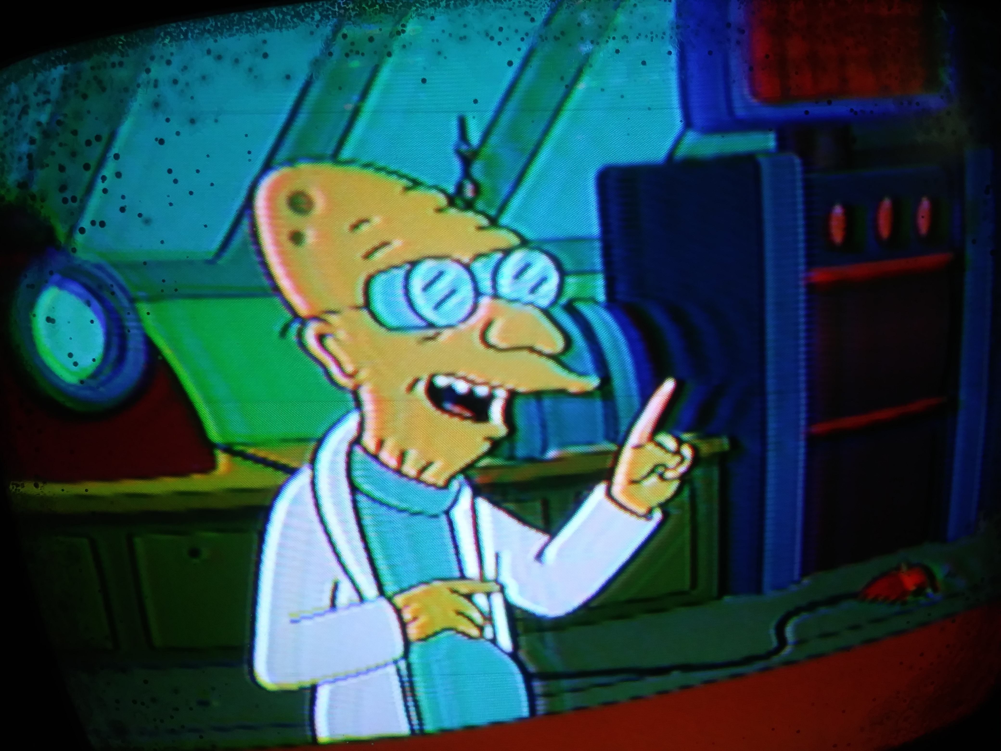

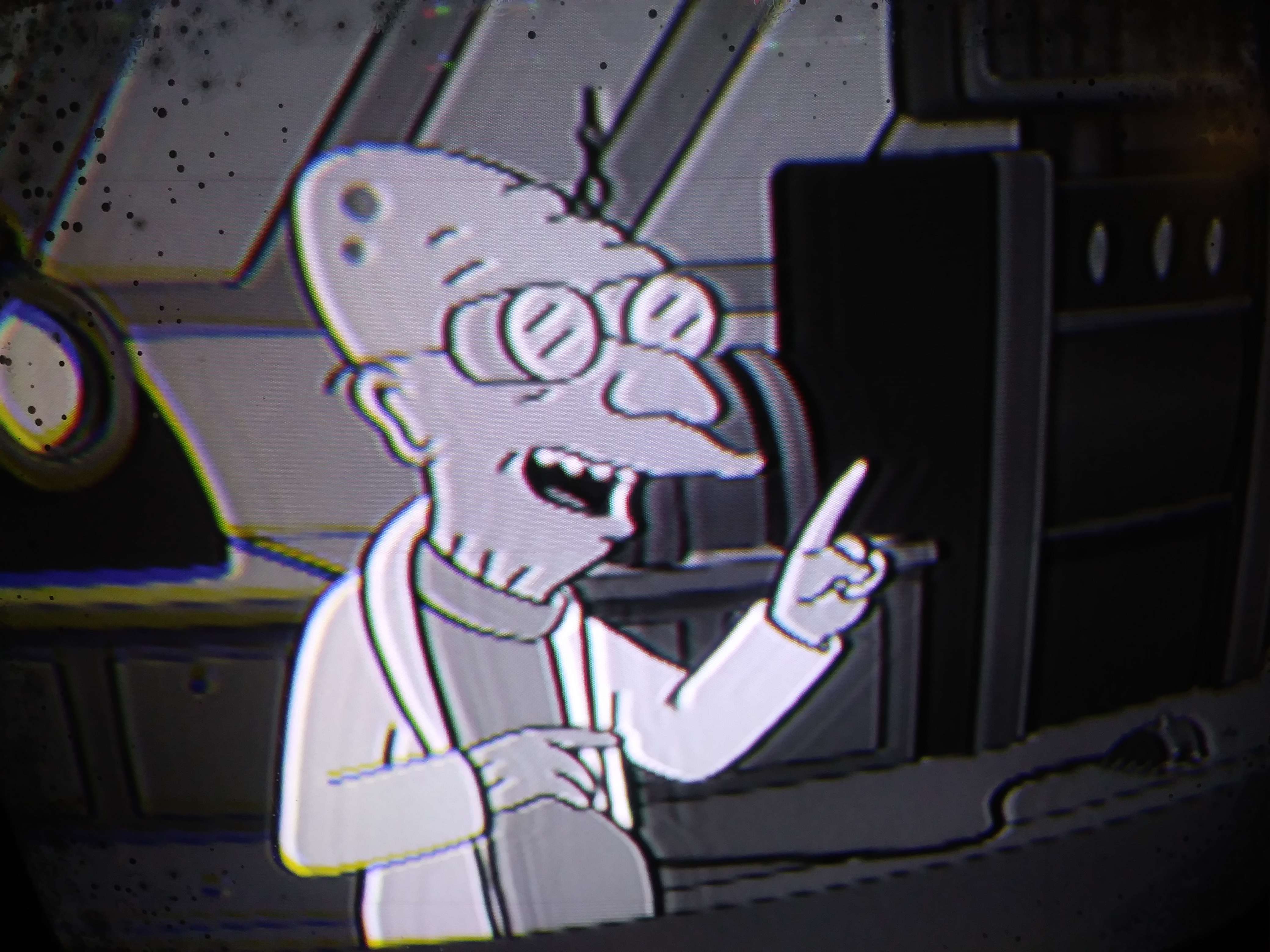

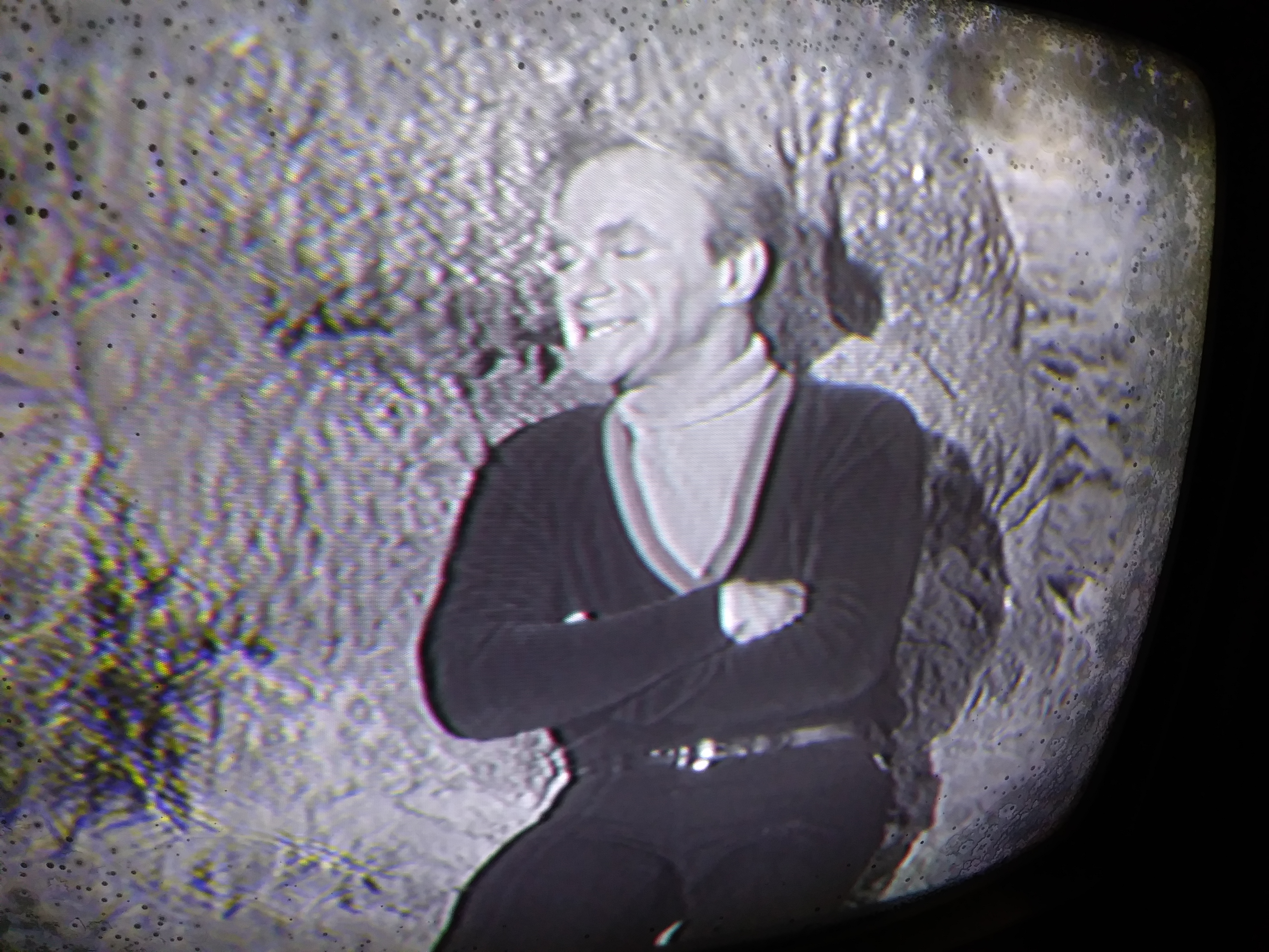

I.m gonna have to do something drastic to replace it, cause I have noise in the B+ line
  #45
Old 05-23-2023, 11:04 PM
Posts: 3,247
https://www.youtube.com/watch?v=QFl25sRnB0E
many weak tubes
most are still the original.
gonna have to check all the resistors as well
but FIRST video
