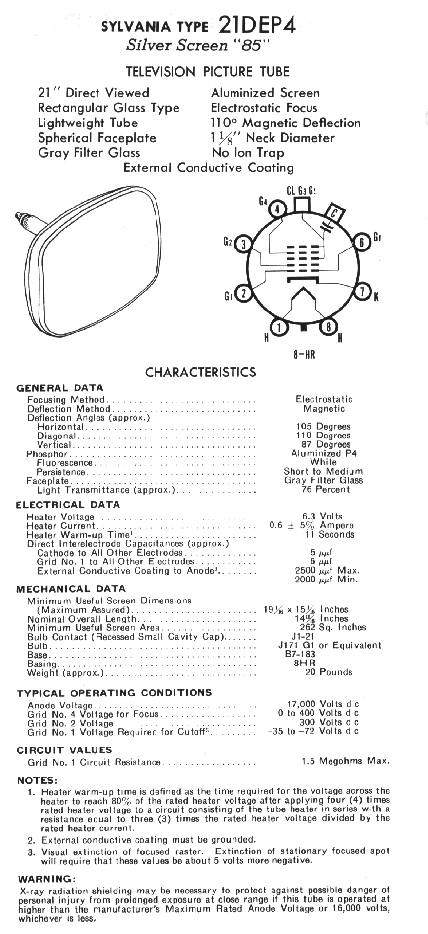

The U4 chassis also used the 21ESP4 and has 2kV more HV. The U4 also has a 6AQ5 for video amp and other differences. Both M4 U4 have taps on G2 for focusing
The G3 voltage (boost) for M4/21DEP4 is 310 while the U4/21ESP4 is 590.
I have a sams substitution book, but the 21DEP4 has a few subs but not the 21ESP4, The 21DEP4 shows only one sub..

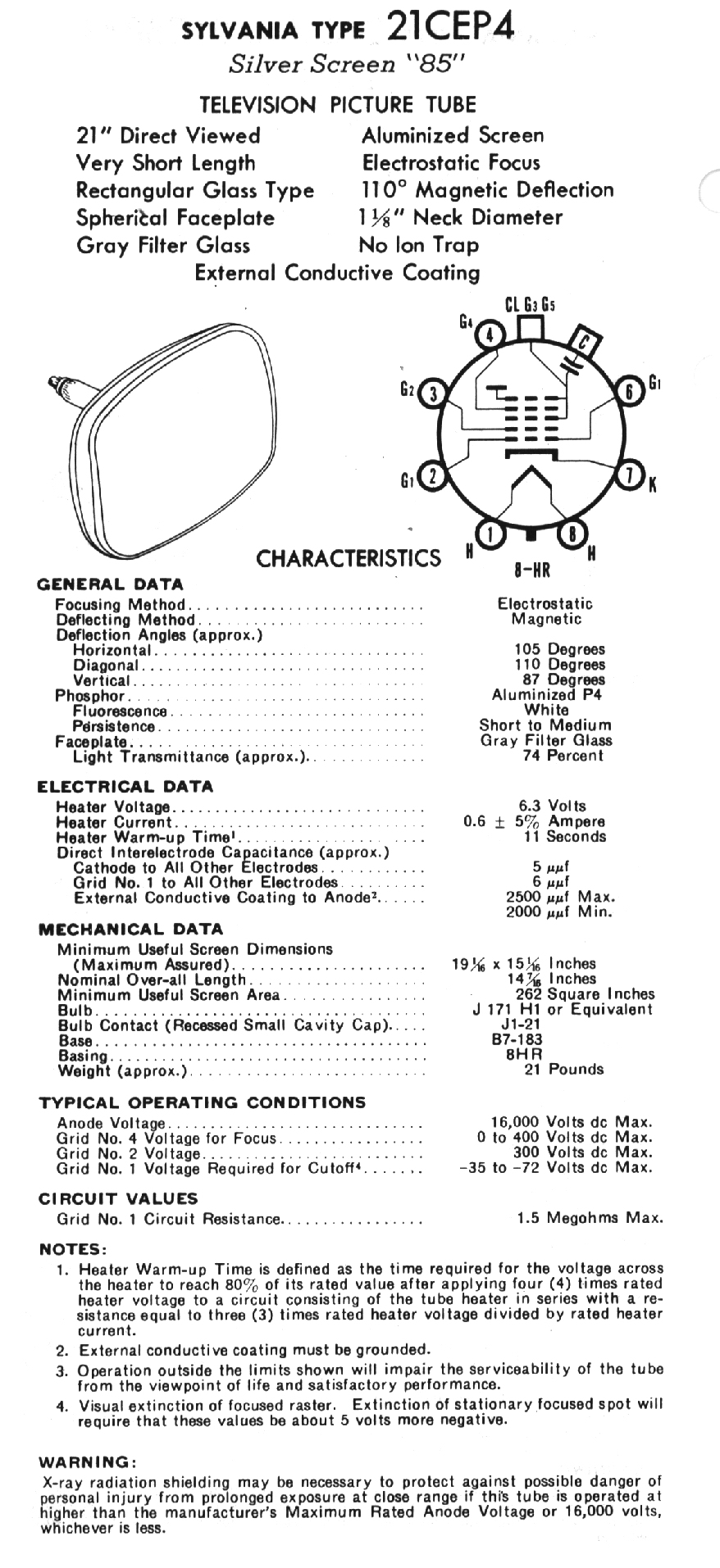

So, I got the 21ESP4 up on the bench for a test. It certainly works, but I don't think it's as bright as it should be considering it tests like new.
DavGoodlin above mentioned that your new CRT 21ESP4 wants something like 590VDC on I think it was G2, and the old CRT wanted about half that. Found it: http://www.bunkerofdoom.com/tubes/sy...RTS/21DEP4.JPG And the TV set chassis would be providing what the old CRT wanted, and that might be making the new CRT be dim. If so, you might be able to hack together some form of voltage doubler off the flyback winding that's making the current G2 voltage source, to make something to feed the new CRT G2 pin. Or maybe there's a source of voltage intended for focus you could use.
Try your 21CEP4, it looks like a better match http://www.bunkerofdoom.com/tubes/sy...RTS/21CEP4.JPG
