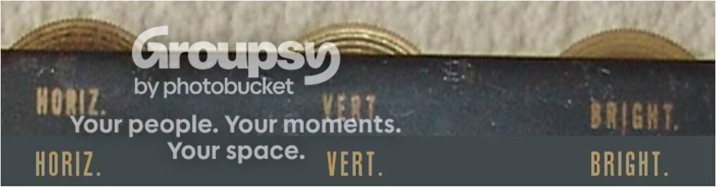

I'm trying to replicate the control labels on the back of the cabinet top. It dawned on me that someone here might know the font that Philco used on these sets? Here's what I've got, so far. It isn't exact, but I'm rapidly losing concern about it...
This is Haettenschweiler 24 font size with a 4 point character spacing.
Another close-fitting font is Alternate Gothic No. 2.
I don't have selection in Power Point. Could you send me an example?
