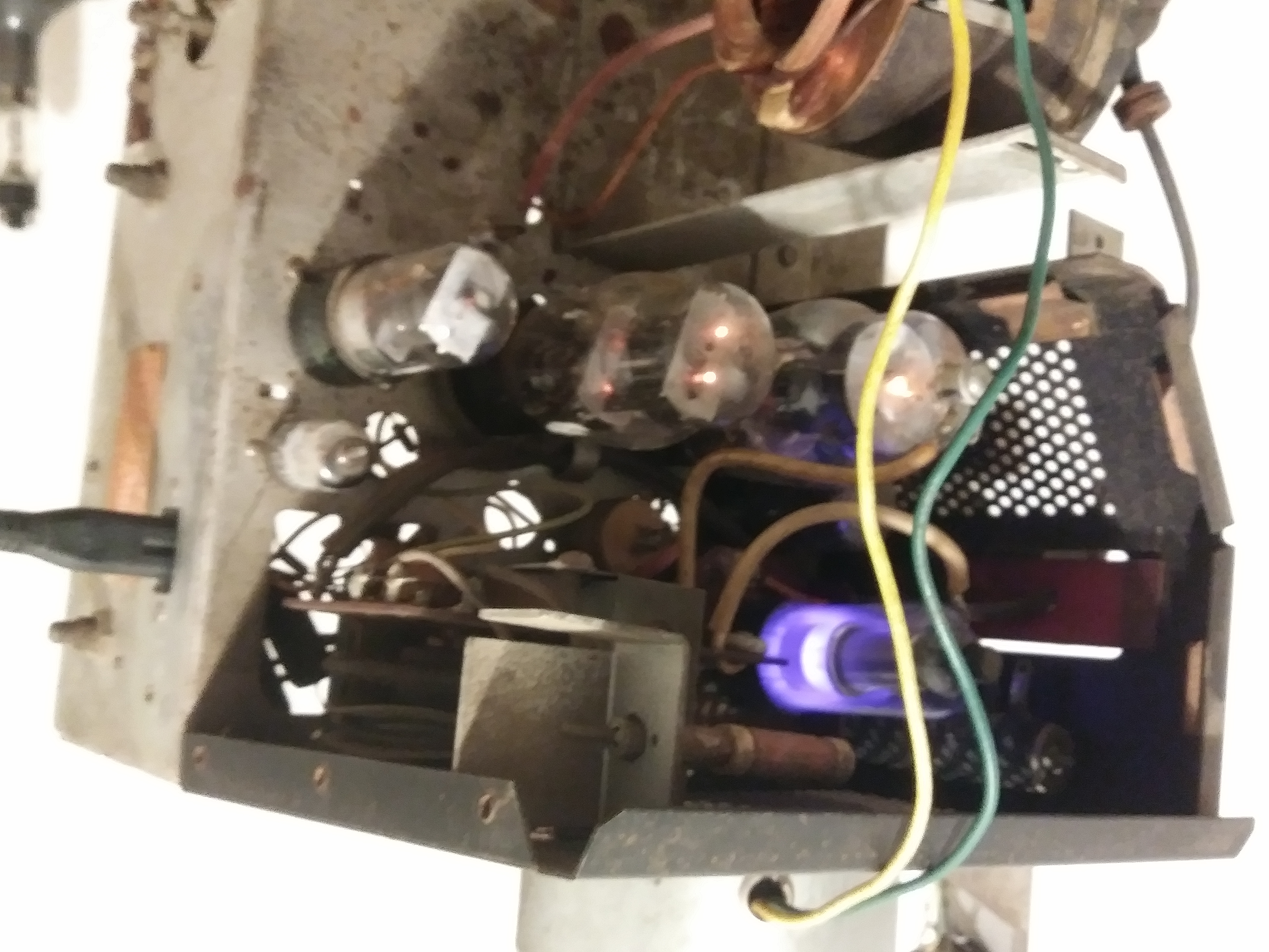

More possable problems is the 1b3 filament seems way too bright at 117 volts. I know this tube is powered off the flyback so whats up with that? Adjustment way out of whack causing it to draw more filament current or a bad 1b3?

fumplet fumplet is offline
Join Date: Apr 2023
Posts: 161
is this tube too bright. I have read that a 1b3 is barely able to throw enough light to be detected unless room lights are off!!!!
Old 06-29-2024, 05:02 PM
Posts: 3,243
looks normal to me!
