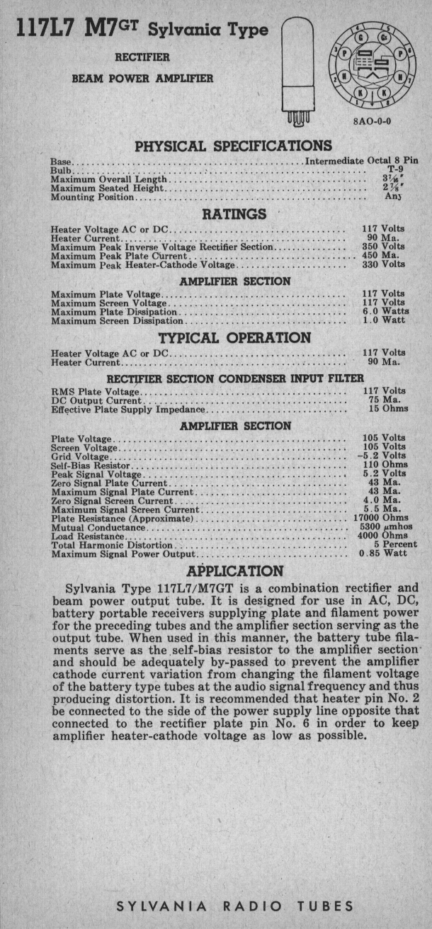

I wanted to double check that the tube basing (pinout) shown in the schematic is correct, and indeed it is, as verified here.. http://www.bunkerofdoom.com/tubes/sy...1949/117L7.GIF

Something else that bothers me a little is that I would not have though a pentode would work with its G2 at ground voltage. It's usually around 70 to 100% of the plate voltage. Being at 9V might cut the tube off? Or it's a way to keep the amount of RF power low?
Old 08-21-2011, 09:12 PM
Posts: 2,653
Yeah, i thought about that too. But figured that the cathode being at `near` ground (except for the coil resistance) probably mitigates for the absent G2 voltage a little. Then with both grids at the same potential, the tube behaves electrically more like it's a triode running at lower power than a full-up pentode. Or at least that sounds sorta plausible.
Got to looking at the 117L7's spec sheet posted earlier, and it's classed as a beam power amplifier. If that's correct, it's a tetrode with beam-forming plates and there would be no suppressor grid (G3) between G2 and the plate. So with G1 and G2 "strapped" at the same electrical potential, the tube would be running as a "beam triode".

The last two posts are way over my head, but I'll point out that G1 and G2 are -.8V and -.9V.

Hm. Possibly a bad tube. If the RF section of the tube is conducting, there should only be a very small fraction of a volt on pin 8, readable only on the lowest V scale on the meter. That's because the low resistance of the coil, only 10 ohms, will drop very little voltage at the current the tube pulls.
