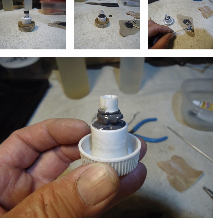

From Mike: “Hi Marshall. I am working on other small things while I am waiting for the new HV rectifier tubes. So, here are the images of my repair for the tone control knob. I believe that you have the volume/on/off and channel select knobs and they have been re-plated. Question: Are these knobs that I have here which are white in color supposed to be gold in color? This tone control knob looks like it was gold at one time. If so, I can shoot them with some paint to make them match. Let me know if you learn anything about that.
Photo #1 First step. Re-attaching the broken piece to the main part using JB Weld epoxy
Photo #2 The first “real” layer of epoxy over the repair.
Photo #3 I used electronic lacing tape (very strong stuff) , tightly tied around the previously broken part for added strength. Then added a second layer of epoxy.
Photo #4 Finished and ready to re-install the circular spring. Not real pretty, but likely won’t break again. And nobody sees this part.
The other white knob is for fine tuning and they will both be cleaned with a solution of dish soap and water using a small brush. There are two other knobs which are plastic and gold in color and may need polishing. I will be careful if I attempt to do so.

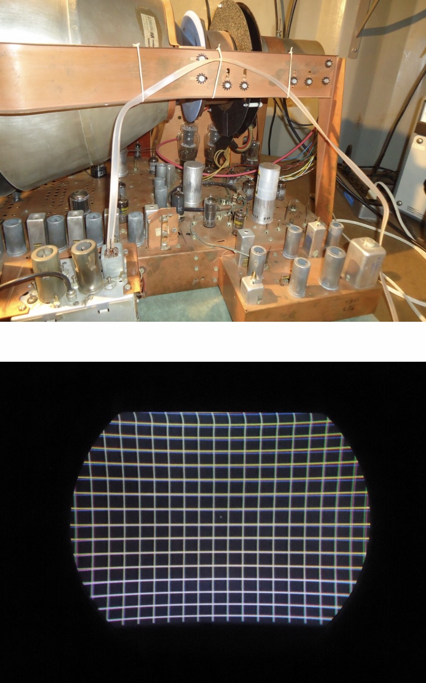

Update from Mike. You can see the problem with the convergence at the top of screen. We installed a hybrid VCT with average values for both the Westy and CT-100. The yellow band is a camera artifact.
UPDATE, SEPTEMBER 3, 2019, DAY 395
“I have been doing detail work. The 300 ohm twinlead that connects the tuner to the back cover was in very bad condition. I have replaced it and given it a path up and away from the chassis. This keeps frequency coupling issues to a minimum. Once again, I used electronic lacing tape to provide the strain relief. Also, a screen shot of the convergence. Still waiting for the new HV tubes. I believe they should arrive on Wednesday. I am a bit concerned with the lack of contrast at times. I will be replacing the video detector diode in the next report. This diode is buried inside a copper can.
Pix #1 The new 300 ohm twinlead path.
Pix #2 The screenshot of the convergence. Still issues with the blue.
Cheers, Mike”

My gut feeling is that convergence is going to be a compromise at best on these sets since they don't have all the separate adjustments of the later sets with magnetic convergence.
Erich Loepke

The convergence problem is at the top, so it won’t affect news banners typically displayed at the bottom of the screen. Our point, we believe the hybrid VCT may be why we can’t achieve “perfect” convergence.

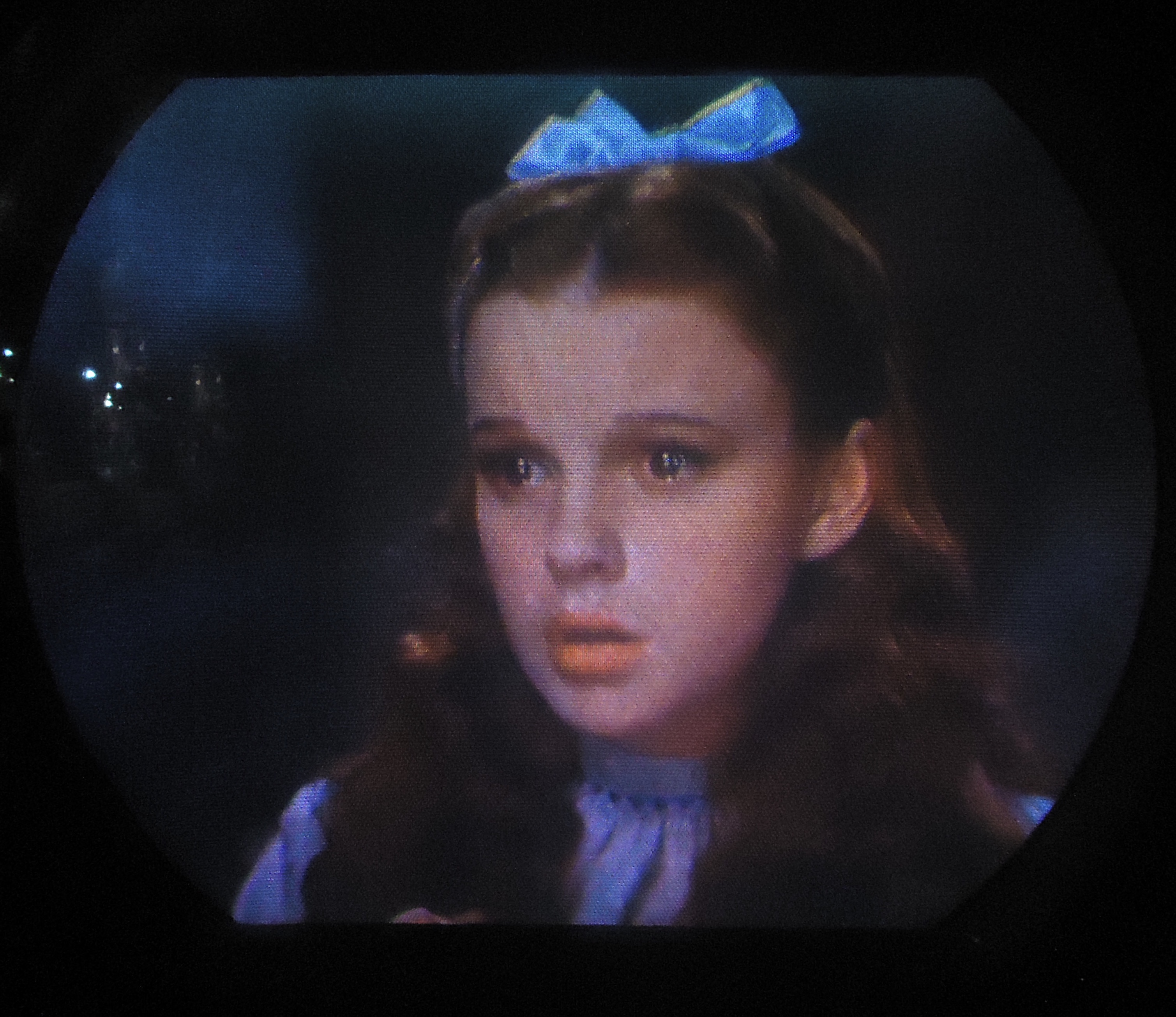

UPDATE, SEPTEMBER 7, 2019, DAY 399
From Mike: “We have contrast! I changed the cathode resistor in the first stage of video (12BY7). Factory specs calls for 56 ohm. I tried different values downward in ohms and I arrived at 39 ohms which is roughly half the original value. The contrast improved by about 20 % and it did not affect the high frequency response of the amplifier. I am real happy with this improvement. This essentially increases the current going through the tube. Not to worry, we are still way within the specs of the tube, and the contrast control is no longer all the way to its maximum position. We now have “room to spare”.
Pix #1 Oz 1
Pix #2 Oz 2
Enjoy!
I think we are now in the “cooking stage”.
Mike”
Author: Mike nailed it! Much improved from the previous screenshot. The colors are well balanced. Color, gray scale, geometry, focus and convergence are very good in this viewers opinion. I think this will be the last update for now, unless something comes up. We have to be concerned in transporting the monster chassis’s and CRT. Mike has to travel 12 miles on a dirt road from his ranch. SLOW is the key word. Can’t wait for this set to arrive home to me. Our restored cabinet is waiting.
