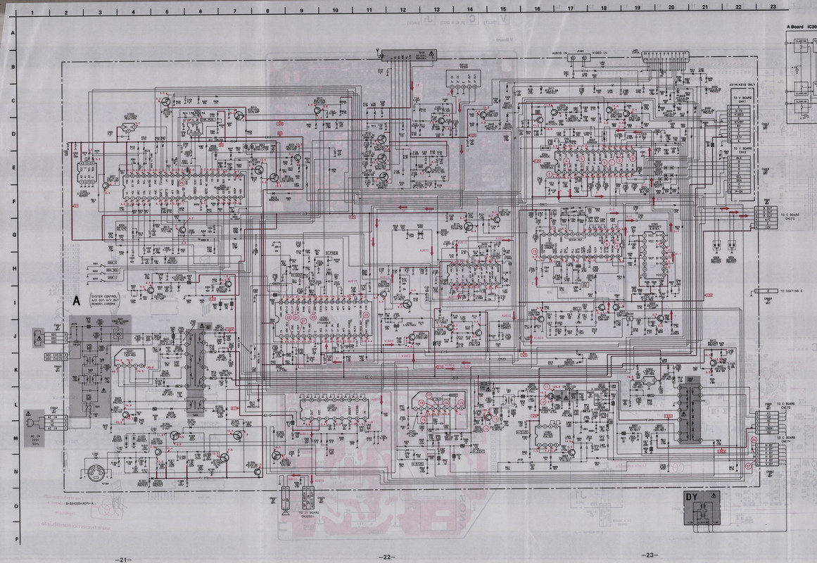

Hello everyone, a month ago the Trinitron kv-m1430a suddenly died, I use it to connect my old video game consoles, it has turned off and no longer shows signs of life, in fact the red standby LED is also off. 'I opened to try to understand what had happened to him and on sight there is nothing burnt, I started to do some measurements and first started from the fuse and it is ok, then I got to the 400 V 220 uf electrolytic capacitor and until there the voltages are present, then I went up to pin 3 of the transformer and they arrive 323 Volts, then to C 609 and from the diagram there should be 120 Volts but I can not find anything,
then I went to measure the voltages on the STR54041 which should be a voltage regulator and the measurements I made are all wrong, from what the diagram tells me.
Str54041
1: -17.2V
2: -17.2V
3: 187 V
4: -17.5V
5: -17.5
After various checks I managed to find a shorted component, D611 a zener R2M, I disassembled it, I gave voltage for a second and I saw that the TV led turned on, then I ordered a new R2M and replaced it , as soon as I switched on and blew the diode again. So I thought it might be the STR54041, I ordered the STR, I mounted it and just turned it on and immediately blew the 4 Amps main fuse, yesterday I reassembled the old STR and the original shorted diode to see if anything happened, as soon as I given voltage and jumped R601 from 3.3 ohm. I don't know what to do anymore, it's getting bad.😔
this is the electrical diagram
Old 02-20-2022, 09:15 AM
Be sure you are using the right ground. There is a hot ground
in primary & cold ground for secondary voltages.
If you can put up the power supply schematic alone I may
be able to help more, its to small to read.

Hi, I thank you, I replaced all the electrolytics on the primary , and since I found the diodes bridge so much to remove my doubt, then I managed to find on another circuit I also have resistance from 3.3ohm 10 w, but just current the resistance is jumped immediately, I tried to measure the heads of R601 and there are 240V, I can't understand, there is a short circuit somewhere that puts R601 in parallel to tension of network . Whether it's all the fault of the str, the strange and that only Zener D611 jumped at the beginning.
This scheme should be more detailed
https://drive.google.com/file/d/1BPc...ew?usp=sharing

Use the neg end of bridge for ground. It looks like they used cold ground
for the voltages !
R601 just to limit inrush current while big filter cap charges.
First be sure there are no shorts on the 3 secondaries The
120 V is most likely.
R602 & R607 give IC a kick start. If you dont get neg feedback to
that pin IC will blow. Open resistors will give "dead set"
R609 & R628 are the low end ( E ) of the IC's output. Over current will be seen here if a short on chassis & shut down the IC.
If IC isnt blowing you can monitor to see if IC is trying to start etc.
Unplug the DGS coil so it wont confuse you. Let us know how you do !
good luck
Zeno
