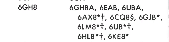

I recently got around to working on this old sears tv and have made some good progress. I have recaped the tv. The tv now makes a pretty watchable picture but the sound is still not working right. The sound is very staticy like it's tuneing in a very weak signal.
I need to test the following tubes 6gh8 detector amp-vert mult and 6hz6 audio detector. My tube tester is a knight 600B and I do have the books(manuals). I couldn't find these tubes listed in the books I have. So I'm stuck at the moment and if any one knows how I can tests these tubes in my tube tester it would be much appreciated.

For the tester get a tube substitution guide & see if any listed subs
are there & test it that way. May not be perfect but it should show
up a really bad tube.

6GH8's & their cousins #GH8 were probably the worst tube
ever built. Some RCA color sets used 5 of them & after a few
yrs they would be weak or leaky. Always suspect them !
Another tube checker tip. The first number of a tube is the filament
voltage. A 6GH8 is the same as a 5GH8 or a 4GH8. Just the filament
needs to be set to the proper voltage to test. You can also smoke out
a bad tube by turning up the filament one notch ( say from 6-7volts) this
can find leaky tubes that act up after the set runs a while & gets REAL hot
inside.
BTW You may be tempted to adjust the transformers in the audio. DOO NOT do
it unless you take precautions ! AND dont change disc caps. They almost
never go bad !

Let me guess, it was filled with those lousy grey oil filled caps that look like electrolytics?
Heres the subtitution numbers for 6GH8A. You might find something that matches up with your Knight.
There's a assortment of substitution books on World radio history in PDF format free for download.
Enter this in google to search them.
tube substitution site:worldradiohistory.com

I like how that old tube substitution book has the repeated typo of typing B instead of 8...6EAB is going to get a heck of a lot fewer search hits than 6EA8.

I wonder if it happened in the PDF searchable text conversion. I've seen errors like this before with certain styles of fonts.
I can't imagine Sams making such a error.

The tube tested shorted but with very good emission

It a tube tests shorted it isn't usually a good idea to go any further.
A short might damage the tester or at least throw off the emission test.
