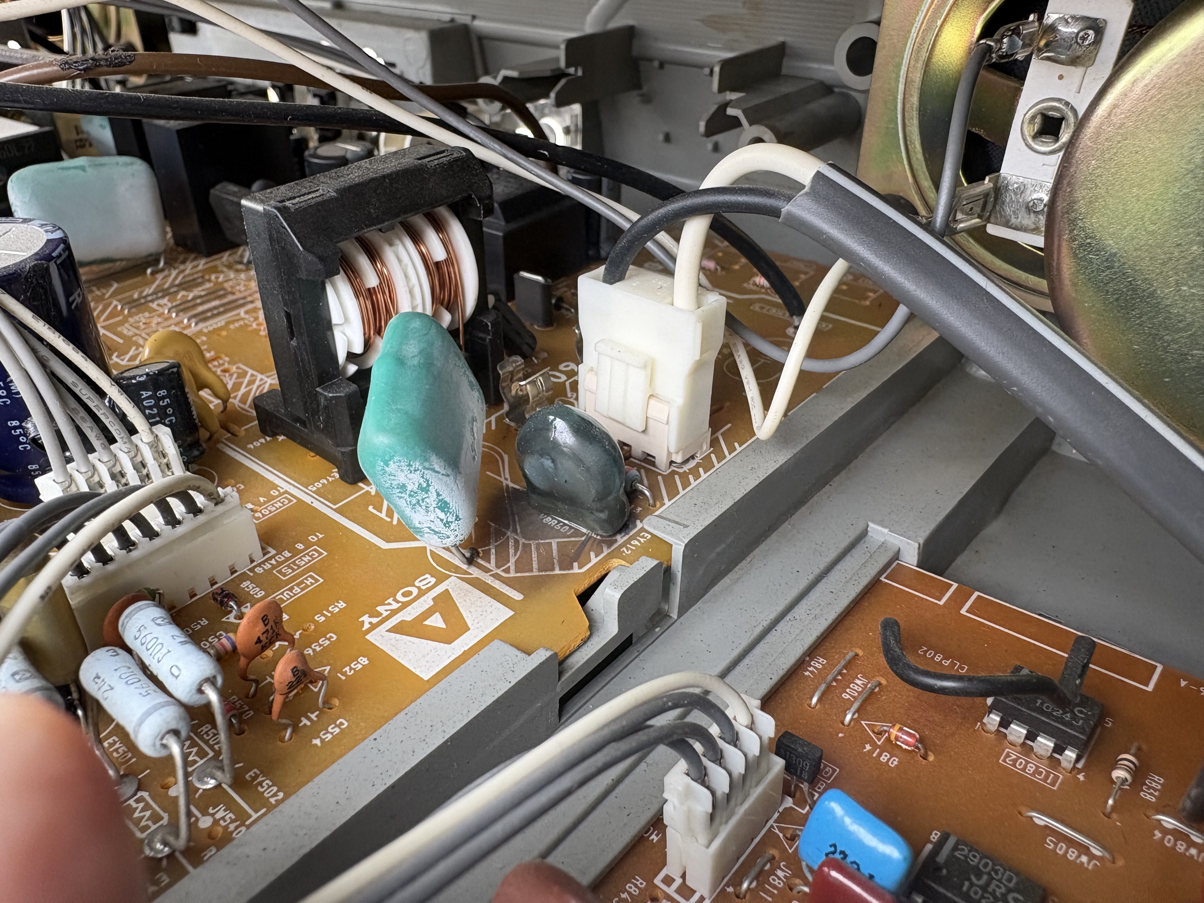

I've got a Sony KV-27FS17 that won't turn on. Looked inside and saw the 6.3A line fuse was blown.
The smoked out component as pictured below is probably why, probably dead shorted too. What is it? Thanks

That is a varistor. It's resistance varies with applied voltage. Protection thing. It will blow if excessive voltage is present on the primary side of the main power input.
If that's blown open, then I would suspect something else to blame.

Metal Oxide Varistor A.K.A. MOV.
Almost always from lightening. To test set just remove it & try set.
If you are lucky it did its job & saved the set. If not the sky
is the limit !

Varistor measures 35 ohms. But honestly if the fix isn't as easy as replacing that one component I'd rather give the set away for free, it's not very valuable in my eyes

The varistor used in this set is a ENE271D-10A from Fuji Electric
Will this part replace it?

Is not a very critical part, so a extra energy clamping capatibility will not harm, so is ok

Set works after replacing varistor and fuse
