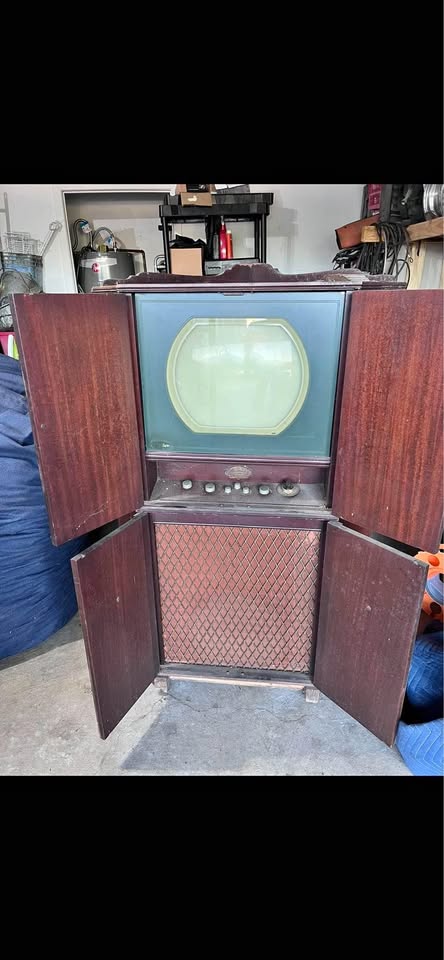

Yamamaya42 02-03-2025 08:07 PM

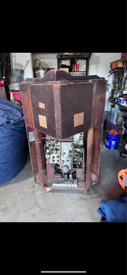

Rare find! A Magnavox Brittany tv!
http://suzaku.live-evil.org/46599495...62865189_n.jpg
http://suzaku.live-evil.org/46599767...43642247_n.jpg
I don't have it yet, but hope to in a couple weeks.
It's about 3.5 hours drive from here.
The ting seems in rough shape, but is worth saving.
Also taking a gamble on it as it MAY have a 16AP4, 16AP4A CRT on it, and we all know what they have a habit of doing! :tears:

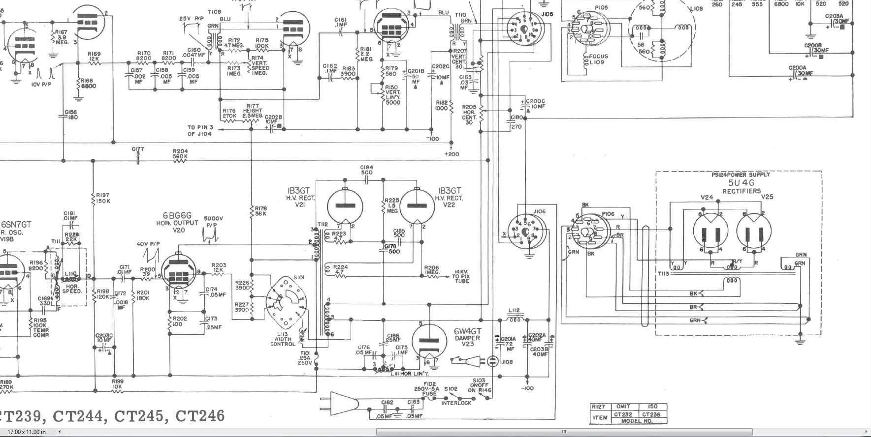

I managed to find service info on it, took a few tries, and it seems it;s a bit odd!
http://suzaku.live-evil.org/maggie-b.jpg
Have not seen dual HV rects before! :D
bandersen 02-06-2025 11:52 PM
Voltage doubler to get 14kV. What CRT does it use?
Yamamaya42 02-07-2025 06:44 AM
Says it has a 16AP4
http://suzaku.live-evil.org/93A-9.pdf
also seems to have a rca 630ts style voltage divider in it.
bandersen 02-07-2025 10:30 AM
OK, I asked because 14kV is the max for a 16AP4. Looks like they pushed it hard.
Yamamaya42 02-07-2025 10:45 AM
The more I look at the schematic, the more they seem to have borrowed from the early RCA sets, as it looks very familiar. :D
And they seem to be using a lot of 6SN7GTs :O
And it has AGC! :yes:

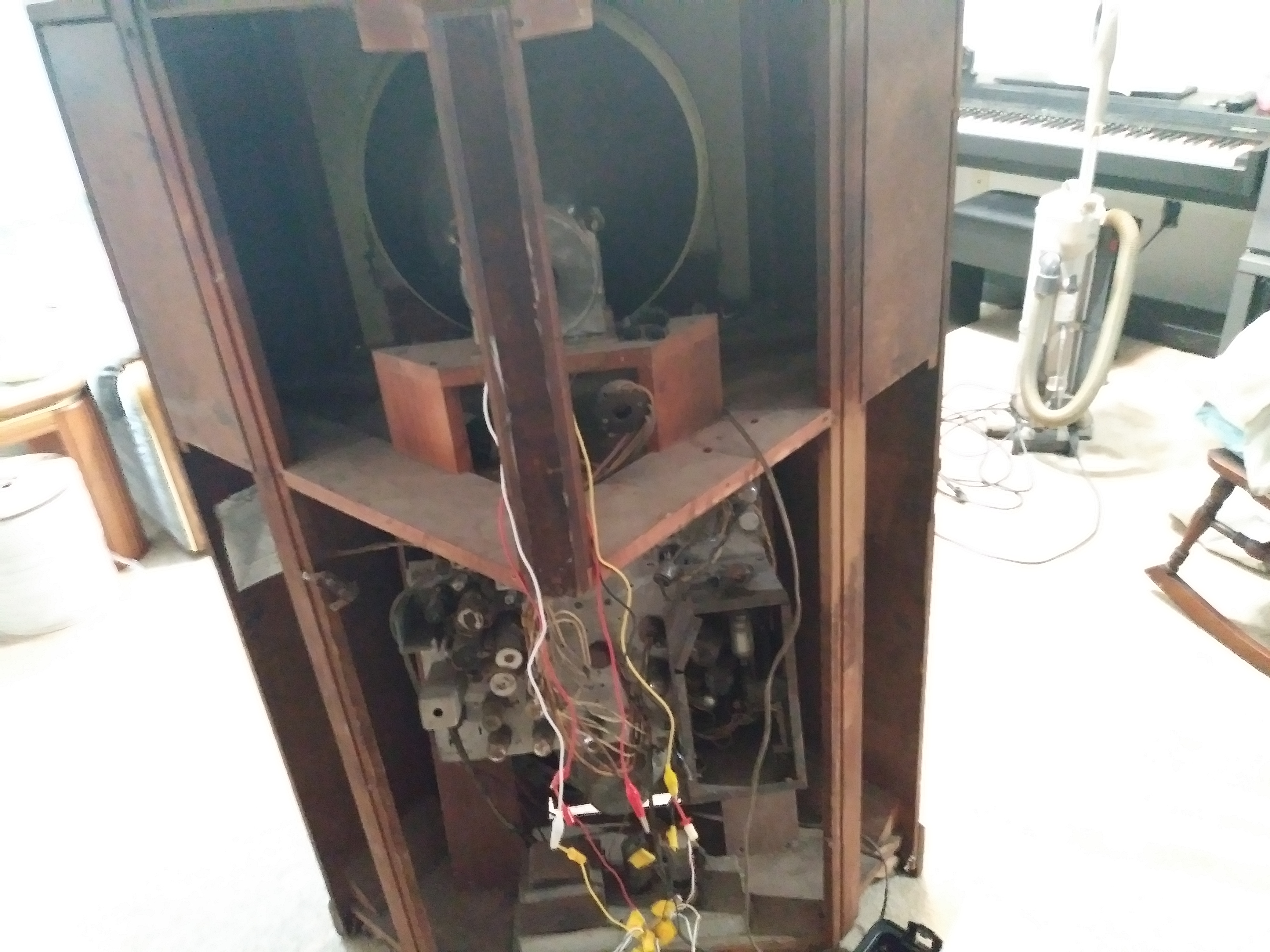

Well, was all set to go pick this set up this weekend, but something came up to delay it another week. :(
Looking at the schematic, this will be a real pain to fix, as I hinted, it has 5 6SN7GTs, NOT CHEAP if new are needed, and the lack of info so far, if any parts are needed, no info on the Vertical blocking oscillator transformer or output transformers, and the peaking coils also have no information about them, coils just say “white, black, green, yellow” no H value listed.
There may be a Magnavox service document out there someplace with more details, but I have yet to find it.

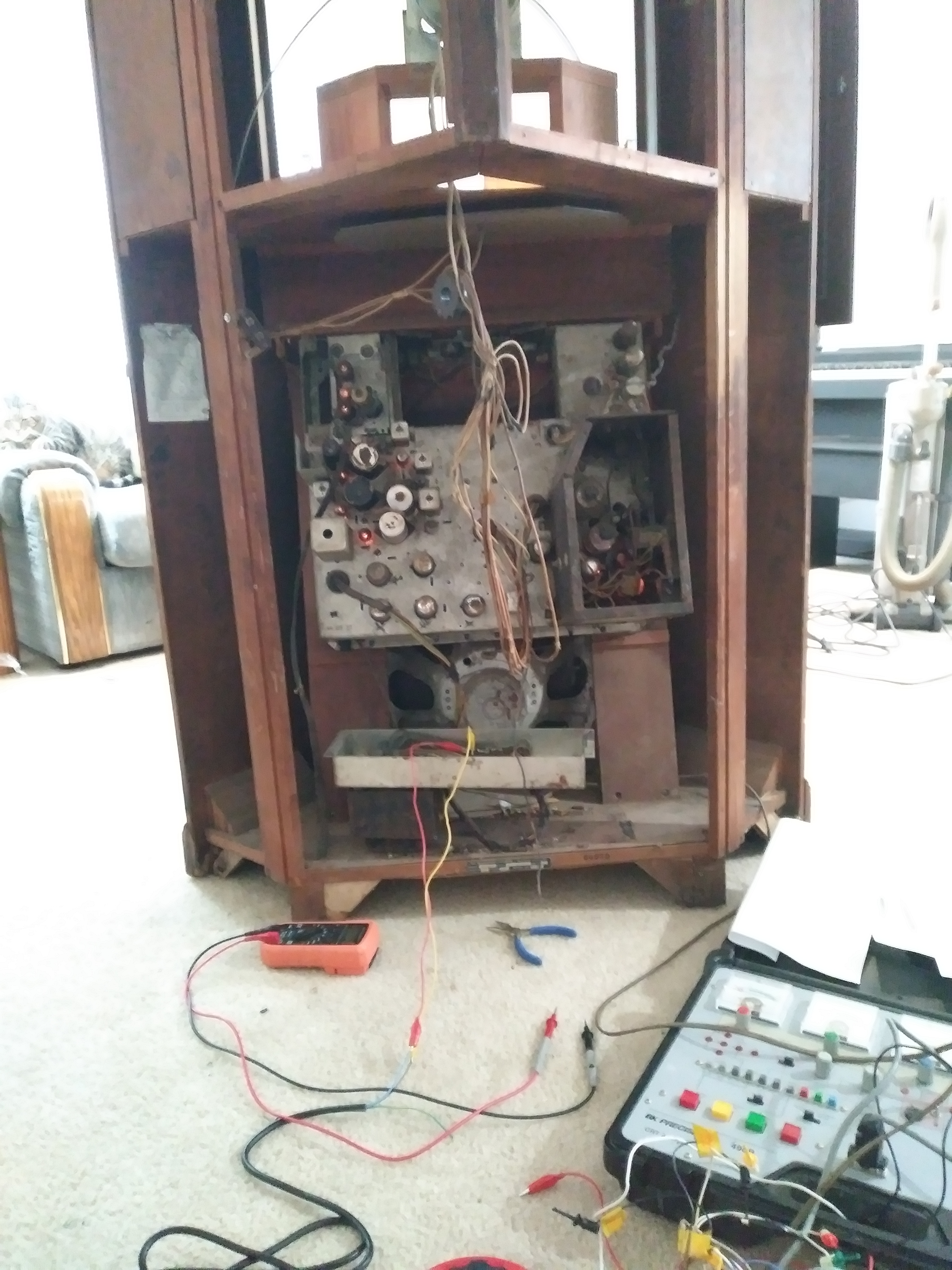

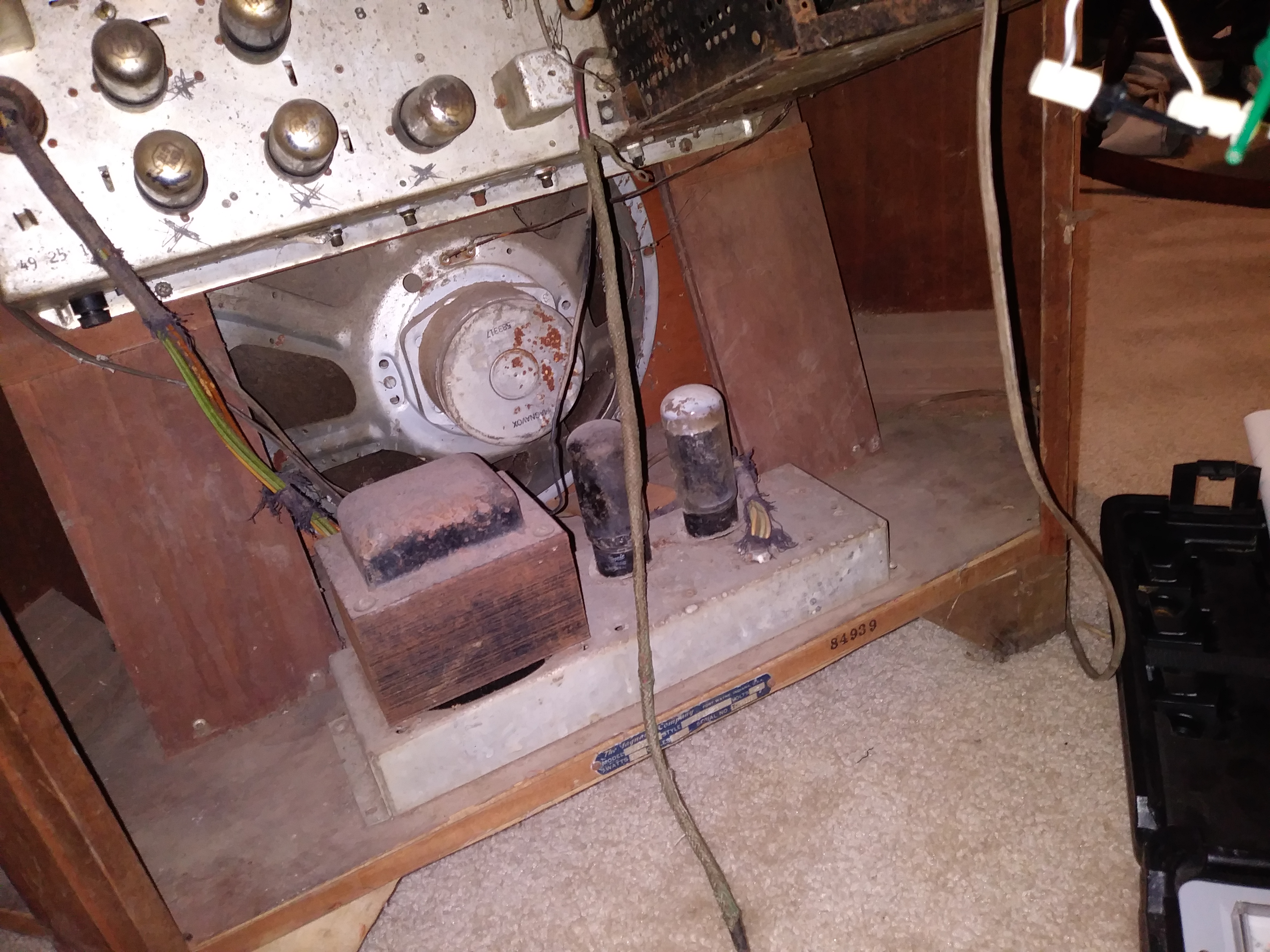

Yamamaya42 02-21-2025 03:34 PM
All seems set to go get it tomorrow, and the first thing I will do when I get it back, test the 16AP4. :drool: Will it be a paperweight? :O
Yamamaya42 02-23-2025 02:29 AM

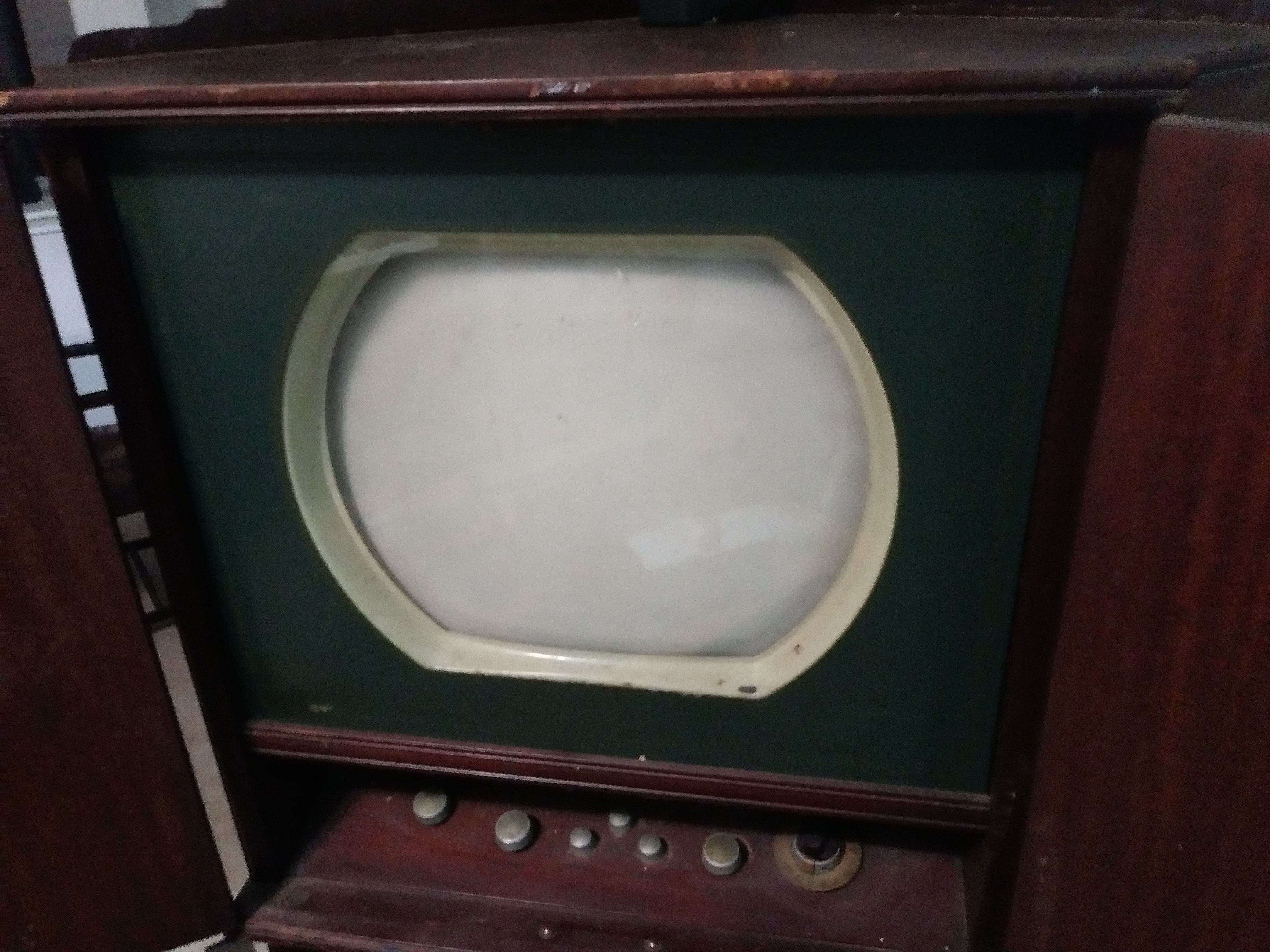

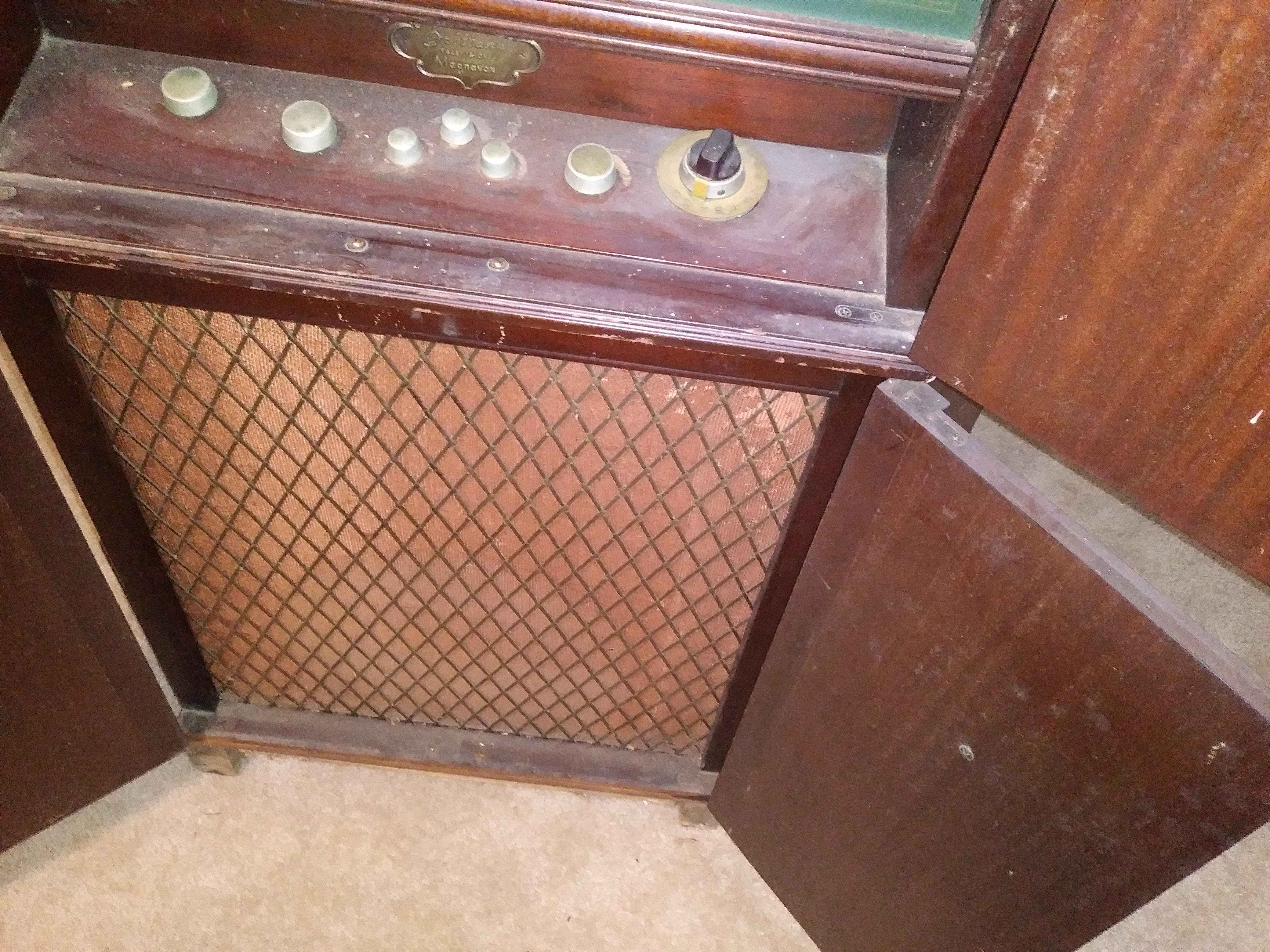

I got it!!! :banana:
http://suzaku.live-evil.org/0222251855.jpg front view
http://suzaku.live-evil.org/0222251855b.jpg LOOK! ALL THE KNOBS ARE THERE!
http://suzaku.live-evil.org/0222251855c.jpg Back view, someone stole the HV cover!
http://suzaku.live-evil.org/0222251914.jpg PWS, I dont think that one 5U4GB is good for some reason.

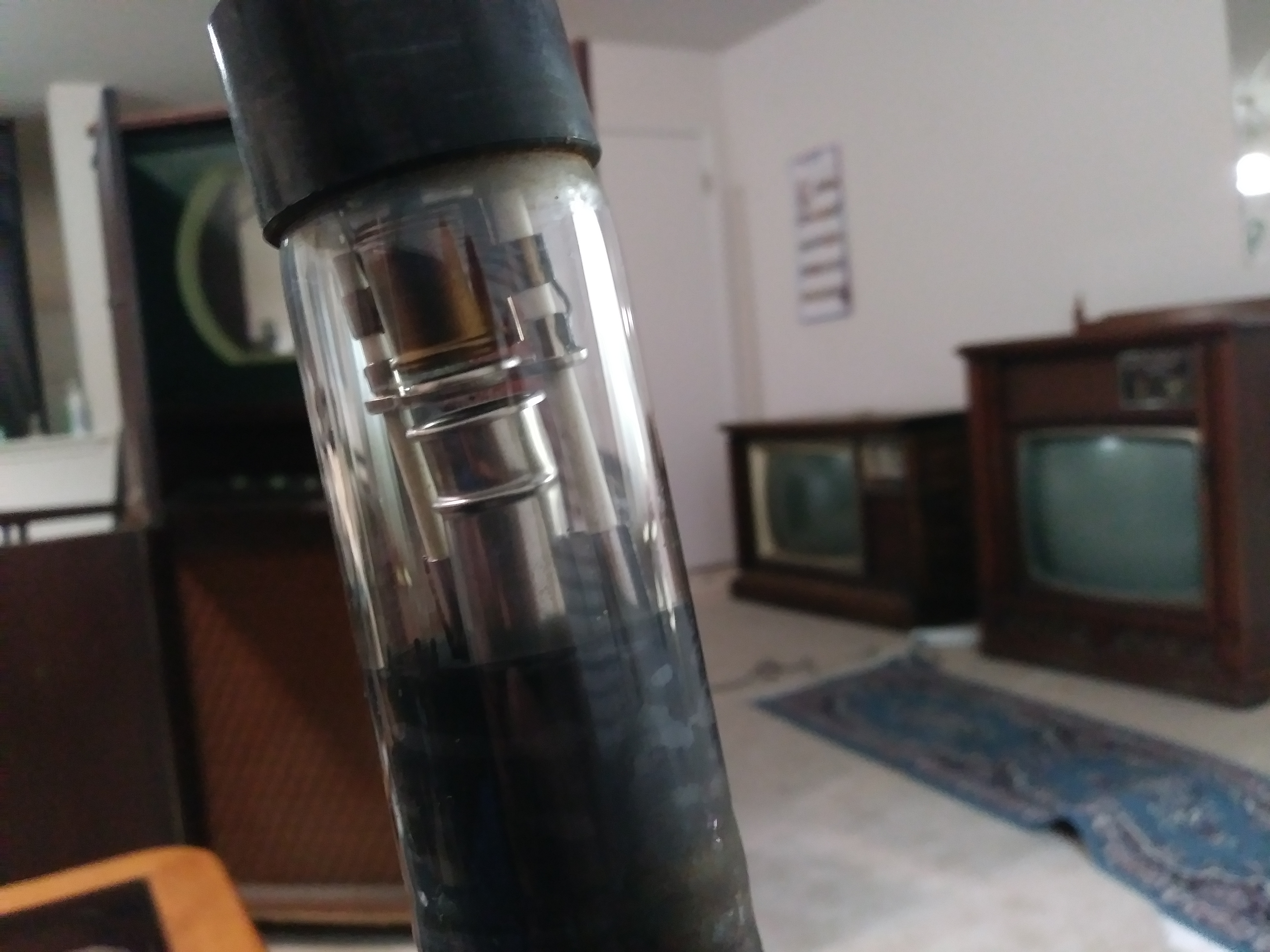

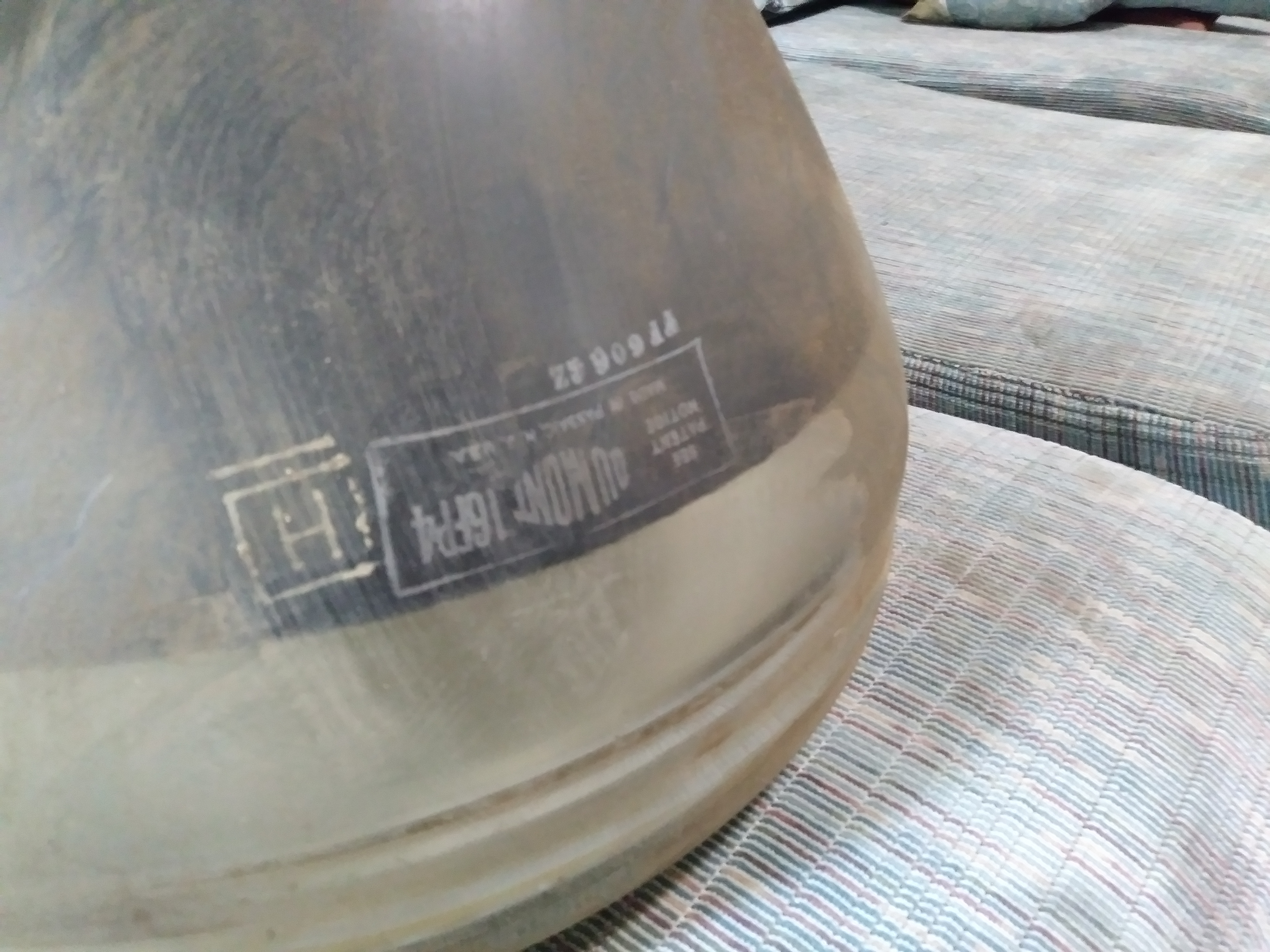

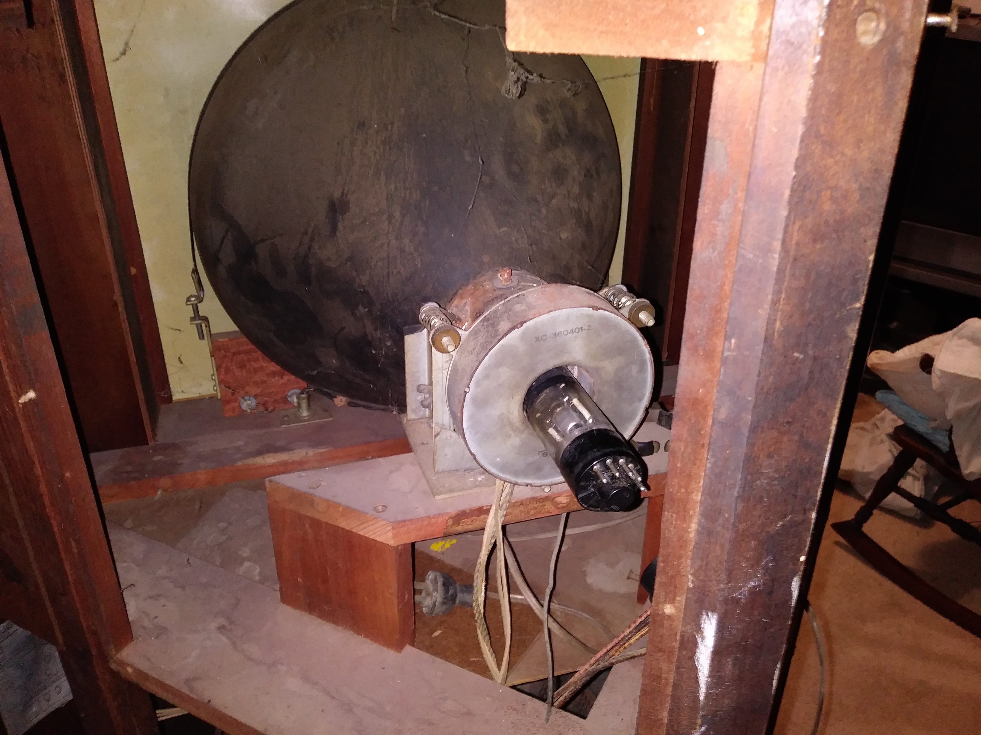

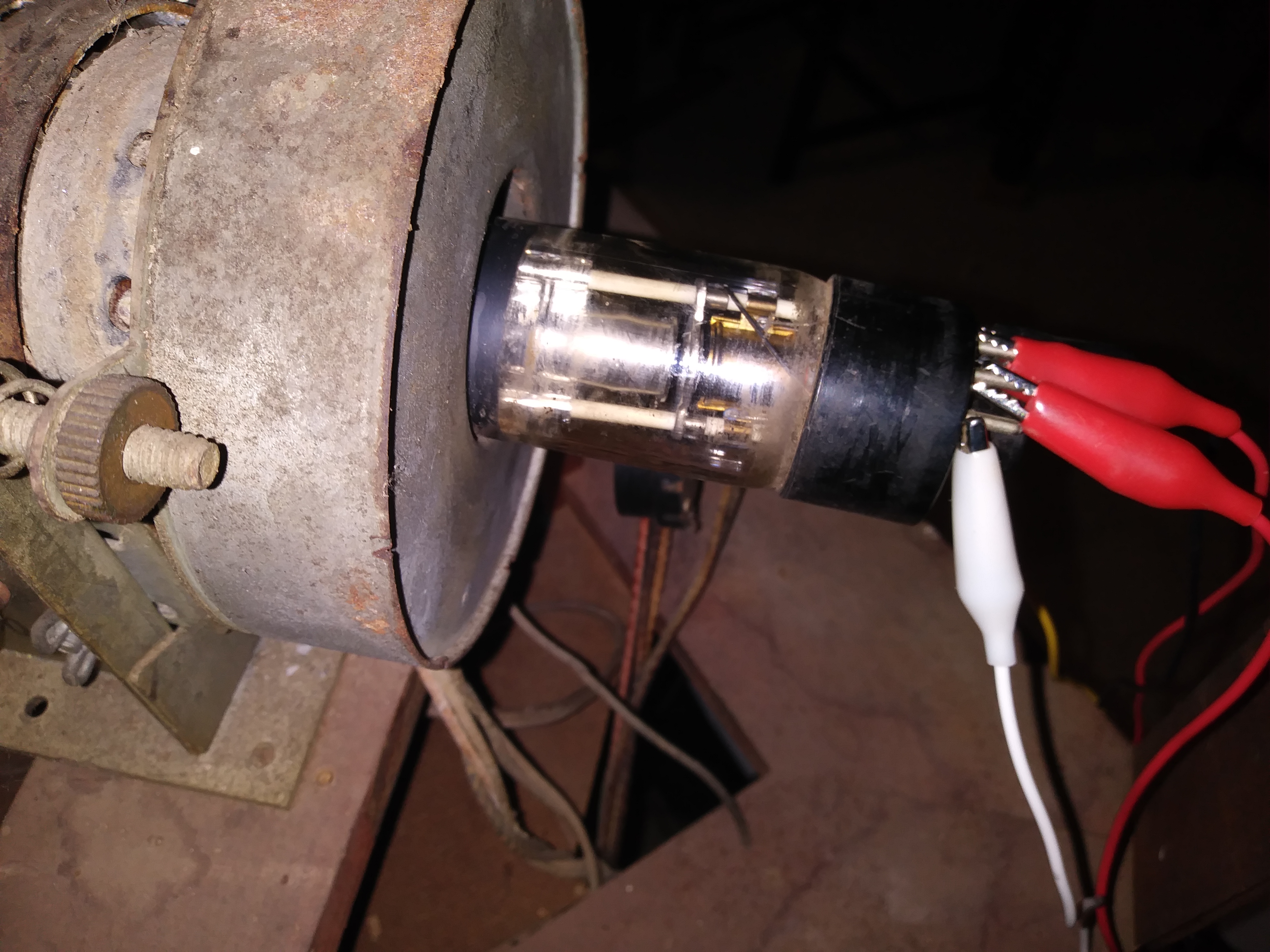

http://suzaku.live-evil.org/0222251837a.jpg :scratch2: um that's not a 16AP4, funny, it says 16AP4 on the chart!

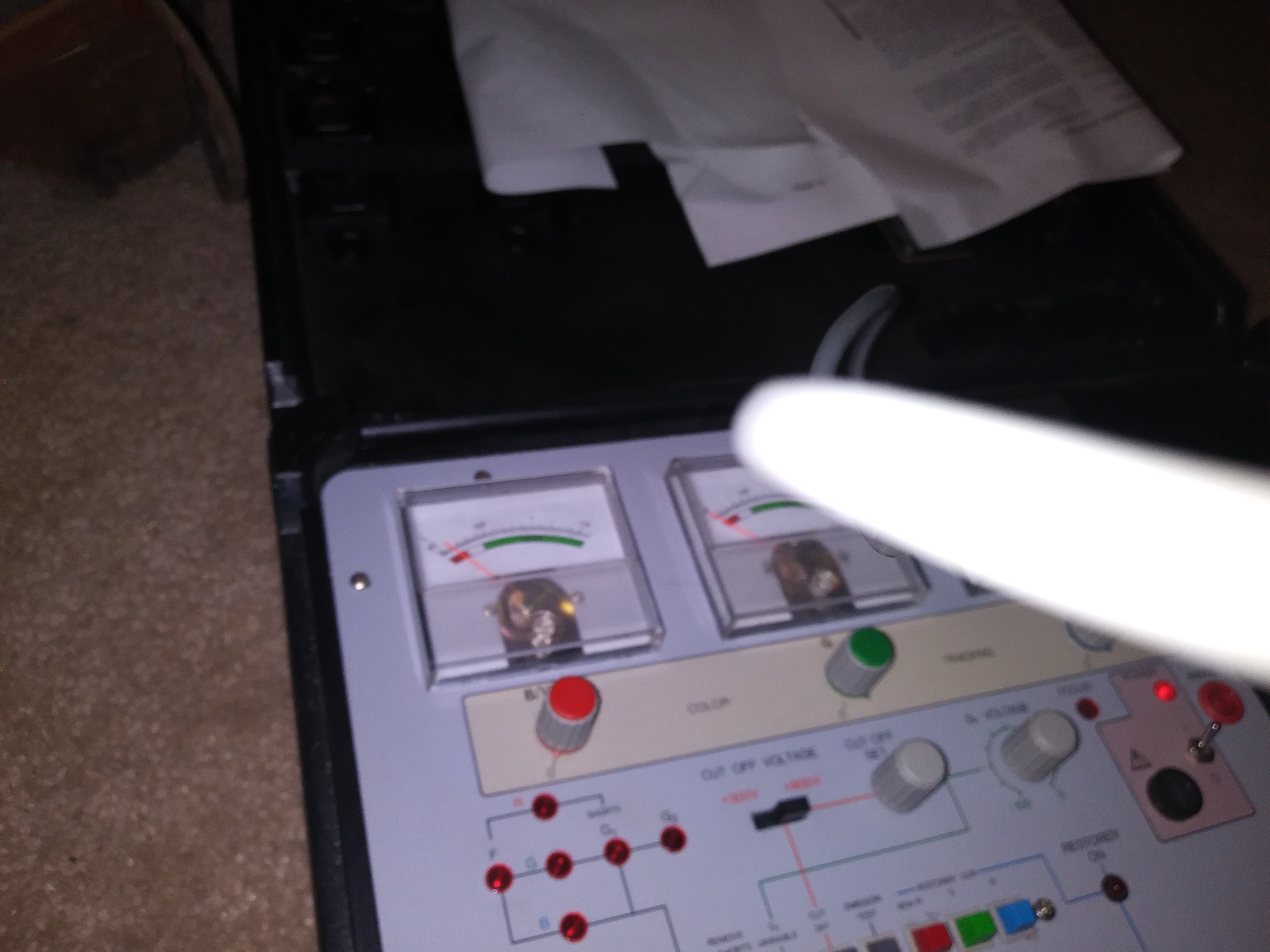

http://suzaku.live-evil.org/0222251913.jpg testing...
http://suzaku.live-evil.org/0222251913a.jpg DEAD! STONE DEAD! 20 min, wont wake up.:tears::tears:
http://suzaku.live-evil.org/0222251948.jpg COOKED!
http://suzaku.live-evil.org/0222251948a.jpg 16FP4
It's clear that thus is a replacement, and it too was run to death. the 16FP4 is almost an inch larger than the original tube it was made for and is oversized for the screen bezel that was in there, but was made to work.
https://tubedata.altanatubes.com.br/...27/1/16FP4.pdf
https://frank.pocnet.net/sheets/127/1/16AP4.pdf
Now i need to find SOMETHING i can make work in there again! :scratch2::sigh:

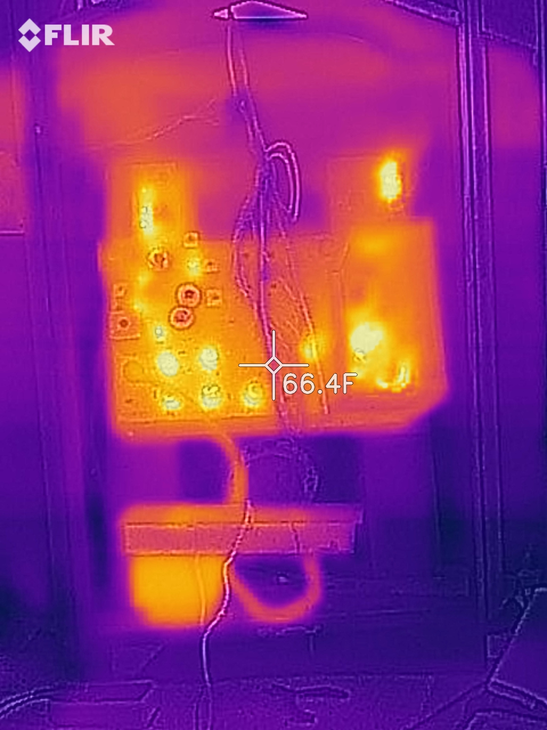

Yamamaya42 02-23-2025 01:37 PM
It wants to live!
http://suzaku.live-evil.org/0223251102a.jpg
http://suzaku.live-evil.org/flir_20250223T110141.jpg
power transformer is good!
5U4GBs removed, filament power only.
Could not get power from main cord to work bad switch or safety interlock not engaged correctly, hooked power direct to primary winding of the transformer.

Is there room to mount a rectangular CRT if you had to? Like a 17BP4?
Yamamaya42 02-23-2025 03:03 PM
Yes, if the glass and plastic bezel are off, there there is a very large space, but how easy is a 17BP4 to find?
ETF does have some 16L/CP4 tubes, which are rather close, and could be adapted if need be.
bandersen 02-23-2025 03:15 PM
Trivial, compared to a 16AP4. There are lots of other 17" rectangular CRTs too. Got one for $20 at the last swap meet.

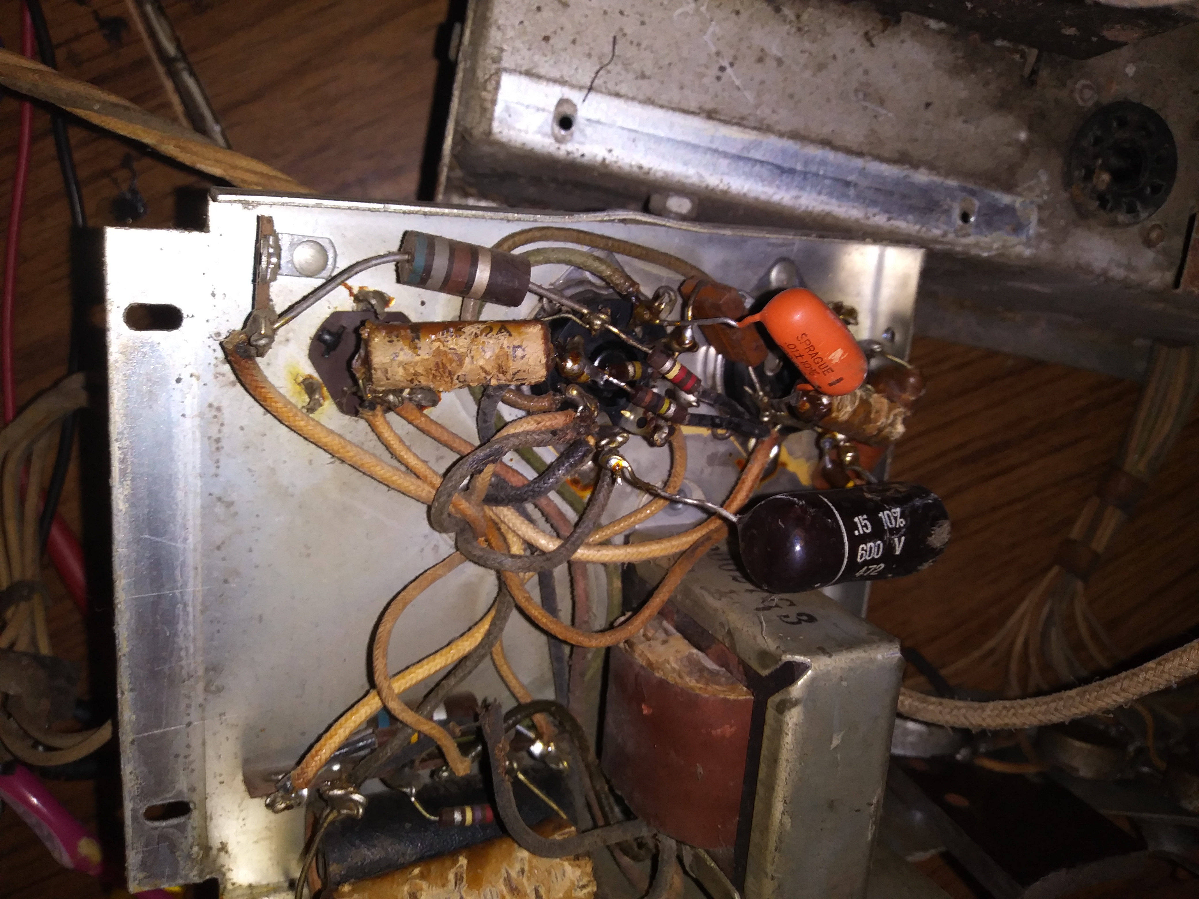

Yamamaya42 02-24-2025 09:56 AM

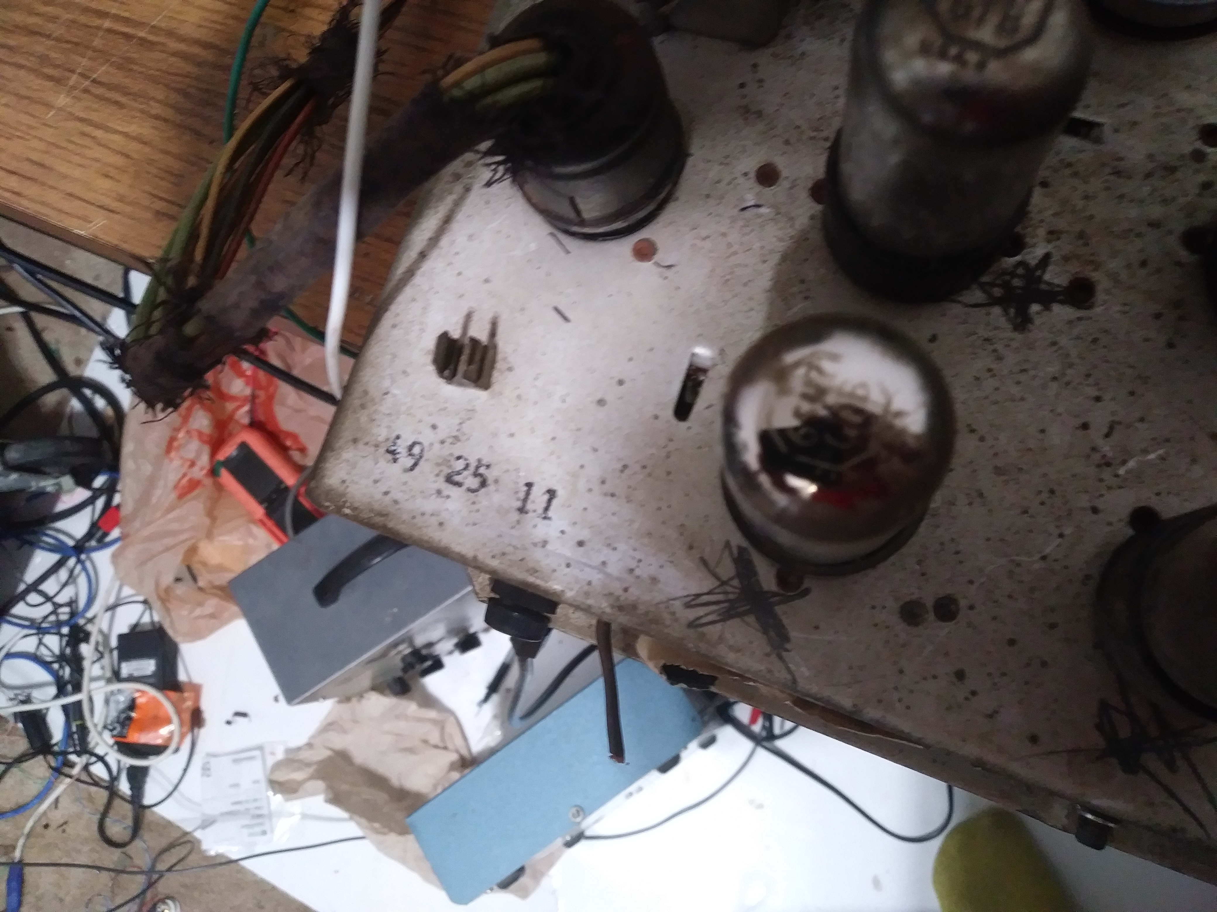

Chassis removed.
http://suzaku.live-evil.org/0223251338.jpg

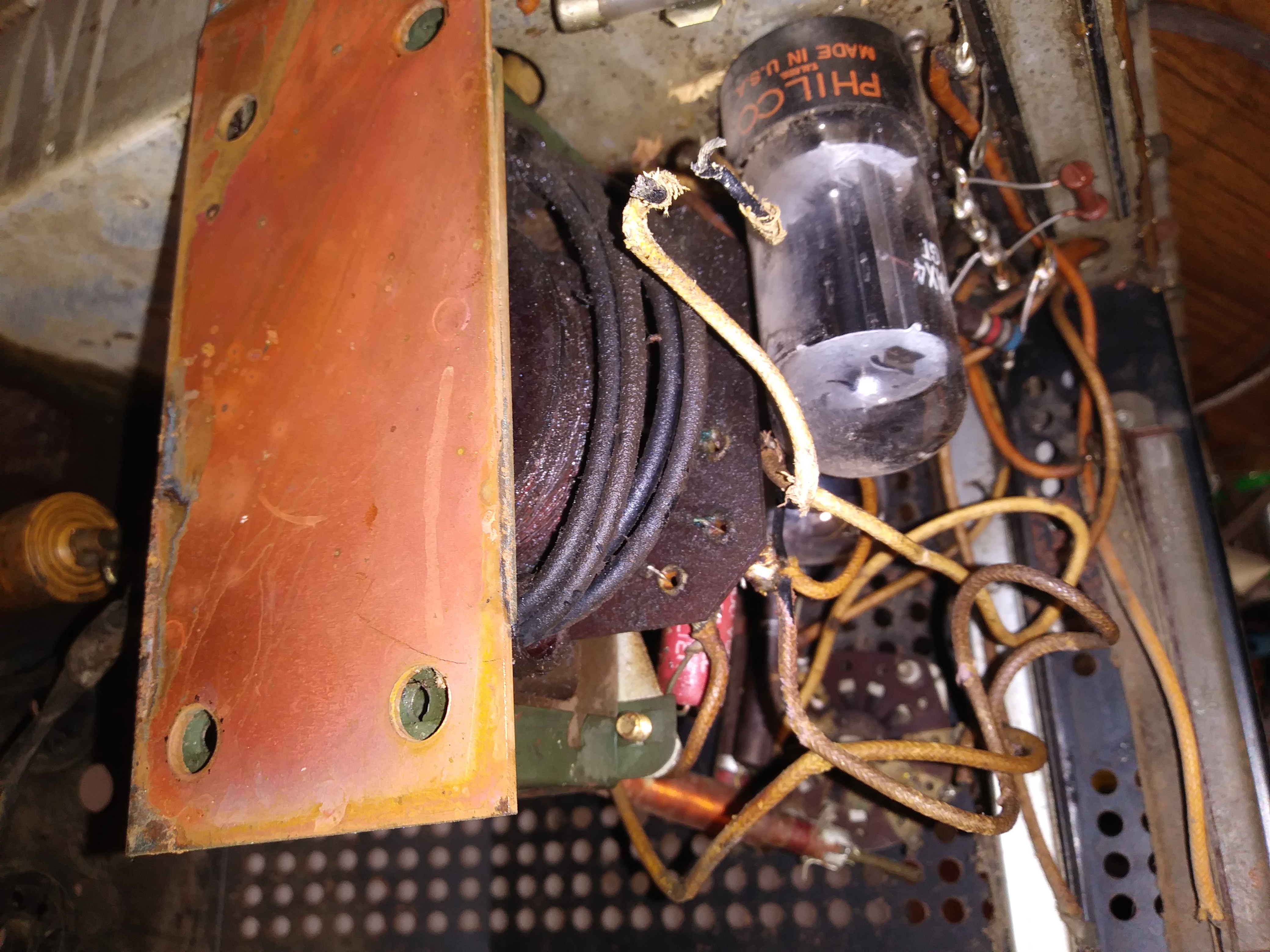

Looks like it's been worked on before, those orange drops are not original, the multi section capacitors are shot, looks like they got hot, one is bulged.
The filter choke looks awful, (L112), looks baked, dark enamel , exposed copper, seen on the lower left corner of the main section, it does not test open or short, but it looks toasted, as if C201A had shorted and overloaded it.
And since there is no type info for replacement that I can find yet, but this horizontal output section seems to be very close to the RCA 630TS, having the same pi filter feeding the damper, I tracked down the replacement shown in the SAMS for a RCA 630TS, (stancor c-2326) for $13, my guess that it's correct enough to work.
With that, does anyone know if there is any other service info on this set, other than the SAMS I found with just the schematic? Cause w/o a guide to what is what and where, it's gonna be a royal pain!
Thanks! :D
Kevin Kuehn 02-24-2025 04:02 PM
Don't forget the horizontal output transformer has two filament windings. 10 and 12" CRT varieties only used one. It's possible you could move the HV filament loops from your old flyback to a replacement, but there could be other subtle differences in the other windings. I wouldn't assume yours is bad until you get it operational. Have you figured out what this TV's model number is?

Yamamaya42 02-24-2025 08:18 PM
Got it! Tks! :D
that will help!
They seem to be missing a parts detail of the audio amp area. :(
Something has been chewing on the caps in that area:tears:

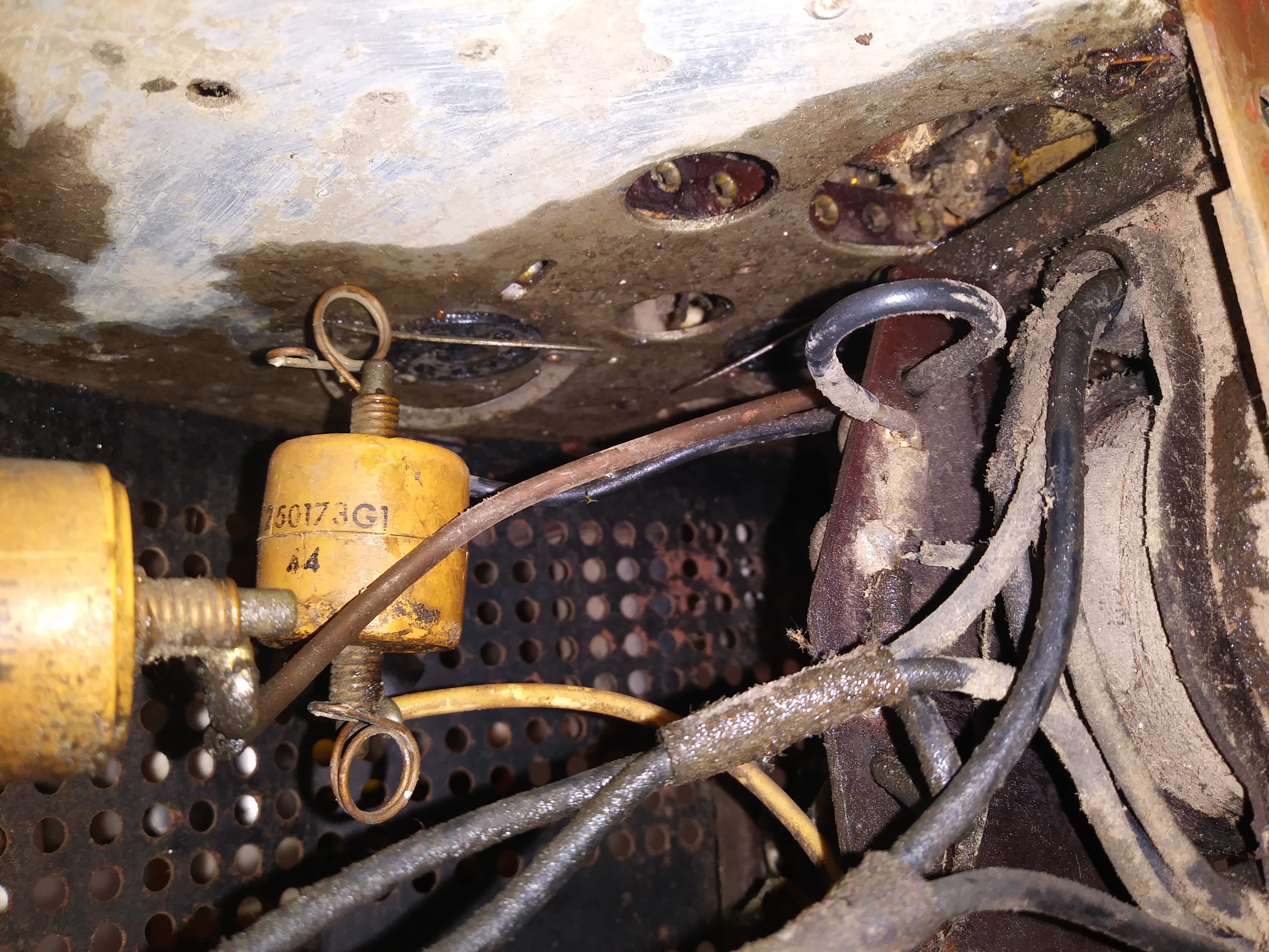

http://suzaku.live-evil.org/0224251601a.jpg
sad looking filter
http://suzaku.live-evil.org/0224251603d.jpg
bad caps
http://suzaku.live-evil.org/0224251603c.jpg
FBT
Wire broke off when i removed the cap from the tube
any way you can get a more detailed shot of page 6-4? focusing in on the chassis detail and not so much the text? cause when you zoom in, it gets fuzzy and it;s hard to make out the numbers, TKS ! :D

Yamamaya42 02-25-2025 11:14 AM
Any opinions on that crappy looking filter coil? :(
Kevin Kuehn 02-25-2025 11:53 AM

Kevin Kuehn 02-25-2025 12:14 PM
If it works brush some polyurethane on for additional insulation and wrap paper around it for appearance.

old_coot88 02-25-2025 03:54 PM
Have you ohmed it? Prolly be a few hundred ohms if good. If there's no leakage to the frame, it may be OK.
Yamamaya42 02-25-2025 04:05 PM
53ohms, ish, I have not done a leakage test on it yet, I will when I remove it to try to coat the windings.
old_coot88 02-25-2025 05:13 PM
Maybe the collective wisdom on the group can say if the resistance sounds right. I don't recollect ever actually measuring a filter choke. They seemed to be among the least failure-prone components.
bandersen 02-25-2025 09:08 PM
53 ohms sounds perfectly reasonable and it looks OK. Moisture, critters or time probably caused the paper covering to fall off.

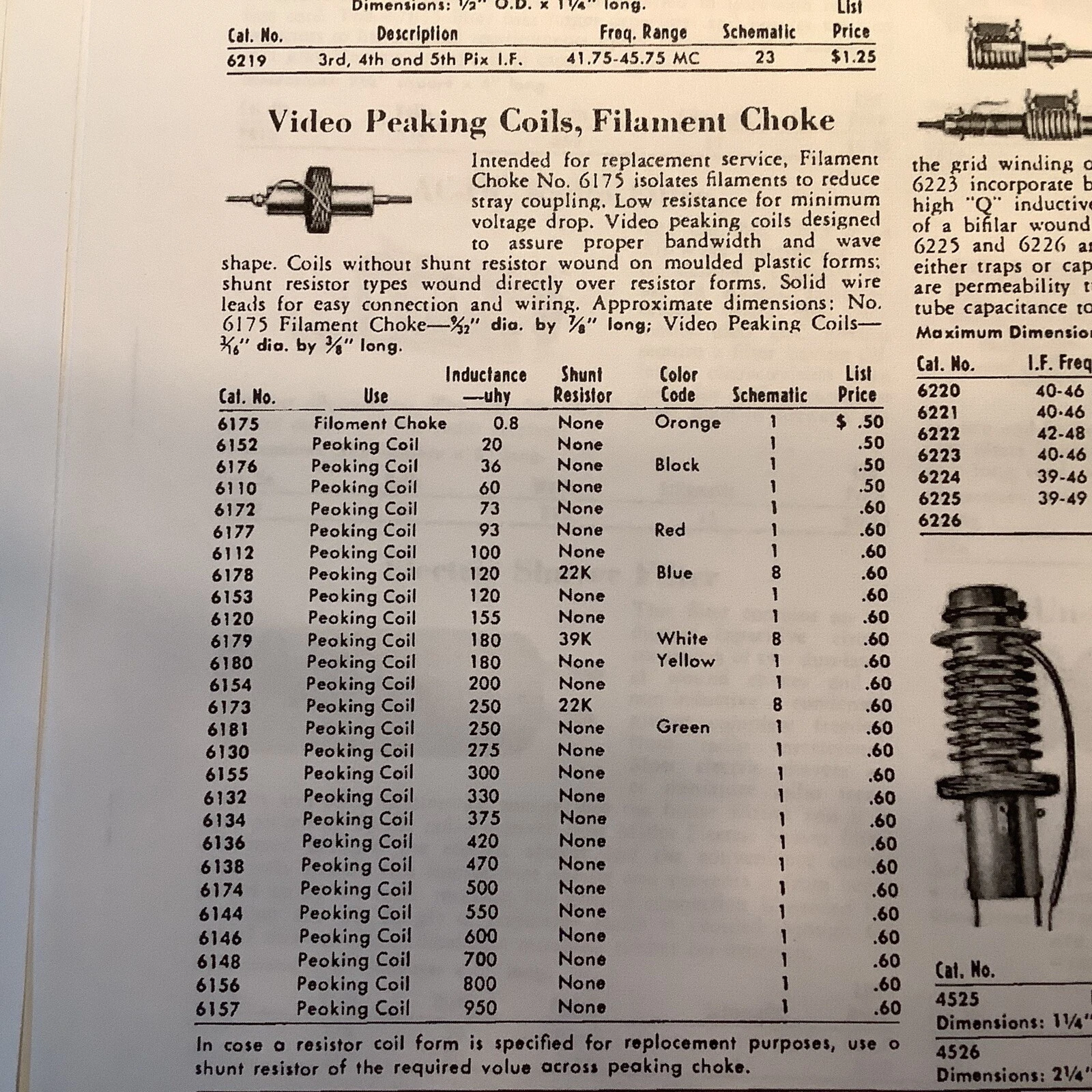

Yamamaya42 02-25-2025 11:53 PM
Well, If I do need peaking coils, this prob is the key! :D

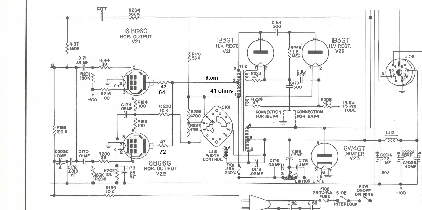

Yamamaya42 02-26-2025 08:20 PM
more photos of the FBT area
http://suzaku.live-evil.org/0226251827a.jpg
http://suzaku.live-evil.org/0226251827.jpg
http://suzaku.live-evil.org/0226251827b.jpg
http://suzaku.live-evil.org/flyback.jpg
took some measurements, perhaps its good, but the resistors are bad!
R225 is not there at all!
I'm not sure what the FBT should test at, so I hope it's OK! :D
but the wires are no good. falling apart!
http://suzaku.live-evil.org/0226251831.jpg
the chewed audio section.
bandersen 02-26-2025 08:32 PM
Is that 6.5 Megaohms? If so, that's bad. Should be around 200-300 ohms
Yamamaya42 02-26-2025 10:01 PM
i need a FBT then :( 320035-1
