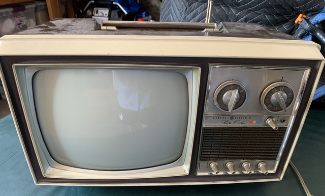

LukeSimon 07-15-2021 04:03 PM
GE Porta Color: need help identifying chassis / model
I got a GE Porta Color pictured below, and I want to correctly identify the chassis and if possible, also the model. I want to make sure I get the correct Photofacts because I am not skilled enough to do restorations without a service manual or Photofacts.
I can see that there was considerable variation in the faceplate of the Porta Colors, but it is not clear to me how much these TVs vary on the inside. The specimen that I acquired lost the label on the back of it. Is there something to look for on the inside that is useful for identifying the model or chassis? Is the faceplate useful at all for identification? The faceplate looks similar, but not identical to the WM203HWD4. My specimen as round knobs for things like color and tint, versus the flat knobs that the WM203HWD4 uses.

GE produced that set in different variations for about ten years.
Yours looks like one of the earlier models. You have to remove the cover and look for the tube location diagram. The chassis numbers are something like HB, HC, HD and HE with possibly a suffix number.
There's a great deal of difference of the earlier to the later models.
See if you could furnish a picture of the inner view.

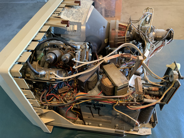

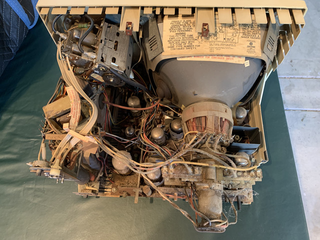

I had some free time this weekend, so I opened up the Porta Color. I find these non-solid state TVs breathtakingly beautiful on the inside when compared to a solid state TV. A solid state TV is like a quartz clock's insides, whereas a tube TV is like a mechanical clock.
https://i.ibb.co/HnZny1J/image0-12.jpg
https://i.ibb.co/wSf75T1/image2-6.jpg
https://i.ibb.co/KFFYzHM/image1-10.jpg
Next weekend, I will use compressed air and soft paint brushes to slowly work away the dust, filth, and grime like an archaeologist using brushes to slowly unearth ancient artifacts.
https://i.ibb.co/QHLn79s/image4-1.jpg

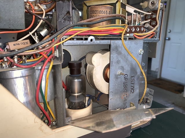

This is the flyback transformer and ultor rectifier diode. Being a budget-grade TV, there is no high voltage regulator, no voltage multiplier either. That would take up space and cost more money.
https://i.ibb.co/MpFGKLV/image5-1.jpg

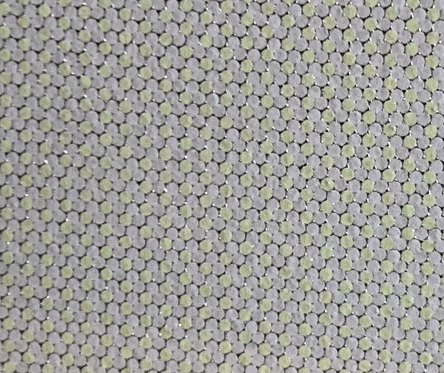

This is a magnified view of the face of the CRT. It is the more fine grained dot mask type, versus the more coarse grained slot mask type. I will hook this up to my BK 490b CRT Tester to see how it has aged.
https://i.ibb.co/bdt5RPr/image0-13.jpg

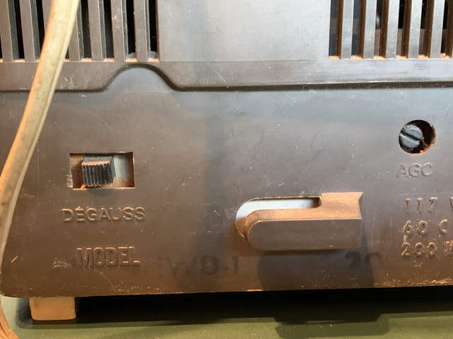

The model number was once stamped, in ink, on the back of the TV. I think I can make out the suffix of the model number "HWD-1", but the prefix is not visible. Maybe a blacklight would help?
https://i.ibb.co/ypXgbM4/image3-3.jpg

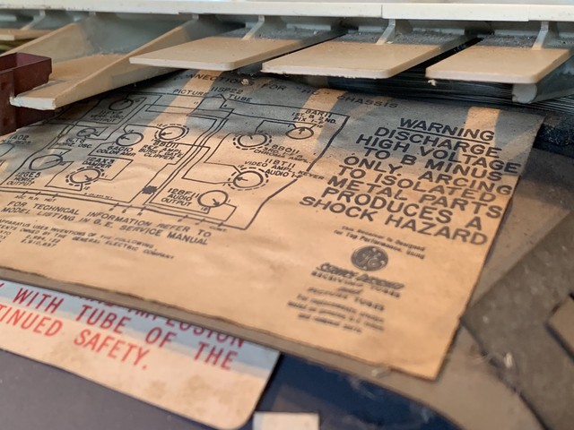

The tube heater schematic label inside the TV says that it is an "HC" chassis, and the CRT is 11SP22.
Does anybody have the Photofacts for an HC chassis GE Porta Color? For TVs this old, since new capacitors are still being manufactured, I prefer to replace all electrolytic capacitors, paper capacitors, and oil capacitors. I try to keep the original tubes since they are not getting manufactured anymore, so it is wasteful to just throw away the original tubes. However, I do like to order a spare for each tube.
So I need more than just the Photofacts schematic. I also need the parts list, where the Photofacts clearly enumerates the different types of capacitors, and also shows a photo of where to find them in the chassis.

That's a really early model, probably the second or third year of production!
I have the last model that used the low focus volts CRT, a 11WP22, which was an improvement over the SP. It uses a few different, later version tubes.
It uses a heftier HO tube. It's an HD chassis, CA 1974 or so.
The HE chassis is the last tube chassis. It uses the HI-focus volts CRT. The code dates are either from 1977 or 78, so it was built that late. :thmbsp:
LukeSimon 07-18-2021 07:04 PM
I was able to use a blacklight to make the full model number visible. It is "M244HWD-1".

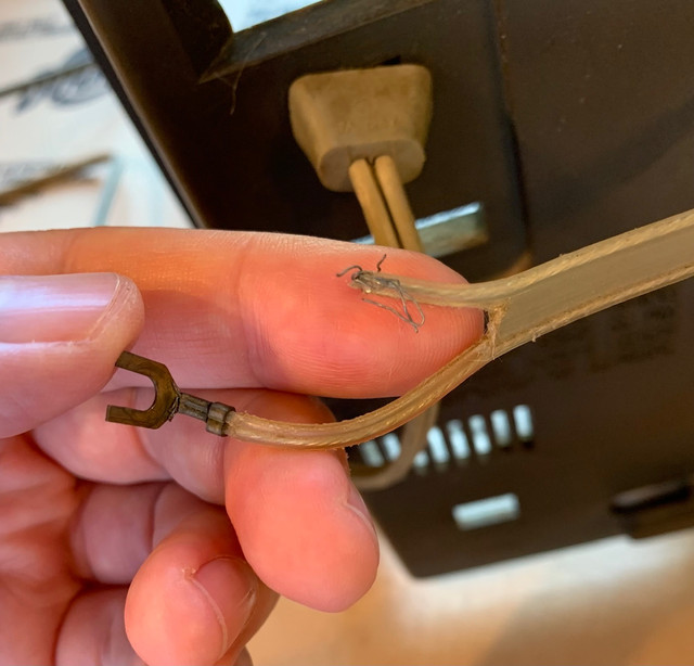

Question #2: One of the previous owners of this TV ripped the spade lug off of the dipole antenna's wires. The wire length is about 6 inches, and the shortest replacement wires I can find online are 5 feet long! Any idea where I can find a replacement part?
https://i.ibb.co/swpd94W/image1-11.jpg

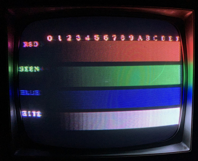

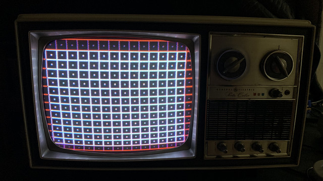

This grid test pattern shows 2 issues. Vertical linearity near the bottom is a bit squished, I need to spend some time playing with the pot for vertical linearity before asking questions about this. Question #3: The red border of the test pattern is a bit purple at the top and bottom of the picture. The left and right red borders have the proper red color. Is this a color purity issue or a convergence issue?
https://i.ibb.co/wpVPcx3/image0-15.jpg
This color bars test pattern is great for tuning brightness and contrast for each color. Question #4: If you zoom in to the letters for the words "RED" and "GREEN", you can see ghosting to the right of the letters "D" and "N". However, the letter "E" in the word "BLUE" does not have ghosting. The letters and numbers of the columns at the top of the picture also have similar ghosting. What is the potential cause of this? What should I try/investigate to fix this?
Question #5: If you zoom into the red color bar in the area between columns "6" and "7" you can see a dead phosphor triad. Is this repairable? Another dead phosphor triad can be seen in the red color bar in the area between the columns "A" and "B". I have heard of burned up bits of cathode flaking off and shorting the electron gun. Is it possible some burned bits of cathode have flaked off and blocked the cathode ray from hitting a few phosphor triads?
Question #6: The high amounts of "cooked" dust and filth inside the TV, the fact that vacuum tubes have been replaced decades ago, and the cosmetic wear and tear to the outside of the chassis all indicate that this TV has been heavily used. So why does the CRT still output such a strong "bright" picture? Is the CRT model used in these known to have a very long life? I have seen many CRT TVs from the 1990s that have "gone dim" due to heavy usage.
old_tv_nut 07-25-2021 05:48 PM
"Question #3: The red border of the test pattern is a bit purple at the top and bottom of the picture. The left and right red borders have the proper red color. Is this a color purity issue or a convergence issue?"
This may just be a normal limitation of chroma bandwidth. Those vertical red stripes are far too narrow to be resolved fully by the color-difference signals.
old_tv_nut 07-25-2021 05:55 PM
"Question #4: If you zoom in to the letters for the words "RED" and "GREEN", you can see ghosting to the right of the letters "D" and "N". However, the letter "E" in the word "BLUE" does not have ghosting. The letters and numbers of the columns at the top of the picture also have similar ghosting. What is the potential cause of this? What should I try/investigate to fix this?"
May be a bit of delay line ringing, chroma trap ringing, or what have you.
1) I would not obsess over this until having viewed a variety of general material. Test patterns sometimes make visible small issues that aren't a problem in general use.
2) My guess is it's in the luminance channel and is there on blue as well as red and green, but is invisible on blue because of its lower luminance value.

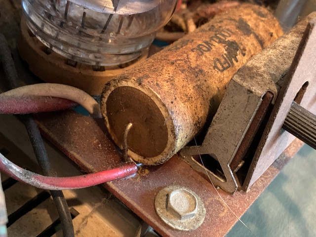

Question #7: I used a soft, dry paint brush and compressed air to slowly clean away the filth inside the TV, and visual inspection makes me concerned about only one part, capacitor C67, which is one of the boosted B+ capacitors:
https://i.ibb.co/9wjJ2c3/image1-12.jpg
https://i.ibb.co/61qd3RQ/image0-16.jpg
https://i.ibb.co/FqWjP57/Screen-Shot...6-15-47-PM.png
I haven't tested this capacitor with an ESR or capacitance meter yet, but it looks like it has leaked a dark waxy substance that does not wipe away with a paint brush. I may be falsely accusing this capacitor. A previous owner may have poured Coca Cola into this TV for all I know. The other non-solid state TV that I have (a black and white Panasonic AN-72), uses an oil type capacitor for the boosted B+ capacitor. So I am guessing that the Portacolor also uses an oil type capacitor. Since the capacitor is sitting right next to the horizontal output tube and the capacitor has to handle a 15khz ripple current, it wouldn't shock me if it has to live with a very high temperature. Does this capacitor look like it has leaked its oil dielectric?
If the ESR and capacitance meets spec, should I be concerned about this capacitor?

Questions 1 and 2. If you have the back open change those white caps! They can fail at the drop of a hat even if they test good, and when they fail they spray conductive foil everywhere that can short other stuff and increase collateral damage.
You can buy the spade end crimp connectors from any hardware store. What I'd do is strip the one wire and solder on a crimp connector.

I will use calipers to measure the dimensions of the white caps and order polymer film type capacitors as replacements.

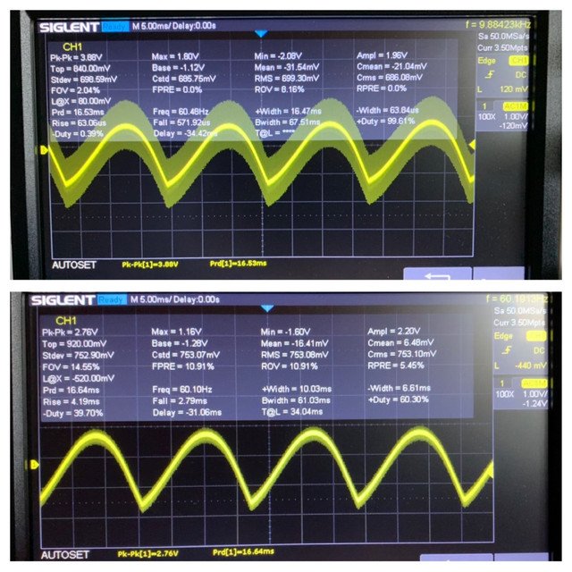

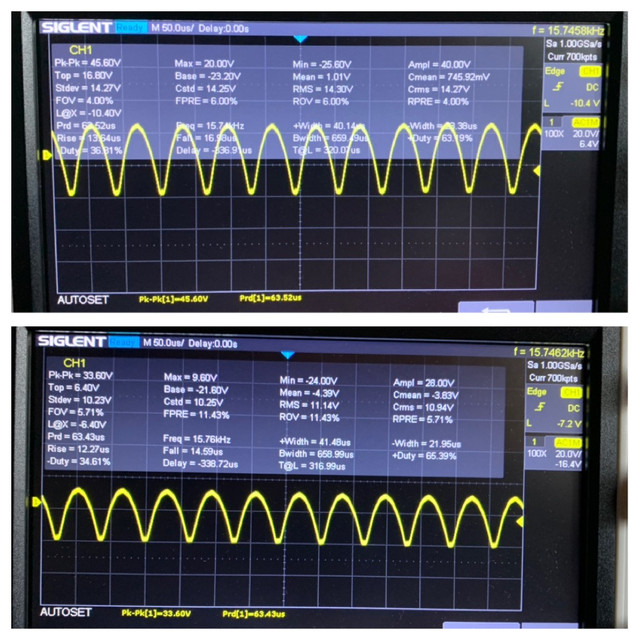

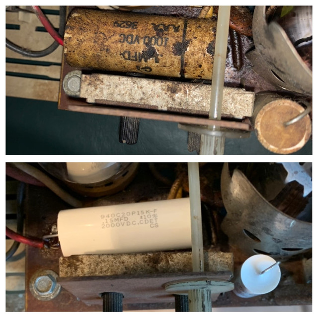

LukeSimon 08-15-2021 06:58 PM
I got around to replacing the white axial paper dielectric film capacitors that are known to explode. In the HC chassis, these are capacitors: C44, C67, and C105. However, in some HC chassis builds, such as my TV here, C44 is not a white axial capacitor, but instead is a much more reliable "orange drop" polyester dielectric film capacitor. Capacitors C67 and C105 are located in the back of the chassis on the left corner near the knob for horizontal hold. In order to try to match the "look" of the original white axial capacitors, I went with white axial Cornell Dubilier brand metallized polypropylene film capacitors.
https://i.ibb.co/x5s3VyJ/image0-17.jpg
Picture: top is before, bottom is after
Capacitor C67
This capacitor is a decoupling/filter capacitor for the 670V boosted B+ power supply. It has to be able to tolerate 15khz ripple, and it sits right next to the power amplifier tube for horizontal sweep, so it has to tolerate lots of heat! The original capacitor is a paper in oil dielectric, and the 15khz ripple and the intense heat from the power amplifier tube slowly boil the oil out of the capacitor. This causes the dielectric's voltage rating to decrease bit by bit until the capacitor fails with a 400 volt short circuit.
A proper replacement should have a self-healing dielectric material that has a higher temperature rating. Also, the capacitor should have a smaller diameter, as the original capacitor's 20mm diameter has the capacitor almost touching the power amplifier tube's glass! Every millimeter smaller the diameter, the less heat transfer from the nearby vacuum tube. A higher voltage rating will also prolong life. Film capacitors have a life expectancy that is exponential in the magnitude of voltage derating. Finally, a 50% increase in capacitance for this capacitor will make the capacitor more effective at reducing ripple voltage (see before vs after below), without resulting in excessive surge current during the initial charging of the capacitor.
Before vs After:
  • Dielectric Type: "paper in oil" vs "metallized polypropylene"
  • Capacitance: 0.11 mfd vs 0.15 mfd
  • ESR: 16 ohms vs 10 ohms
  • Voltage Rating: 1000 volts vs 2000 volts
  • Temperature Rating: 85 celsius vs 105 celsius
  • Diameter: 20 mm vs 17 mm
  • Oscope Voltage Ripple peak-to-peak: 45.6 volts vs 33.6 volts
  • New Part Number: Cornell Dubilier - CDE - 940C20P15K-F
https://i.ibb.co/jMmJh3N/image1-13.jpg
Picture: oscope of "Boosted B+ Voltage" top is before, bottom is after
Capacitor C105
This capacitor is a decoupling/filter capacitor for the B+ power supply. It is in parallel with capacitor C2, a 100 mfd electrolytic capacitor, but since the ESR of electrolytic capacitors is so high, they are only effective at reducing low frequency ripple such as rectified power outlet ripple of 60hz or 120hz. For TV and radio frequency ripple, a very low ESR capacitor is required. Increasing the capacitance by about 10x will more effectively reduce the high frequency ripple, and does not increase the surge current during power on to an unsafe level.
Before vs After:
  • Dielectric Type: "paper" vs "metallized polypropylene"
  • Capacitance: 0.046 mfd vs 0.56 mfd
  • ESR: 39 ohms vs 2 ohms
  • Voltage Rating: 400 volts vs 400 volts
  • Diameter: 14 mm vs 13 mm
  • Oscope Voltage Ripple peak-to-peak: 3.88 volts vs 2.76 volts
  • New Part Number: Cornell Dubilier - CDE - 930C4P56K-F
https://i.ibb.co/3fN2Vf6/image2-7.jpg
Picture: oscope of "B+ Voltage" top is before, bottom is after
