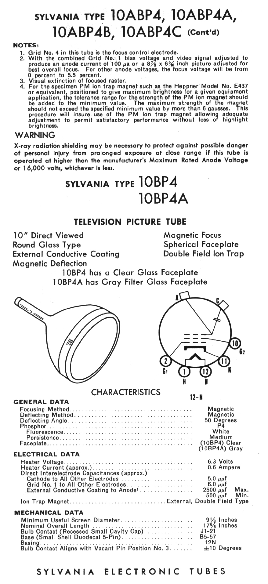

I never knew about the double-magnet ion trap. I have a 10BP4 for which I could never get the beam properly hitting the phosphors. Maybe I was indeed using an insufficient single-magnet beam bender. I still have that tube.
Are you keeping ALL those 30AXX's Bob? I always liked the projecting bevel design. :D
You definitely need a dual ion trap magnet to 10BP4s. Check out the data sheet - "Ion trap maget....External, Double Field Type'

Huh, How 'bout dat.. I don't recall such an ion trap being on any of the sets with an original 10BP4.. actually the Phillips had an ion trap 10BP4 and it worked well... I'll rummage through the boxes of TV junk I saved. Important information can slip by. .. I've always loved trains, especially the unique, yet it wasn't until just a couple of years ago that I even knew of the existence of the most interesting of all railroads, the Wuppertal Schwebebahn. So it goes... Another collection I have is literally 100's of TV knobs from the 1950s, dating from the time in the sixties that I was a teenage TV repairman.
